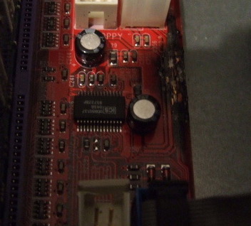

My version of the project has been put on hold due to my PC catching fire...

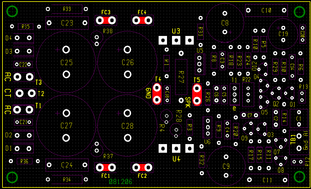

Here's the parts placement diagram for the board illustrated on page 16 (post #157) of this thread. You'll find the gerbers and bom on page 17. Hopefully it's clear enough to make out the labels. If not, let me know, I'll create a larger diagram and zip it.
Al
