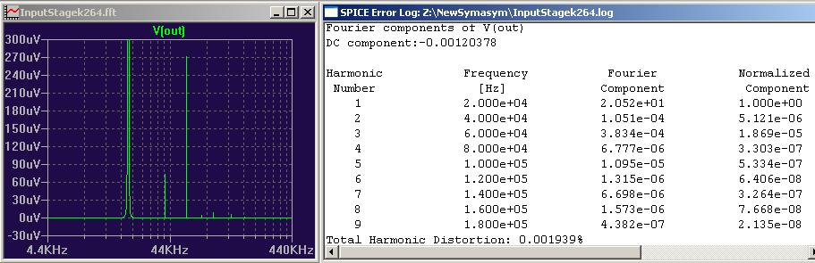

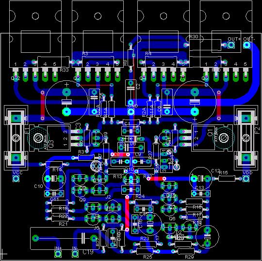

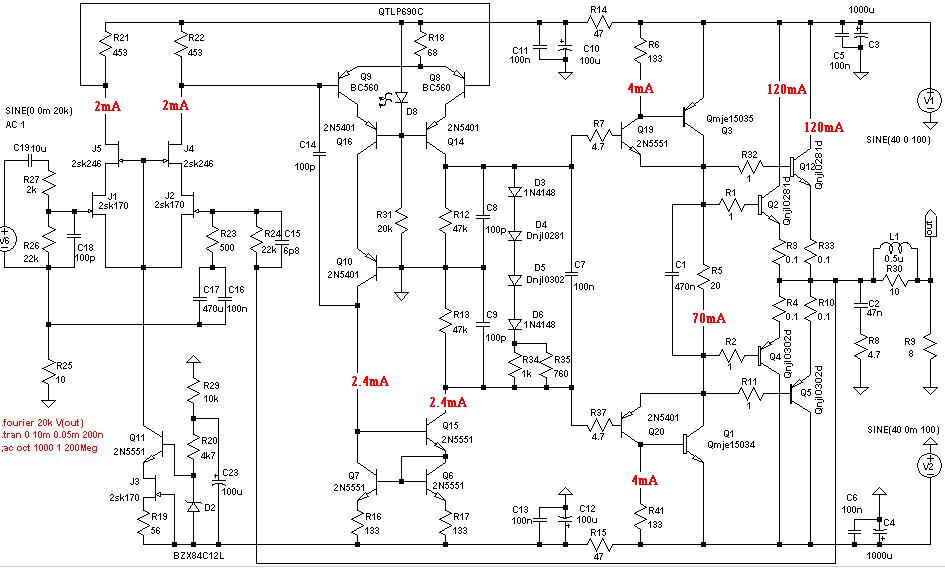

After countless hours of simulation and practical tests, I came to this version of power amplifier, inspired by symasym.
The main goal was crystal clear trebles, very good dumping factor - bass control and 4ohm stable in any output condition.
What do you think about output and thermal compensation stage, 2x1n4148 for CFP drivers plus 2xNJL diodes for power BJT's?

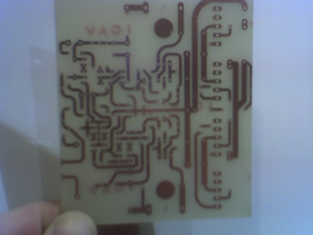

Roender, some advice for when you use EAGLE to print to Press-n-Peel.
It is far better to not have the holes etched out. To do this, type the command "SET DISPLAY_MODE NODRILL" into the EAGLE command line at the top of the editor window. You will see on screen that all the drill holes now become solid. To get back to normal, type "SET DISPLAY_MODE REAL"
Admittedly, drilling the holes becomes a bit more difficult 🙂 but you can activate layer 44 (Drills) and deactivate everything else except 20 (Dimension), print that out, and use it as a drill template.
Two reasons.
One is that the acid can etch under the pads. This can lead to the pads coming off when you heat them up to solder them. Admittedly, this is only likely if you leave it in the acid too long.
Two, and the more importan one, is that if you don't drill exactly where the hole is etched, you end up with a hole, and part of the pad with no copper on to attach to. If you leave the pad filled, then the hole is wherever you drill it, so if you're a bit off, it wont affect solderability.
