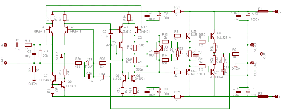

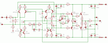

Here's the schematic from Mike's symasym site. To make things easier I labed all components on my board according to his schematic.

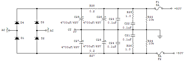

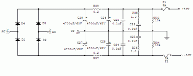

If you need the PS schematic let me know. I did post it on this thread somewhere.
http://www.lf-pro.net/mbittner/Sym5_Webpage/symasym5_3.html
Al

Ryssen,
You might want to check to make sure that everybody is in agreement to which board there going to get. There was some question whether to build mine, or Mike's version 5.3 which has been heavily tested.
If you go ahead and order my version, I'd like four boards.
