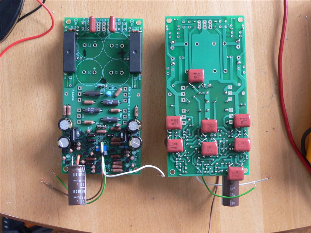

Since I am mounting one board opposite of the other board I of course connected Q17 (bias) transistor correct on the working board and backwards on the nonworking board. On the nonworking board the Emitter and Base are swapped with where they should be.
I fixed this and I still get the same issue which is a lot of DC and L5 only illuminating if the input is shorted (does not light if input not shorted). Did I blow anything nearby Q17 with my initial short full voltage test, if so which components are recommended to be replaced?
Or is there another undetected problem?
OK, I'm turning back to this soon. Any input? Q17 does not appear to be blown up, no terminals measure short circuit w/r to each other.

Testing
I'm using a variac.
I have external fuses.
The board fuses are installed.
I have advanced the variac to 50% power. L3 is not as bright as the other L4 & L5. Upon shut-down, it does glow longer than L4.
I measure dc offset of ~10 mV.
That's where I have stopped.
Looking ahead I must ask about attaching probes to Q22 & Q23 emitters.
As to the location for attachment, I'm scratching my head on this. May I get some direction?
Hi Ed,
For probing Q23 & Q24 refer to the pictures found in post #24. I would replace the fuses with the 100 resistors as described in the Testing Procedure section of the assembly instructions. Make sure though that the bias pot trimmer screw is turned counter-clockwise 25 full turns to ensure the amplifier’s output section is set to it’s minimum bias of about 0ma.
With the variac at 50% it's possible the VAS is not getting enough current resulting in a not so bright L3.
Al
OK, really
It takes more than a few turns to begin seeing bias. Enough so to provoke a feeling of anxiety with the thoughts: "Is something gonna show up? Is it working? Have I hooked it up right?"
So it goes.
The first channel is warmed up,losing bias with slowly increasing temperature. It is in the 55mV range. DC offset is 5mV.
Sweet
The heatsink is horizontal. Not like it will be in use. Close enough at this point to move on the the other channel.
Ed,
Great to hear the first amps is working. Good job! Good luck with the second.
If your heatsink warms up to much you can turn the voltage across Q22&23 down between 25-30mv without sacrificing performance.
Al
I found a happy place for the bias @ 35mV, but will test what happens when I go even lower. It seems that AAK has already measured THD at lower bias settings with no ill effect on THD.
The theoretical optimum in near 40mV, but not a whole lot happens when you go lower. 55mV is definitely too high.
