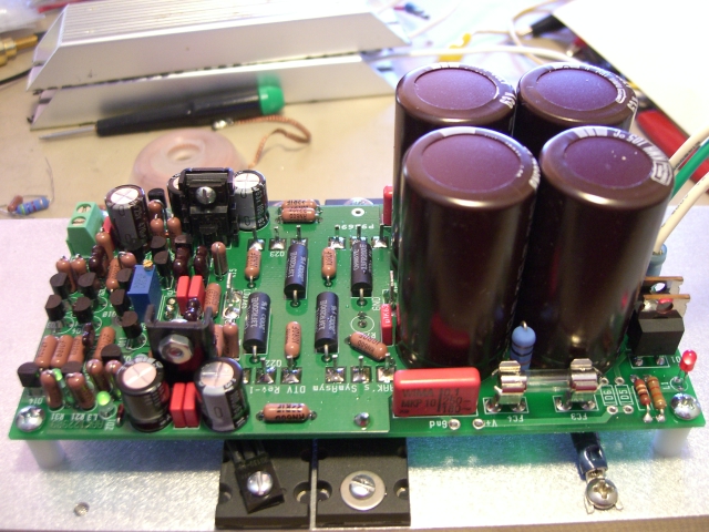

Welcome! This thread is for all those who bought my PCB based on Mike Bittner's SymAsym – "The Sequel” circuit design. Of course everybody is welcomed, and if you have something to add by all means feel free to jump in.

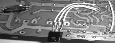

Attached is a pdf document with step-by-step instructions to help assemble my PCB. I'll provide transistor matching and testing instructions within the next couple days.
I've also attached a couple pictures that should help clarify number 8 and 9 of the Assembly Instruction section of the attached document.

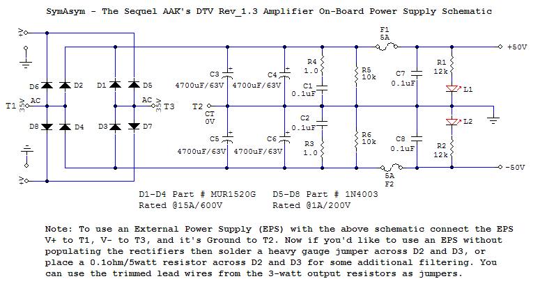

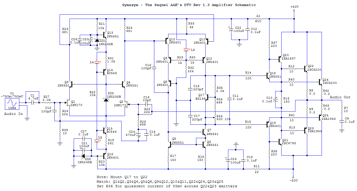

Here the latest amplifier and power supply schematics plus BOM.
Igreen, I provided information noted below the PS schematic that should answer your question about using an External PS.
For the BOM I added Mouser part number 505-M10.1/250/10 which is a MKP10which according to the data sheets is better suited for audio equipment.
Thanks Stanley for pointing it out the different types of Wima caps.
I also added 3/8" nylon standoffs to the BOM used to mount the board to the main heat sink.
Al

Hi Al,
Thanks for the updated schematics. I have not used any FETs before and I would like some advice on the JFET matching.
I only have a DMM and a single-channel handheld scope and a breadboard so I can only do basic device matching.
I found the following document from passdiy: http://www.passdiy.com/pdf/matching.pdf
The document mentioned: "Matching input MOSFETs is critical, because they must share equally the 10mA of bias current from the current source."
What is the normal bias current thru JFETs: Q1 & Q2?
To better match the following BJTs: Q5&Q6, Q9&Q12 and Q10&Q11, I would like to know their respective quiescent current.

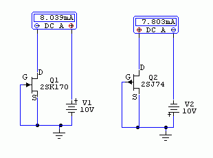

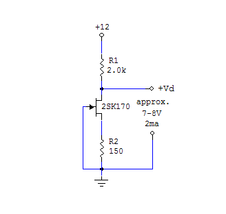

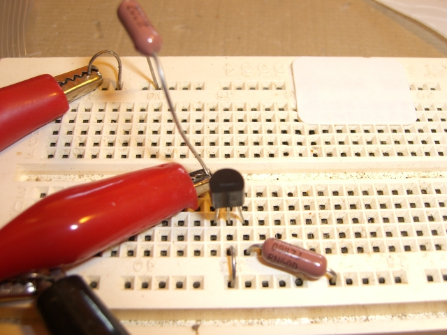

Hi Stanley,
Attached is the circuit that I used to match Jfets Q1&Q2. I also attached a picture of my setup using a bread board. It's a simple circuit and works well.
On the matching circuit I set Idss to approx. 2ma, which is close enough to the actual current on the amplifier which is approx. 1.6ma. Use a DVM to check Vd on each Jfet and pair up the ones that match the closest. With 10 Jfets I was able to match 2 pairs pretty much right on. Of course that may vary depending on the batch sent.
For Q5&Q6, Q9&Q12, and Q10&Q11 matching hFE is good enough. The bias current across each transistor is about 3.25ma.

You might try a setup with a CCS. Basically, connect G to ground, D to the the same positive voltage you find in your application, and S trough a CCS to a negative supply (-10V or so). The CCS can even be a simple JFET CCS set to half the tail current in the input differential. Once you conenct your DUT, measure the voltage between G and S with a high impedance voltmeter (regular DVM will do fine). Match for the same voltage. This method is quite accurate but requires a dual power supply (+V, -V) - you can also use it to pair small MOSFETs, just insert a 1k or so resistor in the gate line to prevent oscillations.
Andrew's method is more accurate for finding pairs because it takes thermal coupling into account, though.
It's not just the thermal coupling.
Testing/measuring as a pair allows Vgs to be equal, Vds to be equal (if Vdrop is equal), Id to be equal, Pq to be equal, Tj to be equal, Tc to be equal. All the things that are very difficult to control accurately are held equal. It's a real comparison of DUT and REF. When you find a pair, you know you have a pair.
Trying to find pairs or sets by measuring each individually leaves all the difficult to fix constants at haphazard values. There is no way to guarantee that the conditions for each single DUT are the same as any previous DUT, that day, that week, last year.
I have noticed that the device pair of DUT and REF can change if a door is opened and changes to cooling effect on one side that is different from the other side. No draughts is an important part of obtaining the equality during the testing.
I've been using the circuit in post #10 for years and works great. I found after doing some research that John Curl recommends a similar circuit for matching Jfets except he grounds the gate and source. I added a source resistor in order to drop Idss so that the jfets can be matched near their actual operating current.

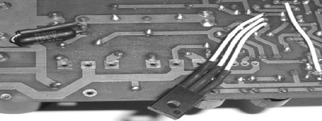

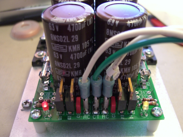

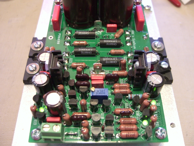

I've attached some pics of the new assembled board for reference.
Note the direction of Jfets Q1&Q2 is different that how it's labeled on the board. You'll find more information in my assembly instructions document found in Post #1.
