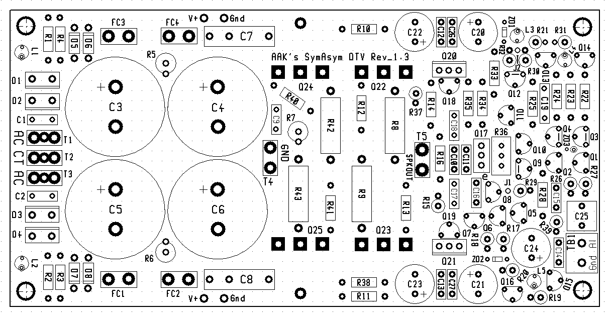

I updated the PCB with an extra pad for C7 and C8 with a 10mm spacing. I didn't think it would be such a problem.
Your idea would work fine, but be careful not to drill through the top side trace that connects to ground. The trace comes pretty close to where the drill hole would need to be for a 10mm spacing.

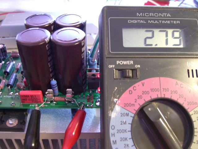

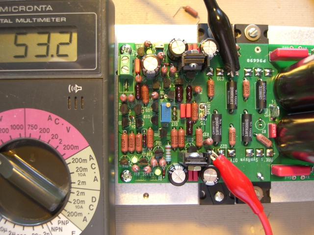

I've added testing procedures to the attached assembly instructions document found in post #1.
Remember if your using the 2SK170s for Q1&Q2 to insert them in the opposite direction then how it's labeled on the board. The flat side of Jfets Q1&Q2 should face inward towards the large PS caps.
I've added a couple pics that should help with the testing.

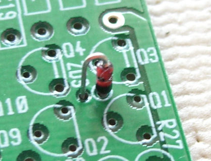

Here's a picture of zener diode Zd3 illustrating the correct orientation. For Zd1, and Zd2 follow the labeling on the board. For LEDs L1-L5 insert the longer of the two leads which is the anode into the pad with the circle labeled around it. Look at the parts placement diagram in post #27, you should clearly the see the circle labeled around the pad for L1-L5.
