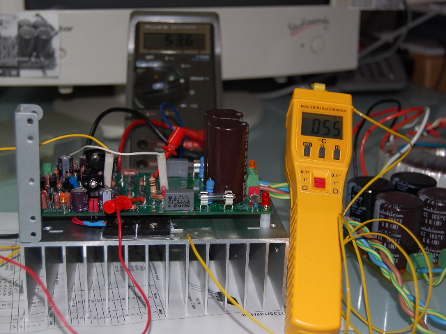

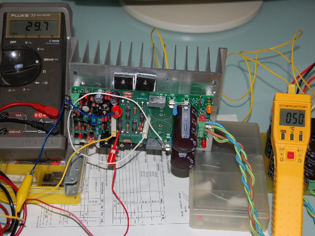

I adjusted the bias & the DC offset is around -2mV. The heatsink is running a bit hot at 55C (131F), ambient room temperature is 26C.
the heatsink is running ~29Cdegrees above ambient.
I think this is a bit high. The worst case Tc will be ~37Cdegrees above ambient.
What is your worst case room temperature?
What is the voltage across each of the output emitter resistors?
Heatsink temperature
Al & Andrew,
The heatsink is a bit small (6.5W x 4.2H x 2.0D inch) & I can extend it with aluminum plate.
I attached two photos, the first one is the having the heatsink in the bench position (the fins facing down) & the temp was 55C. The second one is the install position with a bit breathing space under the HS & the temperature was 50C. I lowered the bias current to 16mV across R8, the temp drop to 43C.
The OTs are not matched. I will build up the second channel with matched OTs before I replace the OTs on this channel.
Highest ambient temperature in Sydney can get to 40C and the room is not air-conditioned. I will not listen to music on these hot days.
Cheers, Stanley

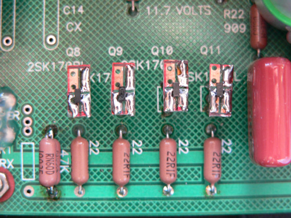

Hello Al,
After reading good things about the Bf862,
http://www.diyaudio.com/forums/pass-labs/146310-bf862-preamp.html
I tried to use them myself on a Pearl phono with good result, somewhat clearer than a
2sk170. Which is of course the mother of all lowpowerfet's 🙂
The Bf862 has a higher transconductance than the 2sk170, so not always exchangeable without modifications. I would like to try them but I'm to noobish to know if it can be done with the SymAsym.
Regards, Erik.
not really.
The BL is a 6 to 12mA device the 862 is 10 to 25mA device.
Look at the BL 12mA example of transconductance. You will see they show 30 to 40mS from 5mA to 10mA Id.
Choosing a very high BL, or a low V grade, will give a similar range of Yfs, if you run them at similar high Id.
I think the 862 would substitute for the 170BL in this amp.
You have to decide what Id to run them at and from there decide if the compensation needs to be altered.
