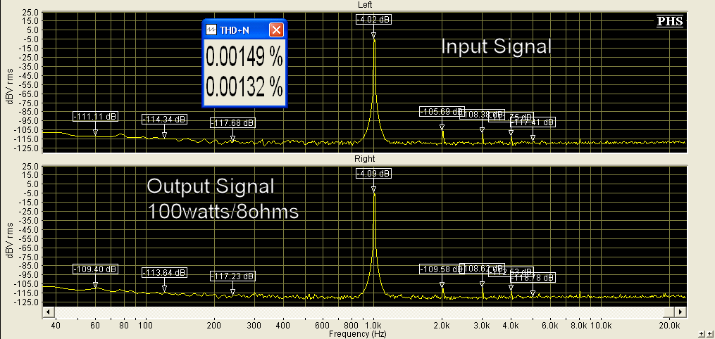

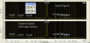

I got around to doing some THD testing on the new amps today, the results were pretty impressive. I did the testing with the rectifiers bypassed using my external power supply (EPS) to beef up the total PS capacitance to 18800uf per rail. First I did the testing at 100 watts into 8ohms, and then 200 watts into to 4 ohms. Without the EPS just using the on-board PS the amp did about 180watts into 4-ohms.
Whether it's into 8 or 4 ohms at full power the amp doesn't blink one bit. Like my other testing the 2nd harmonic is lower than the input, which explains why the overall THD is lower then the input signal. There is a small increase in the 3rd harmonic when driving 4-ohms at full power.
Here are the THD plots.
Al

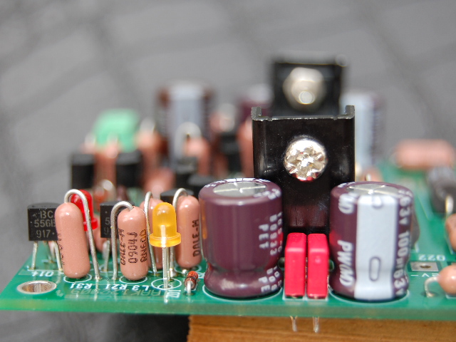

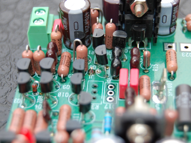

Build report
I have followed Al's assembly instructions & completed one channel. I will put my 2c:
The PCB is well-made & its layout is good & most pads are of generous sizes. However, there are no wasted space on the amplifier section, if you have not ordered the parts, order the recommended parts as detailed in the BOM.
Follow Al's advices on the soldering guns, I found that my favorite 42W Goot temperature-controlled soldering iron was not hot enough for the power components. I had to use a 80W soldering iron to reflow some joints.
Assembly instruction Step 8 - installing the J1 to J2 Jumper can be tricky. I installed the jumper before I installed R36 trimpot & L3 LED.
The pads for the zener diodes are quite small, you may need a super fine soldering iron tip.
I used the recommended Keystone Faston terminal, (mouser part no: 534-1213), the mating surface tarnished when I overheated them with my 80W iron.
- Stanley

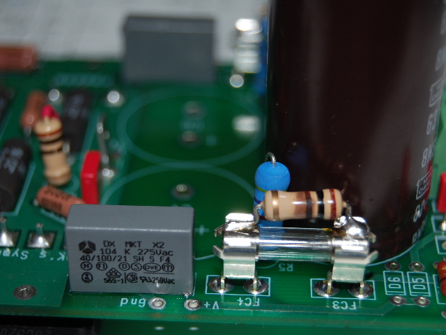

I powered on the SymAsym board today and the two current limiting 100R resistors smoked.
I double-checked & there was no DC short-circuit. I connected the volt meter to one supply rail & it was loaded down to around 3V, so one or more power devices were turned hard on.
When I build the ampflier, I used a hard copy of the latest BOM as a component guide & crossed them out after I installed the component.
I then checked schematics in post #4 and found that Q20 should be 2SA1837 & Q21 should be 2SC4793 and these does not agree with the latest BOM which states that Q20 is a 2SC4793.
I suspected that the schematics is correct.
There are no burned tracks. Attached is a photo of the slightly-smoked 100R resitor.
I also noticed that C7 & C8 still have the mouser part: 505-M10.1/250/10 & you mentioned that 505-M10.1/400/10 may be a better choice.
Best regards, Stanley
Hi Stanley,
Sorry about the mistake on the BOM. It is correct on the schematic.
From your pic I see the fuse is inserted in the fuse holder, it should not be there just the 100-ohm protection resistors. In the Testing section of Assembly Instruction I wrote not to insert the fuse just the resistor.
To debug first check the drivers and outputs for continuity, basically checking between the base, emitter, and collector for shorts. If there's a short you'll have to replace the part. If you find no shorts then swap the drivers, and without the fuses inserted solder a new set of 100-ohm resistors and try it again to see what happens.
Try that and get back to me.

Thanks Al,
There are no shorts in the drivers or OTs, I will swap the drivers to see how it goes.
I soldered the 100R onto the blown fuse so that I can easily remove & reuse them. The setup also works for working 1A fuses as the fuses will go first, then the current-limiting resistors will smoke.
