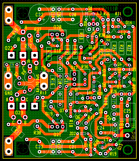

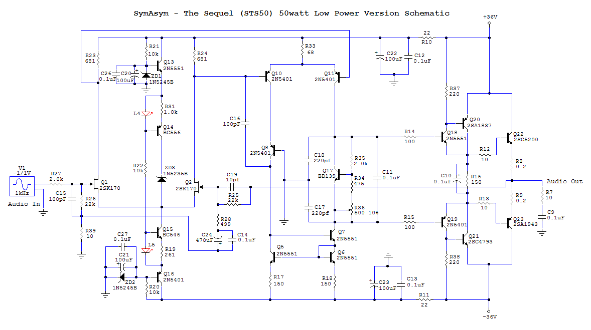

Hi All
I just finished a low power version of my DTV Rev_1.3 PCB with the same amplifier circuit but with only a single OT pair and no on-board PS. The PCB measures only 2.5" (63.5mm) x 2.95"(75mm) which is perfect for a home theater amp using an external PS. The PCB provides provisions in the OT section to accept Lateral Mosfets for an all input/output fet operation.
Attached is a picture of the PCB and schematic. Since this is a low power version I dropped the rails to +/-36V and bypassed the differential/VAS cascodes. From my testing bypassing the VAS cascode increases 2HD resulting in a softer sweeter sounding amplifier.

Hi Aidan,
Refer to post #36 regarding the LEDs.
I think they'll do but you may have to adjust R19. Initially leave R19 at 261 ohms and check the current across R23/R24. If the current is to high than increase R19 until you get it down between 1.65ma to 1.75ma.

Hi Al,
I'm using a single output transistor for now on my amp with the supply rail voltage of +/-36Vdc. What would you recomend for the emitter bias voltage? Is it 25mv? On dual output transistor it's 55mv based on your contruction manual. Let me know.
Thanks,
Fred
