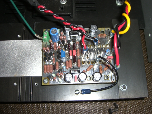

This photo shows one channel on heatsink being biased. Settings were reduced after this was taken.

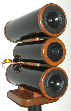

I've been working on a new speaker design using PVC pipe for a while now and I finally completed it this weekend. It looks really nice and sounds incredible. I'm still waiting for some crossover parts to tidy things up. I've been currently testing it with passive filters seen in the pic but I’d also like to test it with active filters. If I decide to go with the passive filters instead of actives they'll go inside the tweeter compartment.

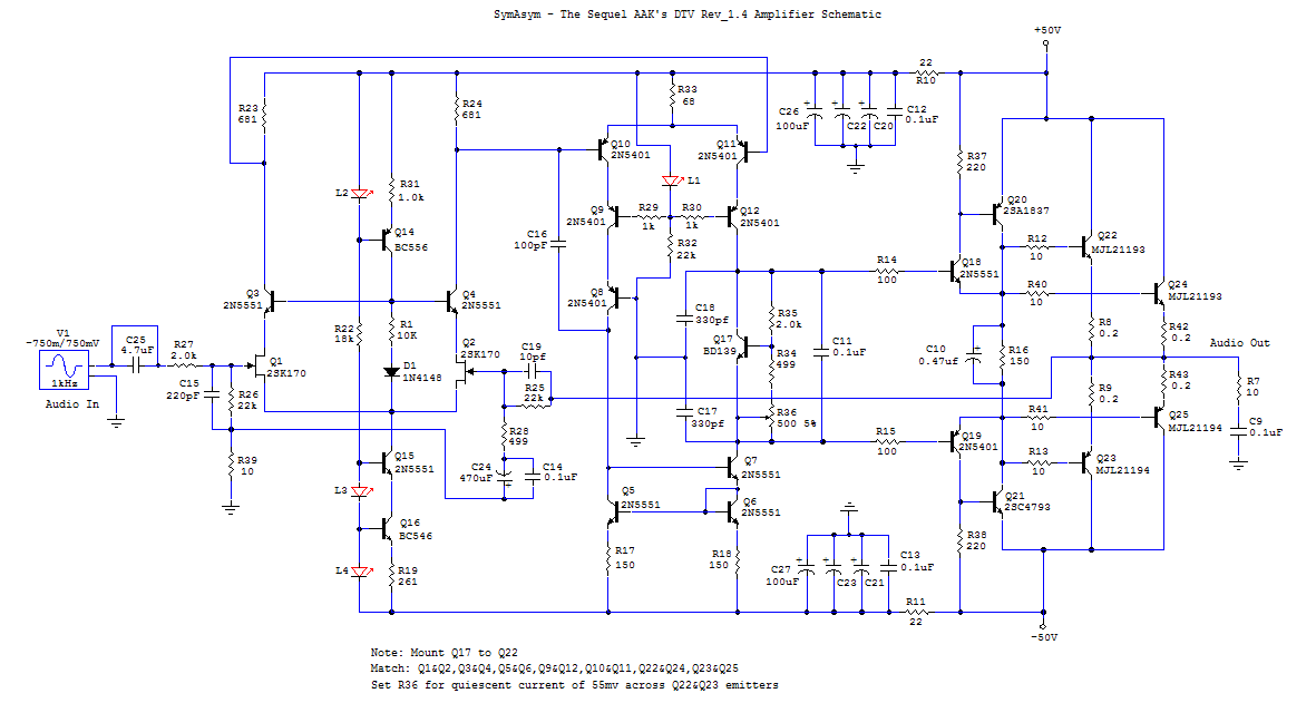

In order to test my speaker design using active filters I decided to remove the PS from my DTV Rev_1.3 amplifier so that I can fit four amplifiers on the heatsinks and enclosure that I'm using. While making the modes I added a new bias circuit (similar to Roender's latest design) to the input differential that drops the part count from 18 components to 11 without affecting the sound quality. I also moved the OT's so they now mount underneath the board allowing for 3" heatsink instead of 4". The board measures 2.87" x 3.5".
For the active filter test I'll run the amps using +/-36V rails. For the mid/bass drivers I'll bypass cascode Q3&Q4 while using all four output transistors. For the tweeter I'll bypass Q3&Q4 and most likely Q9&Q10 to increase the even order harmonics for a sweeter warmer sound, and use a single pair for the outputs.
I've attached the new amplifier schematic, a pic of the built and tested amplifier prototype, and a pic of my new speaker.
