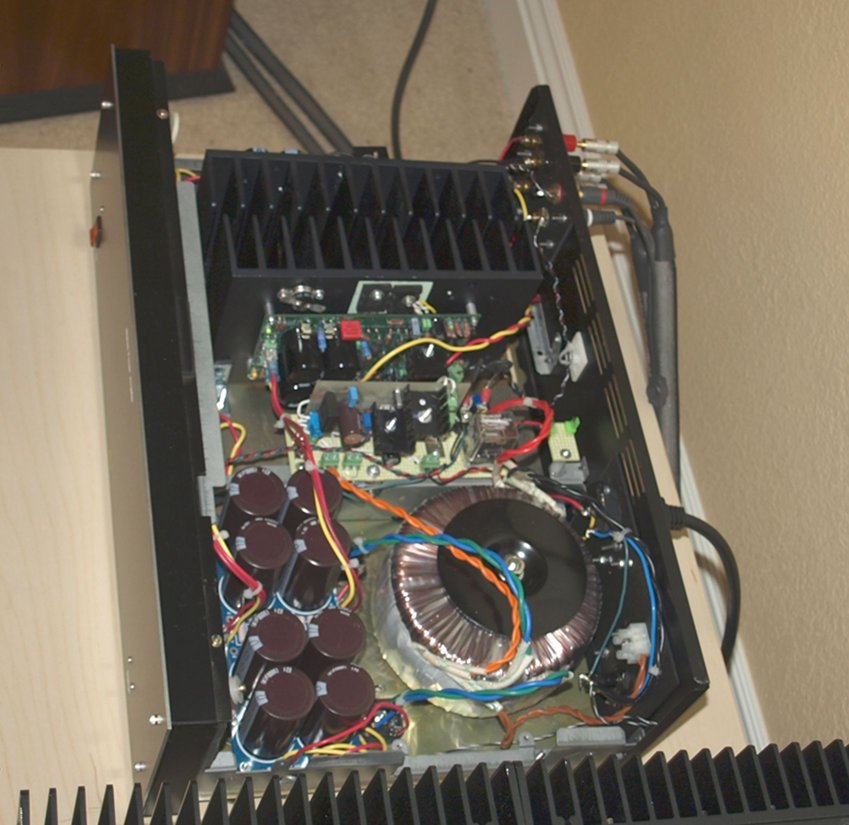

Not working, would appreciate some debug advice.
As in - where to probe and what voltage it is, I've got a variac so can bring it up slowly. Yes I know that I can measure the working channel but to prevent shooting in the dark what are the key voltage points to measure and what should they be?
issue-
Since I am mounting one board opposite of the other board I of course connected Q17 (bias) transistor correct on the working board and backwards on the nonworking board. On the nonworking board the Emitter and Base are swapped with where they should be.
I fixed this and I still get the same issue which is a lot of DC and L5 only illuminating if the input is shorted (does not light if input not shorted). Did I blow anything nearby Q17 with my initial short full voltage test, if so which components are recommended to be replaced?
I looked at the hires photos today and compared both boards, everthing appears to be installed correctly. EDIT- and Q17 does not measure short circuit between any terminals so appears to still be ok?
Hi Igreen,
To start check all the DC PS voltages including the voltage at the base of Q13 and Q16. You should get about 15 volts indicating that ZD1/ZD2 are Ok. After that check the currents listed below against your amp to see how they compare. List the values and will go from there.
R10,R11 -> 21ma
R23,R24 -> 1.7ma
R31 -> 1.0ma
R21 -> 3.6ma
R22 -> 2.5ma
R19 -> 4.5ma
R33 -> 8.5ma
R32 -> 2.3ma
R16 -> 8.5ma
R37,R38 -> 2.5ma
Since L5 lights up with the input shorted it's possible that Q1/Q2 could be damaged. You might want to replace them to see what happens. Make sure R39 measures 10ohms.

Thank you Al. Due to these nifty tips I found the error, a pin on Q14 with a flaky solder joint. Now channel 2 is up and running with channel1, In fact its together and playing music in my old Pass F5 case using the Pass power supply. I've added a softstart and fan/ temp sense circ.
I have 4-5 mV on Ch1 and 45 mV on channel 2 of DC offset. No audible hum or hiss. Heatsink not grounded...may do that later.
See attached pic.
