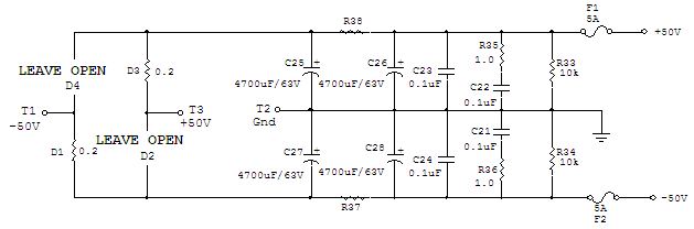

Hi Al,
just realized the diagram you gave for connection of a PS if not using the onboard diodes
Post 31
shows the wrong polarity. The description you give in the text is correct, but the schematic has the wrong polarity for connection of outboard unregulated DC. Just FWIW in case someone uses post 31 without checking!
A wrong connection here would be very dangerous (immediate explosion of large caps).

Thanks MBK for pointing it out. I don't know how I missed that one, but boy am I glad you did. Many thanks!
Can the moderators please replace the diagram in post #31 with this one.

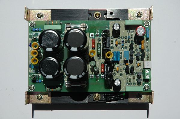

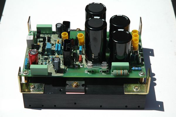

Full aerial. One trouble I had was that the TO-220 heat sinks for the drivers leave too little clearance to adjacent parts and to the connectors. All else went failry OK. Now I have to unmount my existing transformers from my main system for a first test. Unfortunately I have no scope so I'll have to fly blind w.r.t. oscillations, except if they're so massive that the Zobel is melting...
Beautifully neat!
Excellent work MBK. And good taste in heatsinks I must say.
I need to find sinks for the drivers too. Tight fit there.
Are those Rubycons power decoupling and Cerafine for feedback?

Well, I did fire it up today but while it didn't blow entirely, I do get too much bias. Depending on the setting of R22 I can vary it between , ahem, 1.5A and 2.5 A only, obviously there is at least an order of magnitude of a problem here.
The rails drop to ca. 33V at this bias btw, from 38V or so which they're supposed to be. No DC offset at the output (2.3 mV actually) so I suppose no active devices near the output blew outright / mounted wrong. Also, the values around T1 seem to be correct. Suppose I'm, up for a long session of bug fixing...
Any ideas for first candidates of what may be wrong?

Aw ne'rmind. Looks like I switched base for emitter in T1, obviously T1 because it's the only one where I'd actually needed a brain to mount it. I only spent about 10 minutes triple checking that I had the pin order down correctly when I stuffed the board. 🙄

I used your BOM with small variations 😉 . For instance re: bias network, for R22 I used 200 Ohms to get a wider range of bias settings. I bought almost all Digikey items as of your BOM from there, but didn't want to shell out another $30 shipping for Mouser, so I got the Mouser stuff locally from RS, as far as I could with similar specs.
I measured bias by taking VDC over R27 or R28 and calculating. It really was that high, the heatsink got all toasty within seconds. I never left it on for more than a few seconds actually.
Now I fixed T1's connections (actually replaced T1 with a new BD139). Now the bias is at 25 mA (5 mV across R27), which seems to be the highest bias I can get. Heatsinks barely warm at all after 10 minutes. What bugs me now is the DC offset (across a 6 Ohm dummy load, with shorted inputs): it is low, but wanders between 0.2 and 2.5 mV in a ca. 2 sec. rhythm. As far as I can tell though the Zobel is not getting warm. I used Mike's recommended R//L filter as well (soldered inline speaker cable at the connector's , board side) and this one too is not getting warm. Vcc now steady at +-37.8V.
