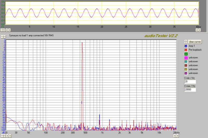

I finished my second channel. THis time DC offset is ca. 9 mV. AC noise is unmeasurable, and can not be heard on a typical 87 dB efficient driver. Picture of noise and HD spectrum at 440 Hz, 16V RMS into no load, is attached, with comparison to the loopback values of my USB mobile pre that I use for measurement. Excellent figures I'd say.
I also drove those 16 V RMS into a 6 Ohms dummy load (ca. -3 dB of full power, or 40 W) for a power test, this gets the heatsink uncomfortably warm, I presume with that output there is about equal dissipation on the amp side and this heatsink is I believe about 1.4 C/W so no surprise here.
Unfortunately I could not yet measure distortion under load. The modile pre / laptop combo has massive ground loops if plugged into power, for once (it is earthed and so is the amp psu). But even running the laptop on batteries, as soon as I attempt to measure voltage across the dummy load I burn a PCB fuse, instantly. There must be the mother of all ground loops forming, between what is in effect the power ground, looping to the preamp input and from there right back to the pre output that delivers the signal, with positive feedback.
I actually built a -32 dB voltage divider probe to measure power output, this may or may not be the issue, because this same connection works fine with no load. But as soon as there is a load on the amp (and thus a power current sensed by the probe going to the pre), the fuse blows. I tried all combinations, after 3 fuses I think I'll have to build a differential probe since the pre has balanced inputs anyway (which I had grounded by using a 2 pole phono plug as input for the voltage divider probe). Or maybe just leave the probe greound disconnected altogether, I forgot to try that...

I am having a terrible time trying to establish a basic clean bill of health for mine in the meanwhile... All I want is basic THD under load and some assurance of no oscillation... But... No scope, so I can only do soundcard based HD measurements, and I suspect my outboard pre/soundcard (M-Audio mobile pre) is having a creeping short, because I get odd and inconsistent readings whenever I try to measure output with a load while sending a signal from the same soundcard. I don't blow fuses anymore on the amp, but there does seem to be a level dependent bleed through between inputs and outputs - RTA shows a soundcard input signal whenever there is a soundcard output signal, even when the soundcard input is open or shorted... and signs of severe clipping even on the loopback signal at levels way below full out or input. Ah well, just ranting, I'll have to debug this and it's a pain.

No luck here... to double check whether it's the soundcard or the amp after all I used my desktop soundcard. This time I got consistent readings but oddly high HD, highest was 3rd at 0.15% (0.1W) to 0.38% (10W), plus a lot of PSU noise of course. The loopback measurement was clean though. Well, I thought I try no load again, which at first gave me the beautiful reading a few posts above. My voltage divider was soldered to the load so I turned down the output to 0.7V and connected the soundcard input directly to the speaker leads with no load. Of course I turned it off first. And on again with no signal. But. There *is* a slight turn on thump, maybe 2, 3 V on the DMM.
And that fried the PC. Not just the soundcard input, that would have been too easy, it did an instant protective shutdown and that was that. I've done these measurements dozens of times these past days, but always on the laptop with the USB breakout box and no ill effects. I conclude that M-Audio did something right after all (overload protection haha).
So. I will wait and ponder for a while now, at least as long as the PC is in the shop. I don't have the guts right now to try and fry the laptop too.
In any case... opinions on that high 3rd harmonic and following spray of harmonics? Could it possibly be shaky contacts to the probe (using crocodile clips to connect to the power resistor's terminal that serves as load)? I figure a faulty active device would rather produce even order harmonics? Amp runs cool with no or low input and I found no solder bridges.
