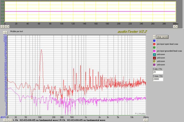

Hi Chris, Al,
thanks for the ample input. So I started experimenting.
The soundcard definitely does something. To specify what I am doing: the best way I found connecting it is, soundcard unbalanced out to amp, and probe lead to a 4.7k / 120R voltage divider across a 6R power resistor load, for -32 dB attenuation. I only connect the signal probe lead, and it goes to one lead of a balanced input on the soundcard. The Mobile Pre I am using unfortunately does not have an unbalanced line input, except for a microphone input. Using this one creates the worst RTA picture, with plenty of noise even without signal, the mic pre must not be very good and is too sensitive anyway. The other lead is "grounded" which is actually not true, because the sleeve of the balanced phono jack inout of the soundcard is actually *not* grounded, and connecting probe ground to it leads to immediat demise of the amp's 5A fuse. In any case, connecting the amp this way gets me a reasonable noise picture if no signal is applied.
Soundcard is USB powered by a laptop on batteries, so the earth should not cause a ground loop. If i power the laptop by line cord, then yes, it's absolutely awful.
So the results so far:
- amp input open, shorted, with open lead, powered off preamp with or without probe, all do nothing to the bias (about 75 mA).
- amp input connected to powered-on soundcard , no signal: bias (DC, via DMM) shoots up to 0.5 A. Connecting the probe lead as well and the bias increases another 50 mA.

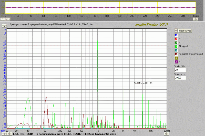

Experiments so far:
- input goes 4 windings through a ferrite bead for added input filtering: no effect whatsoever. Might be too little though.
- adding 10p to the 3.3p C14 by tack soldering a cap: interestingly, bias must be readjusted quite a bit (it went down 50% for the same previous r24 setting). With the added cap, connecting the preamp now does nothing to the bias, it is now stable whatever I do. But when applying signal, the spray of all-odd harmonics is still there (see pic for 4V rms output into 6 Ohms). I checked loopback on the soundcard and it can easily take this input voltage w/o distortions, since it is receiving it via the -32 dB divider.
What's strange is that I am getting all odd harmonics. Which one of the symmetrical stages is saturated? ...
I guess the next easiest thing will be to double up the driver base stoppers with 30R to give 100R//30R = ca 23R, as in Mike's BOM, that's easier than pulling the output base stoppers to increase their value to Al's 10R.

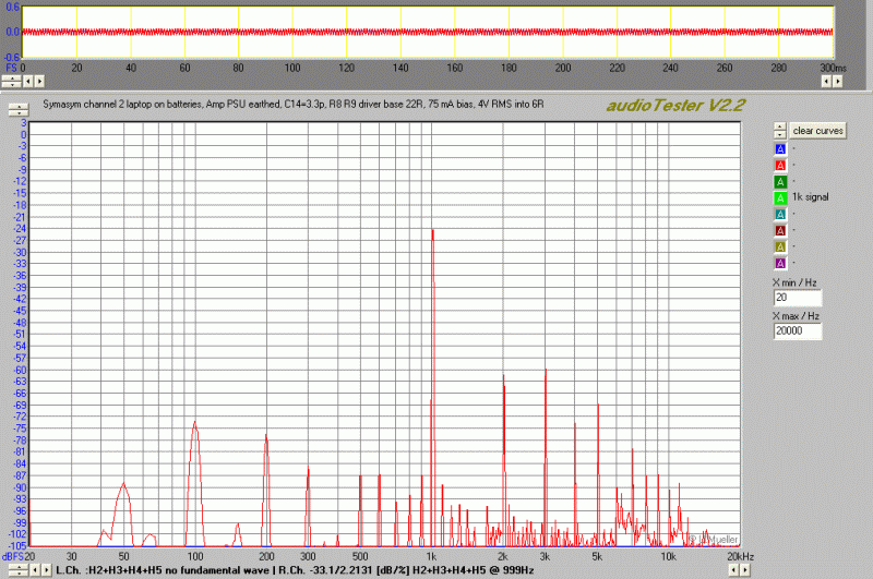

Aw-kay... Next mod: driver base stoppers = 22R, C14 is back to 3.3p not to mix up the mods. Now all base resistors are as in Mike's BOM.
Result: connecting the soundcard now does not upset the bias anymore, same effect that I had when modifying C14. But the distortion spectrum worsened to 1.5% at 4V RMS, and now, for a first, we also have very high even order distortion, the works!
I also noticed (can be seen on the graph) that using the touchpad on the laptop results in broadband noise bursts in the 5-12k area, some remnants can be seen on the graph. Sigh.
I am more and more clueless. Maybe it is the soundcard, but when I tried double checking with the desktop I fried it. Before it went I had a chance to see the distortion spectrum and it was just the same as on the USB laptop card.
