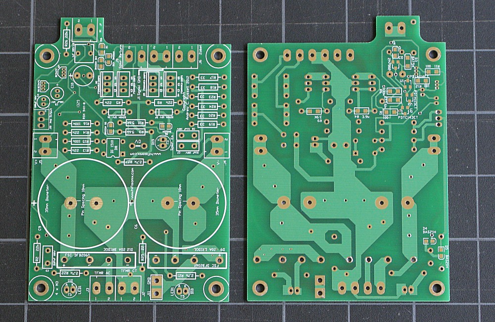

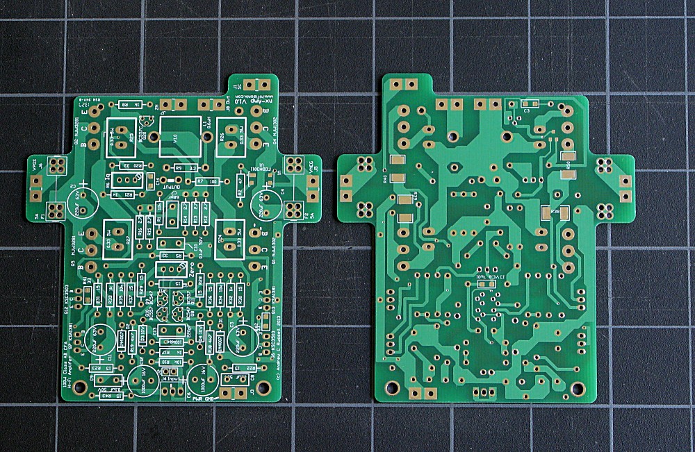

nx-Amp and nx-Amp PSU pcb pics
Better pics of both boards are attached below. Bonsai should be complimented on the clean layout. (fortunately for those of you interested in the boards, I had nothing to do with that part... :D)
The color is a bit off, note that the pads are the standard leaded tin, the yellow hue does not mean gold plated.
The boards are double sided, solder mask and silk screen on top and bottom, through-hole & SMD components, SMD pads top and bottom.

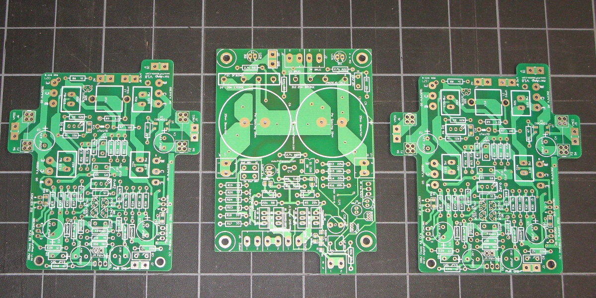

PCB Status
The documentation for the nx-Amplifier is available from Bonsai's web site in a PDF document, including BOM and build instructions, here:
The Ovation nx-Amplifier V2.0
A full set of boards as shipped is shown below. Circuit boards are professionally made, double-sided, solder mask and silkscreen top and bottom side, plated through holes. They are made from Gerber plots provided by Bonsai, the OP of this thread.
nx-Amp PCB
$10/board, $20/stereo set, + shipping cost + paypal fee (if applicable)
