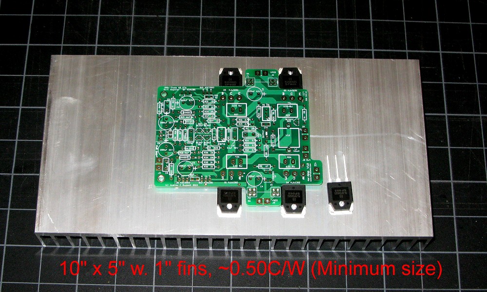

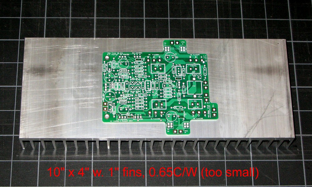

Looks like the heatsink required for one nx-Amp board will be a minimum of 5-inches tall, assuming a common-type heatsink w. vertical fins. The holes for the power transistors are fairly close to the edge of the board, and the leads on the transistors cannot be bent too close to the body of the part. So, the minimum space required is about 6 mm on either side, meaning beyond the outer edge of the circuit board.
Yes, the transistors do jut out beyond the edge of th PCB. Note also that the PCB edge must rest on the output transistor cases - they act as spacers.
You can also rotate the PCB on your heatsink if that gives you a better fit.
Check out the construction details In the write - up.
Good luck -I am really looking forward to seeing these amps built by you guys up and running and your listening impressions.
Yes, perhaps better heat transfer to the heatsink that way from the power transistors. I will try that too, but in general I prefer the input connector to be close to the back of the chassis, with a short cable. Either way, five inches tall, or even six if one does not mind some empty space inside.You can also rotate the PCB on your heatsink if that gives you a better fit...

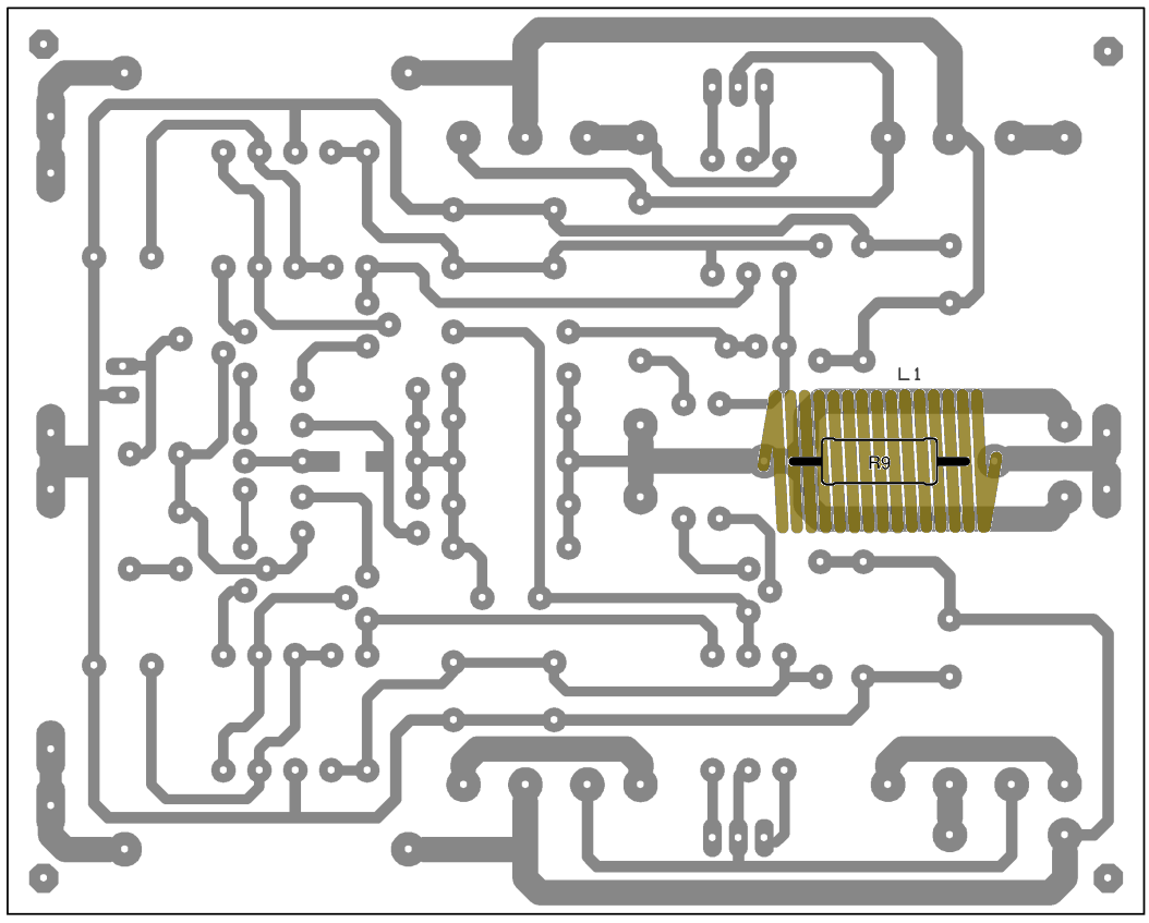

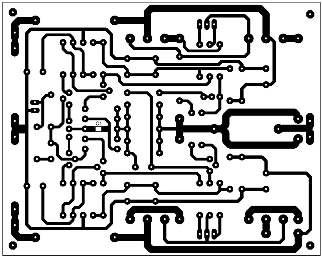

SX Amp (single-sided PCB)
Hello all!
I fully intend to make this amplifier in the SX version, but in its entirety.
I have designed a single-sided pcb that n is not yet checked a hundred percent but I post my work anyway.
When everything is ok (I hope), I'll post the file. Pdf with the consent of the author.
Regards!
Hello all!
Regards!
