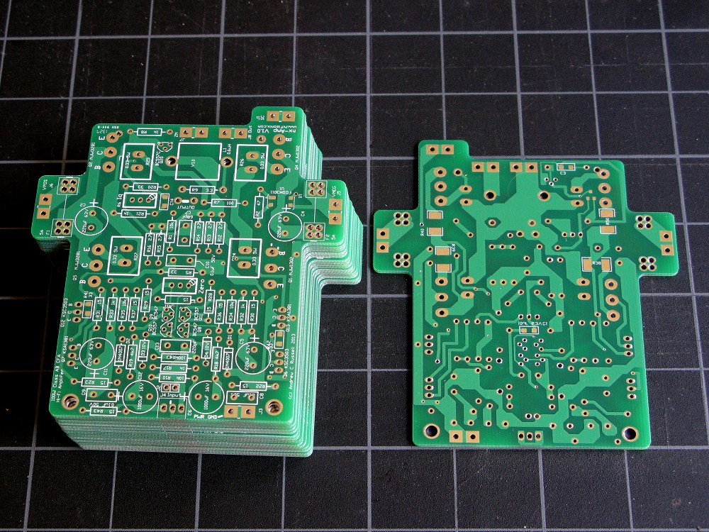

nx-Amp boards, fresh from the board house:
Might be a good idea to put this out there for other people in some detail, including some discussion of what the VAS current should be, or how it should be adjusted to stay in the linear region of the transistor, etc.
I doubt the average person who builds these boards will think of it himself.
Yes - good idea, I will add this to the write up when I update it.
... gold plated I see!
No, sorry, that is just the light. No gold for free this time, although the initial through-hole VSSA batch did come gold plated at no extra charge. That was sweet.
Other than that, the quality is pretty nice, I think we are benefiting from a discount that really was not intended for diy projects.... 😉
