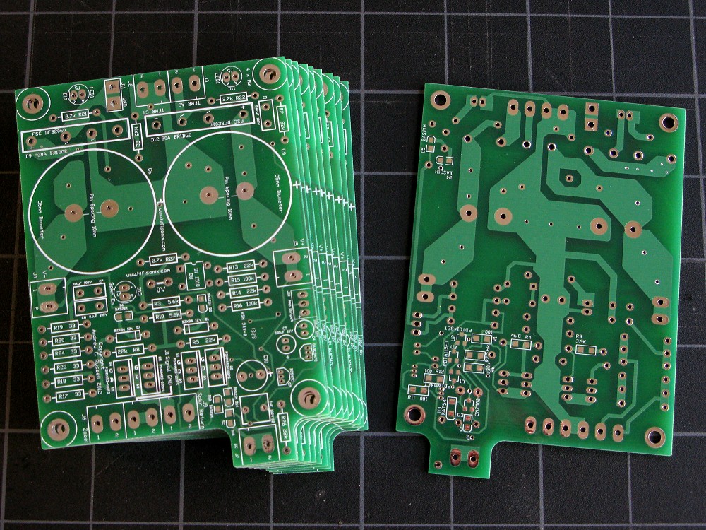

nx-Amp PSU
Power supply boards have arrived... :)
I will post better pics of both boards, amp and psu top and bottom side tomorrow, in case there are any questions about component placement, dimensions, etc.

Looks good! When will you start building?
About a week from now, middle of next week. I want to do a little more testing on my version of MrEvil's capacitance multiplier power supply.
I think I also need to buy or build some kind of better volume control/buffer if I am going to do any kind of objective listening comparisons. Which reminds me - is the input impedance specified somewhere?

Pete,
Can you check the size of output transistors holes, if they can accept wider pins from TO264 tranies, max pin width 1,45mm, so that other output transistors can be used?
Pete,
I have not actually checked the drill file for hole diameter, but I did try On Semi MJL4302/4281, and the pins fit fine. The samples I have on hand are about 1.22-1.25 mm actual width (measured).
