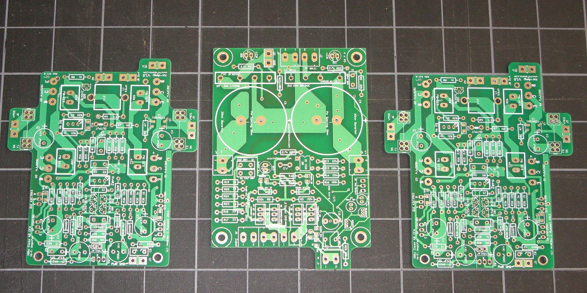

The documentation for the nx-Amplifier is available from Bonsai's web site in a PDF document, including BOM and build instructions, here:
The Ovation nx-Amplifier V2.0
A full set of boards as shipped is shown below. Circuit boards are professionally made, double-sided, solder mask and silkscreen top and bottom side, plated through holes. They are made from Gerber plots provided by Bonsai, the OP of this thread.
nx-Amp PCB
$10 each, $20/stereo set. plus shipping and Paypal fee

I expect the remaining boards to arrive approximately 8/14, and I plan to send out pm's with the exact shipping costs by that time. After that, boards will ship as payment is received. I know some of you have vacations under way or soon to start. There is no deadline ;)
Please review the BOM in the pdf document, and make sure you can source the required components, or suggested alternatives. I will try to supply anything that is easier to get in the US within reason, but this will mean that your boards may be delayed while I am waiting for parts.
