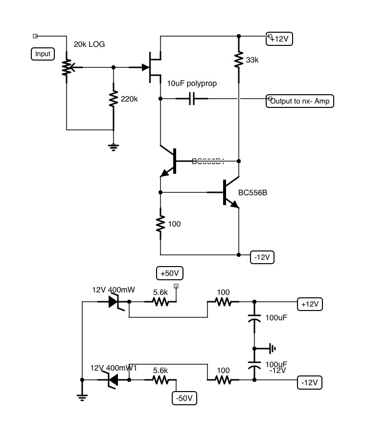

Here is a simple buffer circuit idea. You can use a BF244B or similar JFET. The Idss needs to be 10 mA or thereabouts. When I am back from vacation I will sim it - any volunteers for a PCB? Suggest an Alps RK27 pot or similar - a 24 step selector would b better, but they are not cheap ( Goldpoint start at about $150 I believe for a stereo attenuator).
Buffer should have PSU onboard and volume pot onboard so that mounting requires only one hole on the front. Volume pot should keep pcb. If small enough this pcb could fit in any power amp chassis. PSU can have have some form of voltage dropping (preregulation) onboard so that power amp transformer can be used for buffer too. I think that opamp solution would be more than OK for this purpose. Such pcb could be universal and used in almost any power amp, not only nx.
There is many j-fet discrete buffers already so I think that opamp based one would be welcome addition.
Agree. You could just tap off the main supply screw terminals. I have just posted an idea up.
You are very fast Andrew! Oh wait... I think you've done this before...Here is a simple buffer circuit.

Re the buffer for the sx and nx: I just checked on Mouser. BF244 is being discontinued.
However, J111 (Idss 20mA minimum) is available and they have 47000 in stock. So this is the best choice.
You can also replace the 2 transistor current source with a single JFET as long as the current source JFET IDss falls well below the buffer FET Idss. So I would use the J111 for the buffer, and a J113 for the current source. Makes for a simpler design. I'll try to post up something a bit later.
this turns it into a copy of the B1 topology..............You can also replace the 2 transistor current source with a single JFET
This makes it different from the B1 and DCB1 where the Idss of the upper and lower devices match. i.e. the buffering jFET is biased to 100% of Idss.as long as the current source JFET IDss falls well below the buffer FET Idss. So I would use the J111 for the buffer, and a J113 for the current source. ....

Could small Mosfet be used instead of j-fet as buffer with two transistor CCS circuit in the post #181? Is there any mosfet buffer at all?
I have not tried this with a MOSFET. You would need to use one with a low Vgs threshold and input capacitance could be an issue. I will try to sim this when I get back home. I suspect noise will be worse than a JFET.

Yes you could reg it with ripple eaters. The RC network off the zeners gives very good noise and ripple rejection though ...
