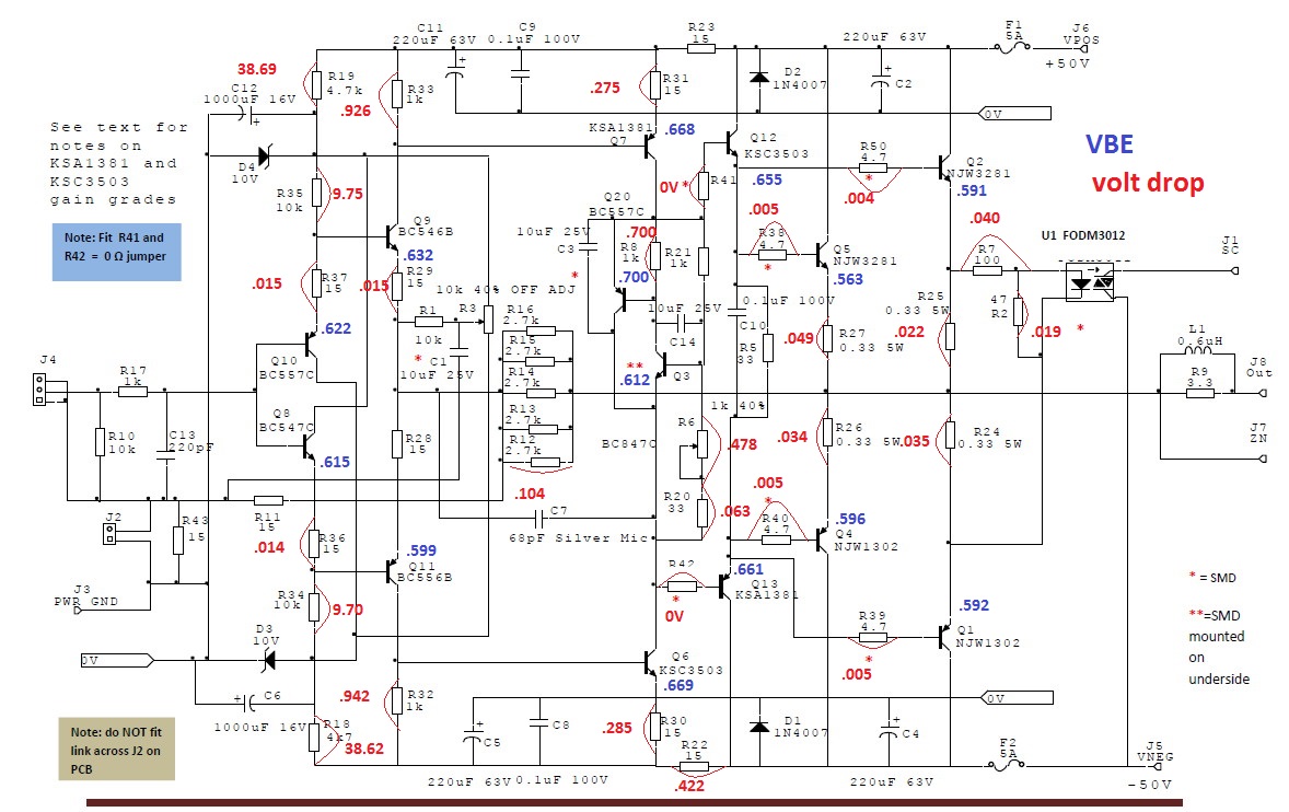

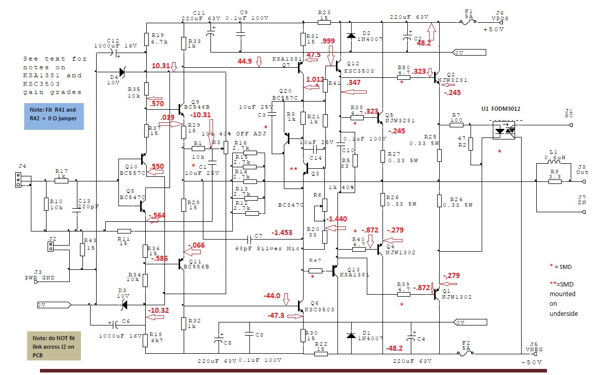

OK, I sat down and measured everything. I marked up two schematics. One with VBE and resistor drops. The other has voltages compared to ground. I can see that the voltage at the base of the NPN outputs is low so I replaced Q12 again with no change. Hopefully one of these two schematics will help.
Thanks, Terry

Terry, on the LHS what is the output voltage? Are these readings with or without the offset dialed out?
I'm sorry, I don't know what LHS is. These measurements were taken with the offset as low as it will go. The pot is full counter clockwise.
Left hand side
Can you measure the junction of R1 and C1 and see that you can adjust it from +10V to -10 V.

There was one thing that I noticed and forgot to note on the schematic is that the voltage at the junction of R1 and R3 is -10.32V. If I adjust R3, the voltage will move toward zero but the offset becomes more negative. I'm not sure if that matters but it is something that didn't seem right to me.

This does not seem right. If you measure at the junction of R3 and R1 you should get smooth adjustment from -10 V all the way to + 10 V. The amplifier output offset adjustment range should be about +-0.5 V IIRC. Can you recheck the voltage at the junction of R1and R3 and that you get the full -10 to +10 adjustment range?

OK I just checked. If I adjust R3 until I read +10.3 at R1, the offset is -1.372V. With it adjusted to 0V at R1 the offset is -.822V. With R3 adjusted to -10.31 the offset is -.244v.

Ye, R1 is 10k. I just removed C1 and no change.
It stands to reason that there is offset. The bases of the N outputs are only .323V and the P channels are -8.22V. The question is why?
It looks to me like there is a problem in the front end that's causing an offset. If I look at all the other voltages, they seem to be in the correct ballpark.
It could either be a wrong value (check all the 15 Ohm resistors and locations) or a solder flash (i.e. bridge or short) somewhere. The symptoms you are seeing could also be because of very high gain - eg if R11 was shorted or very low value. One thing you could do is inject an input signal and check that the gain is about 37x and not much higher (remember to keep J2 shorted otherwise your gain will be 19).

I think VBE matching for Q9-Q10 and Q8-Q11 is importance. I sim several alternative for Q9,Q10, Q8, and Q11 and only with BC550C/BC560C I can set the DC offset.
