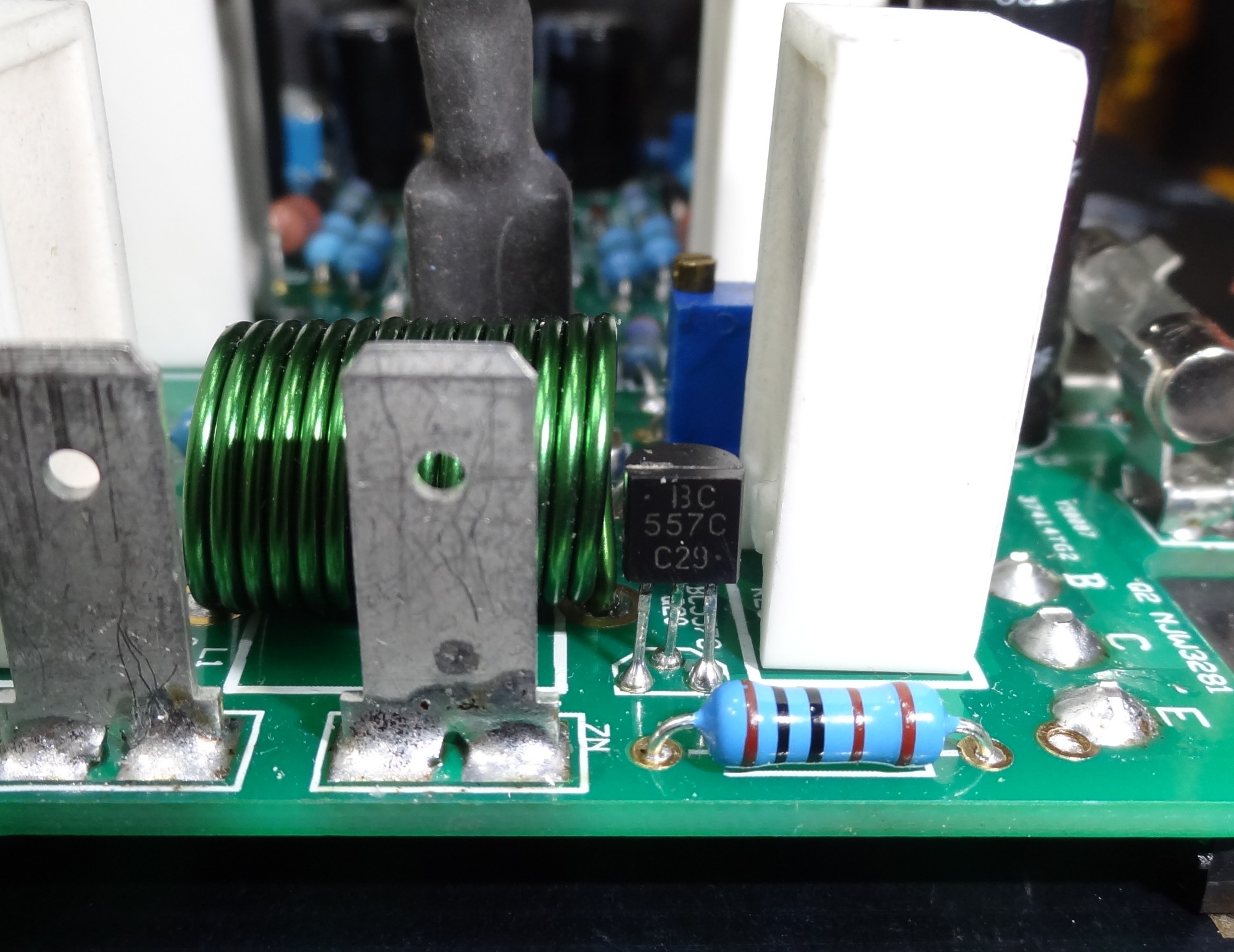

The Q20 BE voltage almost seems like you may have a BC547C instead of a BC557C
BC557C see pic

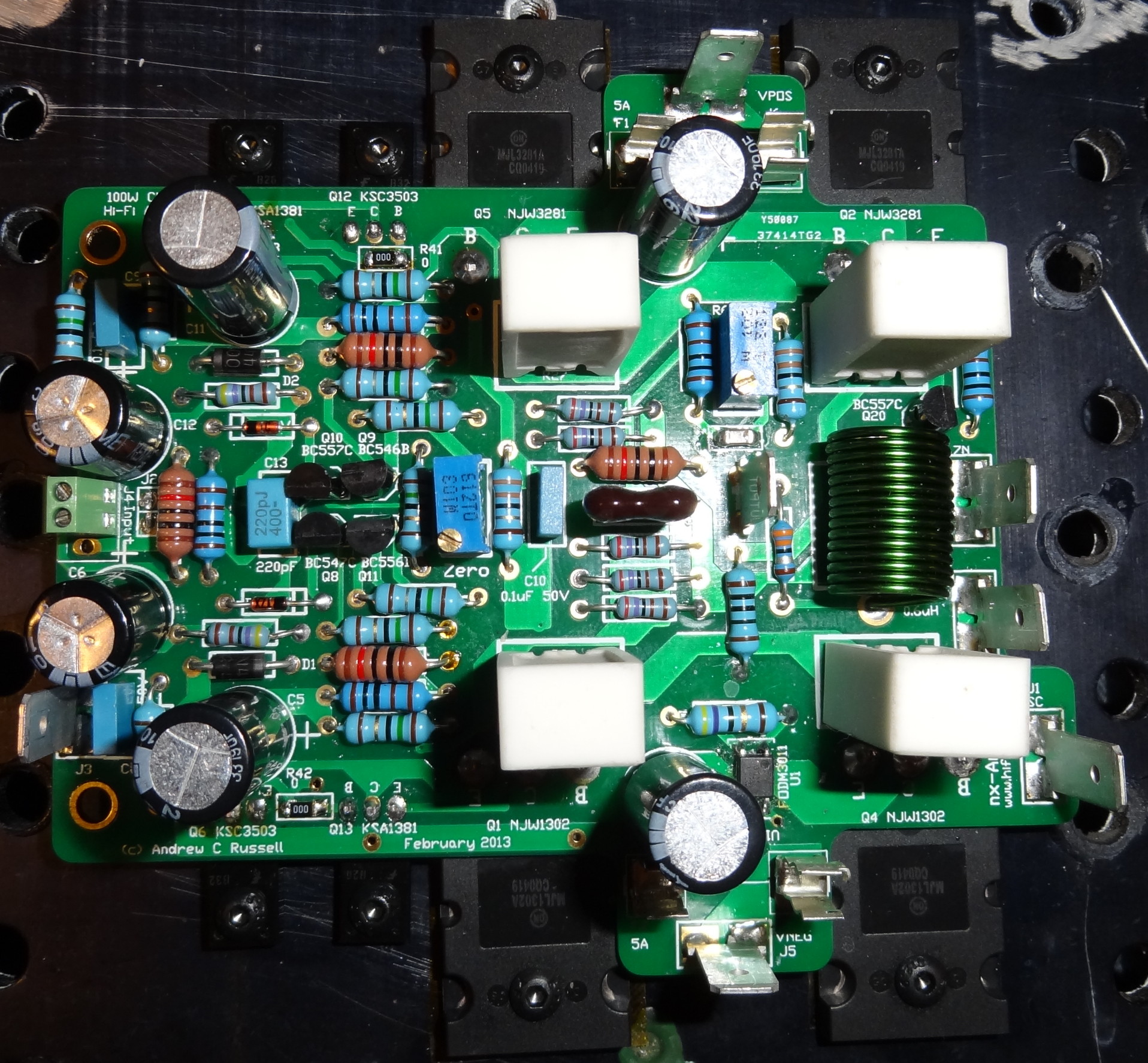

Are R41 and R42 linked out - i.e. shorted?
Yes with SMD 0R. see pic 2
