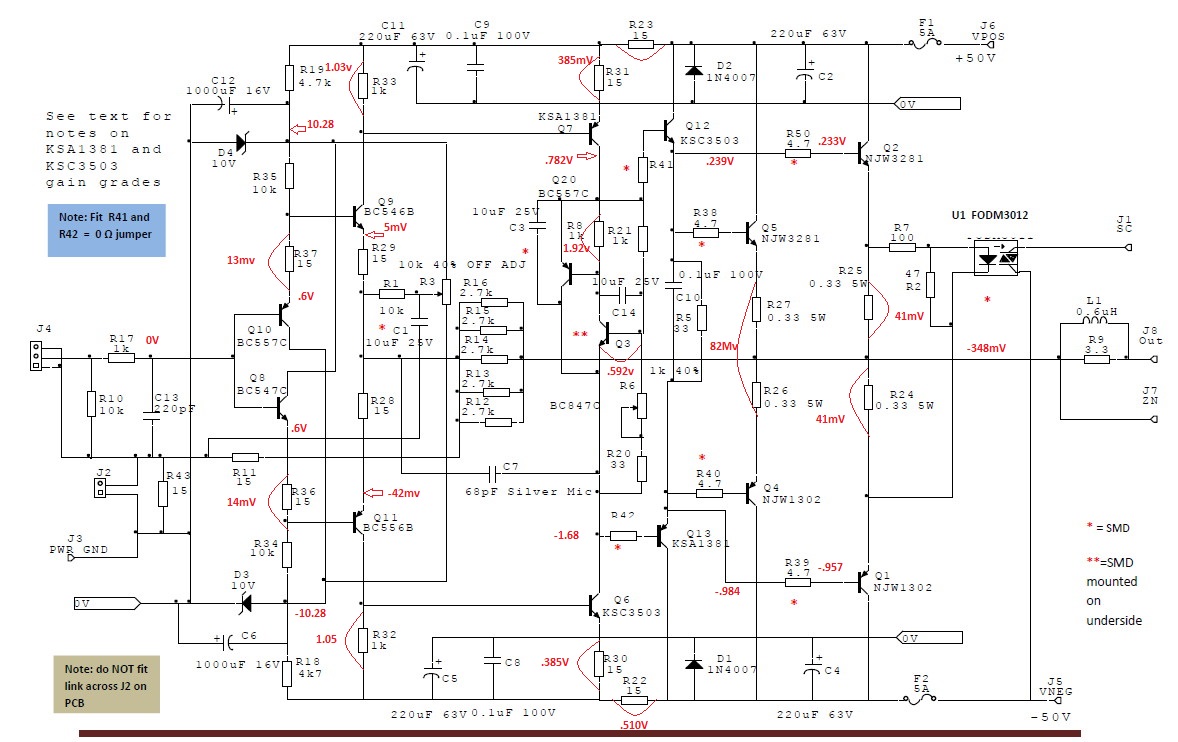

Hi Andrew,
I'm a bit stumped. I have -348V offset with the trimpot as far as it will go. I have replaced all of the front end devices with closely matched units. Just replaced Q6 and Q7 with as closely matched as possible. Replaced Q20 as well. I have gone through once more and checked each resistor and am fairly sure they are all correct. I am attaching a schematic with the voltages per my amp. I tried to include all the locations you had on yours. Any help will be appreciated.
Blessings, Terry
EDIT: The schematic calls R41, R42 33R but the parts list says 0R. That is what I have if it matters.
Blessings, Terry
