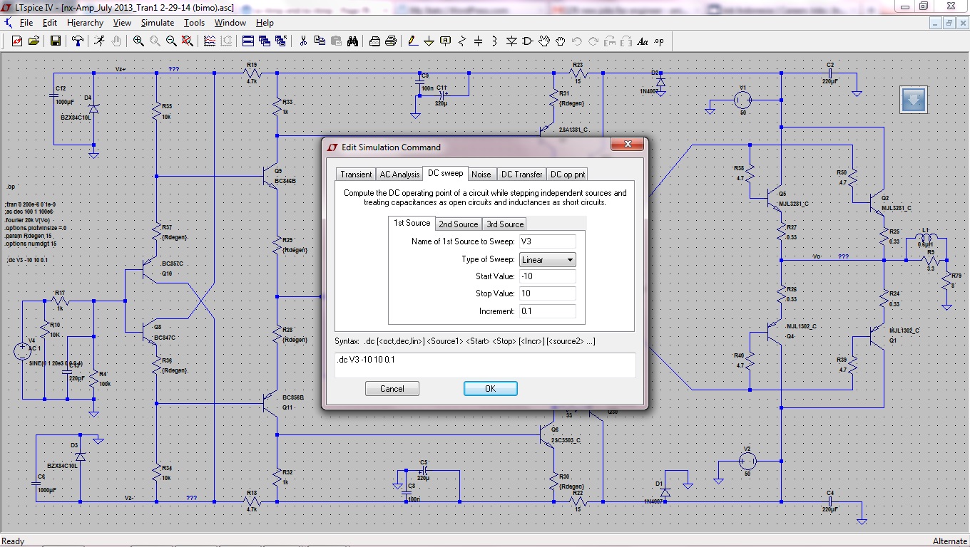

I played around with the spice file. I tried to add the things I could see that were missing. No matter what I try, I can't get rid of the off set. Maybe someone could look over my file and see if they can find the problem. My amp is pretty much doing the same thing as the sim so maybe if we can find a cure there I can find it in my amp.

Terry, your file have an error, double C7.
I use transistor model from keantoken. Just sweep the voltage of V3 to find 0V at output.

Thanks Bimo, You are tight, I didn't need the second C7. I didn't notice the original and added it. I have taken it out. I don't know how to sweep V3 or even how it compares to the way the amp is actually wired. Can you give a little more instruction?

You must use your own transistor model. Your "standard.bjt" file is different than mine. Please see this picture below. Then "Run" ltspice. Click output voltage to see graph V3 vs Output voltage. You can find value of V3 when output voltage is zero.
Hi Bimo,
Yes, I had changed back the transistors but when I hit run it just brought up a list and didn't give me the opportunity to read voltages around the schematic. I Don't understand how V3 simulates R3 in the amp circuit.
Click "Edit" ->"SPICE Analysis". Click "DC Sweep" input the value on my attachment in my previous post. Or you can write command ".dc V3 -10 10 0.1"
It will make voltage of V3 from -10V to 10V with 0.1V increment.
If you don't still understand please search google about "DC sweep on LTSpice". My english is not good, sorry.
Good news. I sent my spice file to a friend and he said to try piggy-backing a 1k resistor on R1. Worked perfectly. Now I can adjust the offset to 0.0 and all the voltages look symmetrical. Playing music on one of the boards right now. I guess I probably need to cut the jumper on the input and will still need to get the speaker protect part of the PSU board working but at least I have figured out the offset issue.
