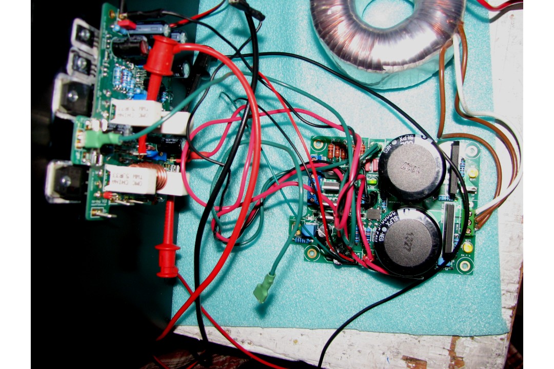

To follow up on previous post, here's a couple of photos of one board.

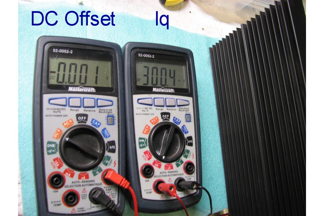

Both DC offset and Iq on target but both will drift for quite awhile even with the big heatsink.:mad::mad:

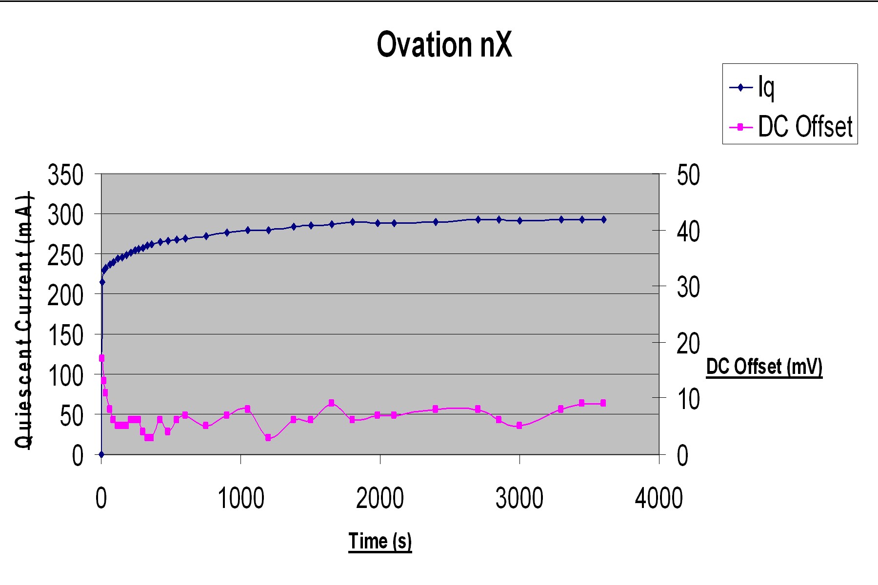

Can you define drift - how many mA and what offset are you seeing?
Ideally you just want to drive the amp until the heatsinks settle at their operating temp. 1/3 power get the worst case dissipation situation, but most amps don't work at that level, so I usually say about 50c is ok ( if you have really good heatsinks, then you may not even get to this level)
Then adjust the offset and Iq.
During the process, you may have to tour the current down a bit if it gets excessively high but the objective is just to get to the final operating temp so you can make your adjustment.
I repeat, on my boards the offsett settles at 1-2 mV and the Iq is also stable. Ditto the sx-Amp also.
Iq/Offset profile
Bonsai, here attached is a chart tracking the Iq and DC offset over time, input shorted. With the heat sink I am using, it takes about 45 min for the Iq to settle at around 300 mA as the sink reaches an equilibrium temperature of about 43C. In this test, the offset settles at about 8 mV but can be further adjusted at this point down to +-0V. Seems a long time but without any temperature compensation on the PCB, I guess that can be expected.

This is only one channel. As I said, the DC offset can be reset to near 0 once things settle down. I will test the other channel the same way.
Finally got the Speaker Protect on the PSU working. Not sure if it was replacing parts or finally figuring out how to wire it. The build guide it a little difficult when trying to follow all the connects/wires. Really should have a simpler diagram. Anyway, without all the grounding in place etc etc, this channel sounds pretty fine safe for a slight hum/buzz at low volume - but probably grounding related. On to the next channel...
Finished the second board. Using same parts as first board and matched trannies all in the right places, board behaves like the first for Iq and DC offset, but a difference in voltages at R32/R33! Board I sent pics of had the required 1.0V+-50mV but this second board's value come in at 0.78V +-50mV. Before I start taking things apart, any ideas to explain the difference, to track why or is this another Jim's Audio PCB quirk?
