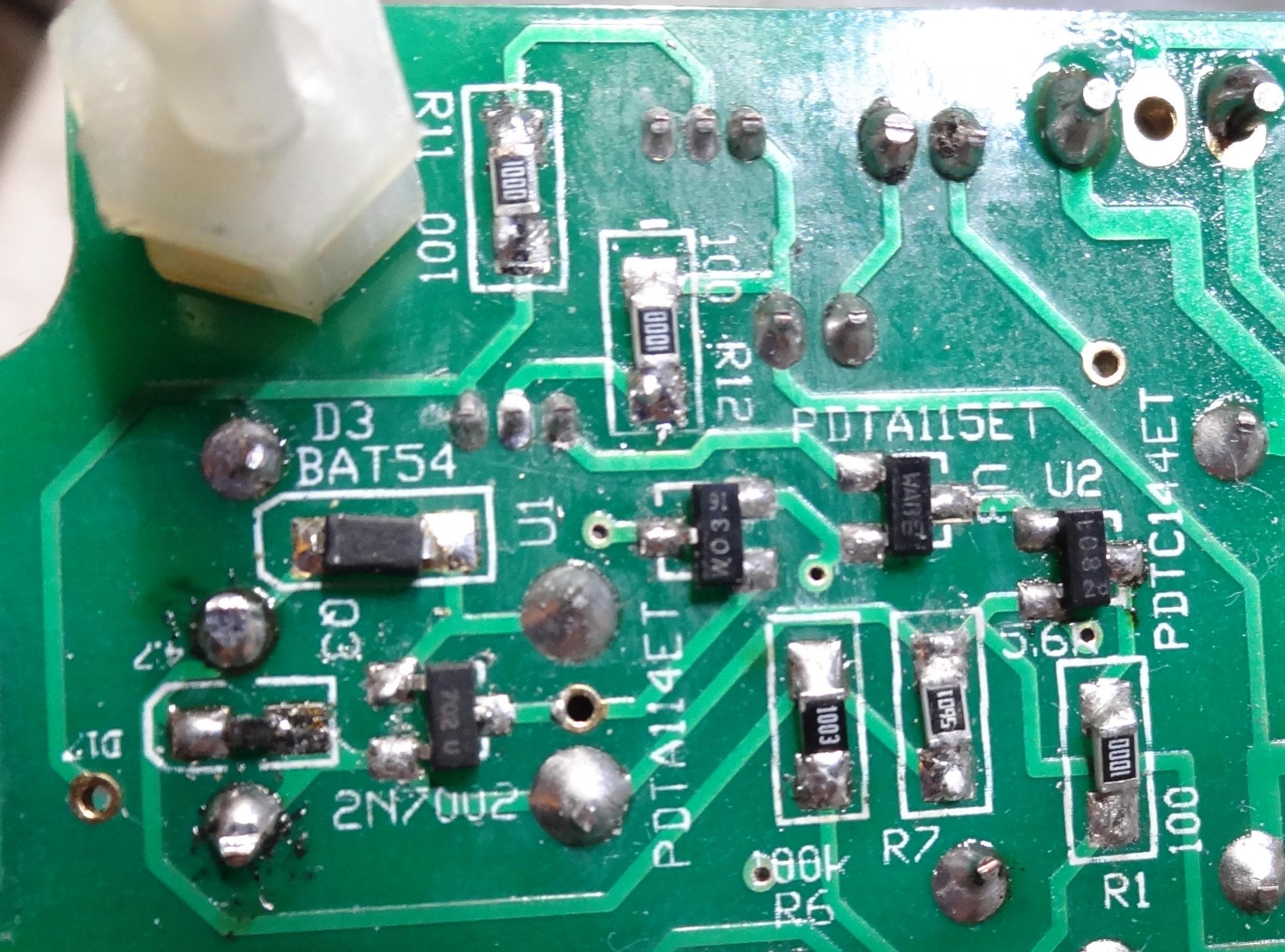

Hi Guys,
I swapped out the resistors. I still needed to lower R9. I just piggy-backed another 10K resistor onto the existing. That was enough to be able to dial out the offset. I've had the amp playing for a couple hours now. Sounds real nice. I just have one other issue that I think was covered but a search didn't expose the fix. On my PSU, D15 comes on instantly on power up. I believe there is supposed to be a delay. What should I look for to fix this?
Thanks, Terry
Thanks, Terry

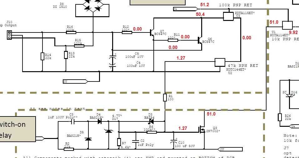

Check Q3 2N7002 for short circuit from drain to source. If that's ok, measure voltage from Q3 gate to source during power up. The voltage should rise slowly as C10 charges up. If the voltage at the gate snaps on maybe C10 has a bad solder joint.
Also check U1 pin 2 to pin 3 for short circuit (that's V+ to the junction of R3, R27, and R10).
1.25V at Q3 gate to source is probably not enough to turn Q3 on. That's the voltage I had and had to change R7 to 20K to get the circuit to work. However in your case since D15 is on it implies that Q3 is on as well.
If D15 is on, then somehow U1 must be turned on. It might be helpful to measure voltages from all three pins of U1 with respect to ground (0V). Also confirm that the correct part is placed at location U1 - PDTA114ET (marked as 03).
U2 and U3 shouldn't have anything to do with the delay circuit not working correctly.
I gave every effort to place the proper devices. I don't have extras so I can't be sure now since the markings on them aren't the part number. I am attaching a small schematic with the voltages for each of the transistors in that circuit.
Thanks, Terry
