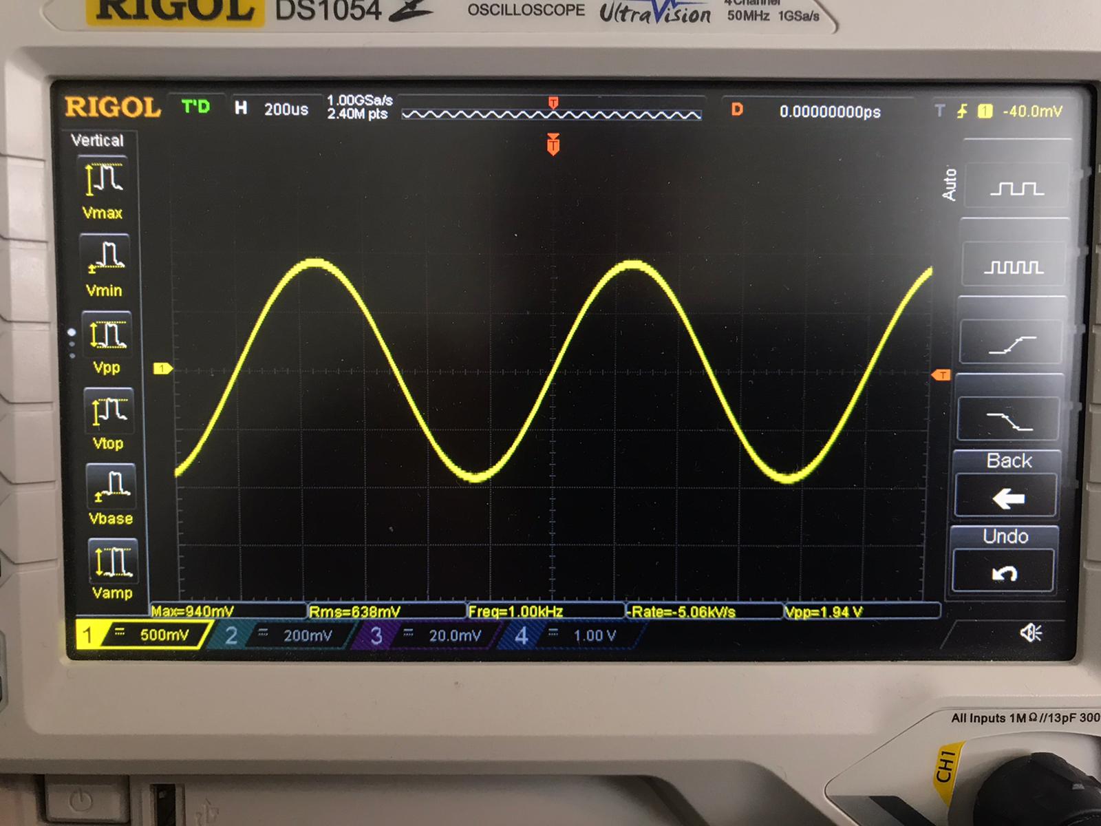

Thanks Bonsai and Pitbul. Sorry I think I putted you both onto the wrong conclusions. The amplification factor is 1.94/(50*10-3) =38,8 (at 1000Hz, sine wave). A bit higher, but no exotic deviations. I conducted the measurements Bonsai requested:

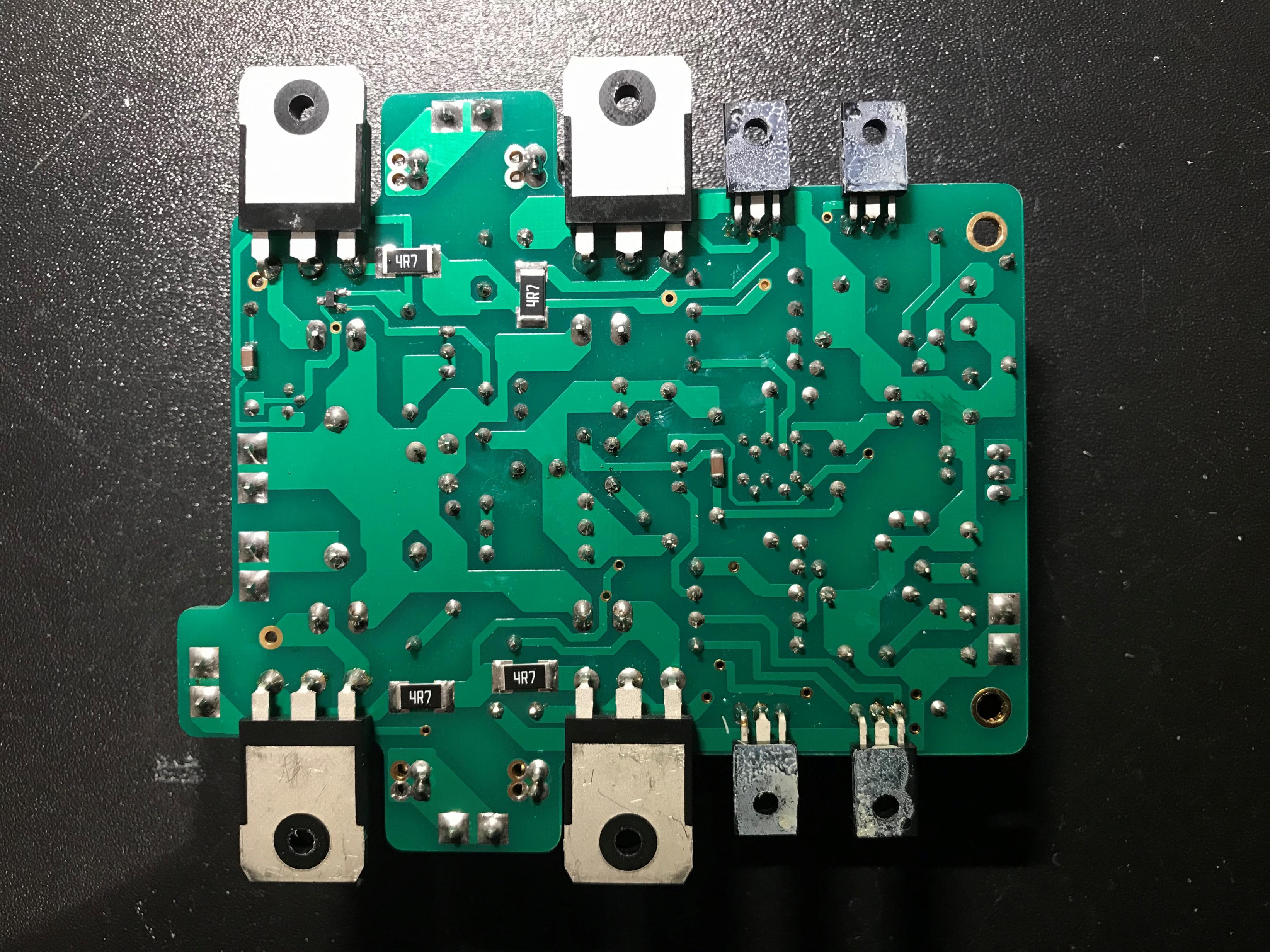

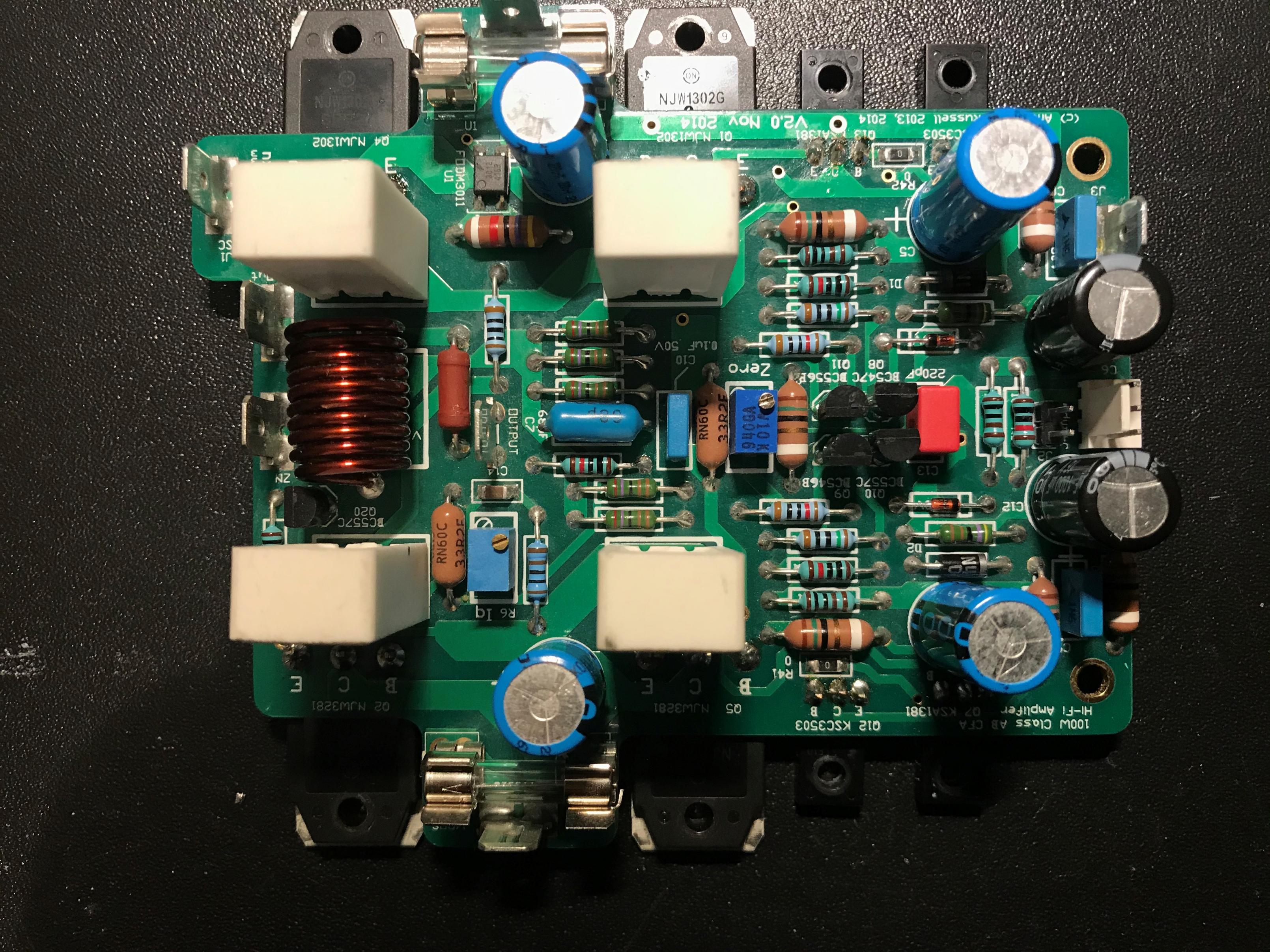

Hi Andrew,

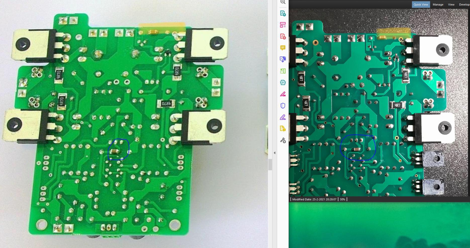

Hereby two high res pictures of the board (they need some cleaning I see ;-)).

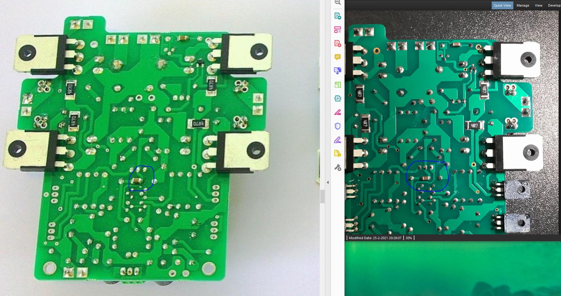

Ps. there seems to be something different, but I am not completely sure if that is due to the picture. See pict. 3
Michael

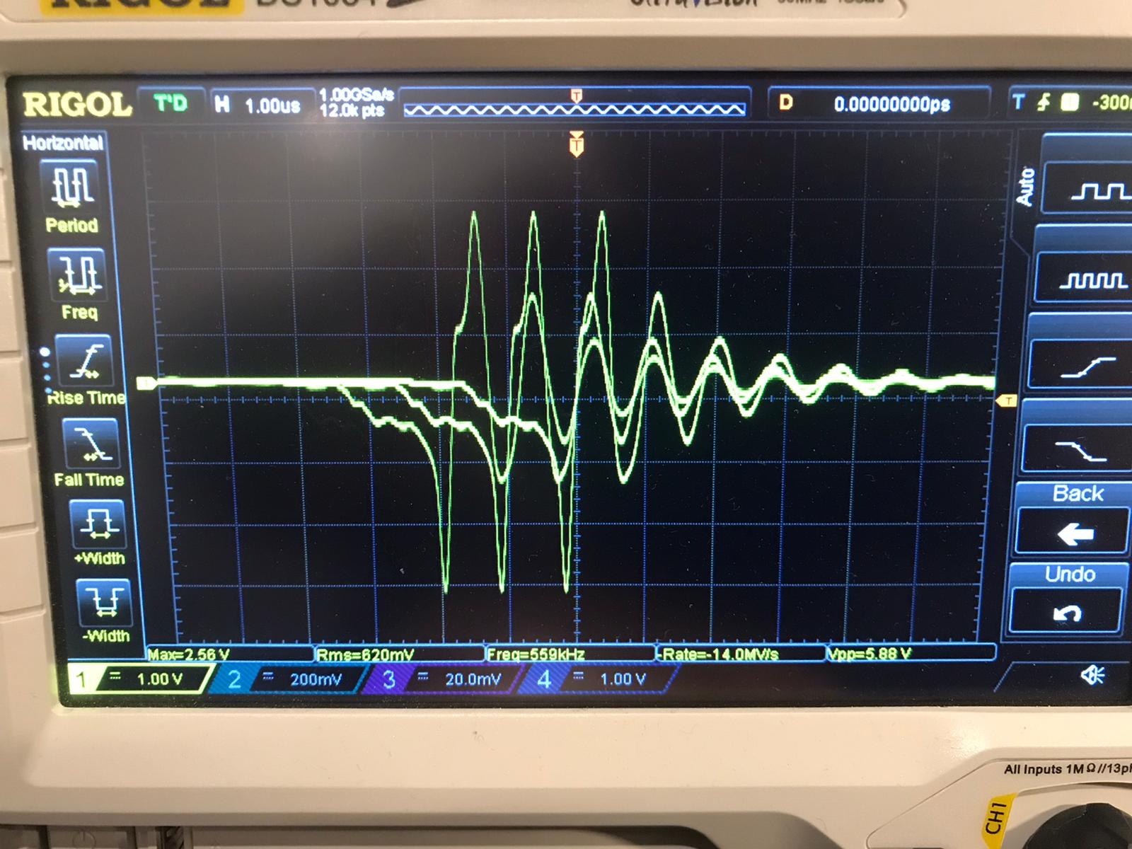

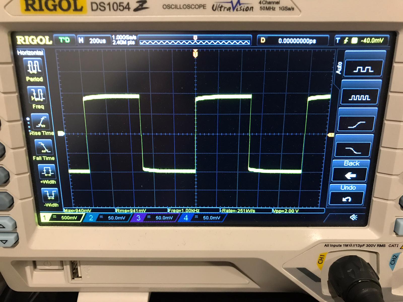

Short recap: when inducing hum (for example by touching the input sockets) the amplifier oscillates at +200kHz, swinging rail-to-rail and therewith cooking the Zobel resistors quite rapidly.

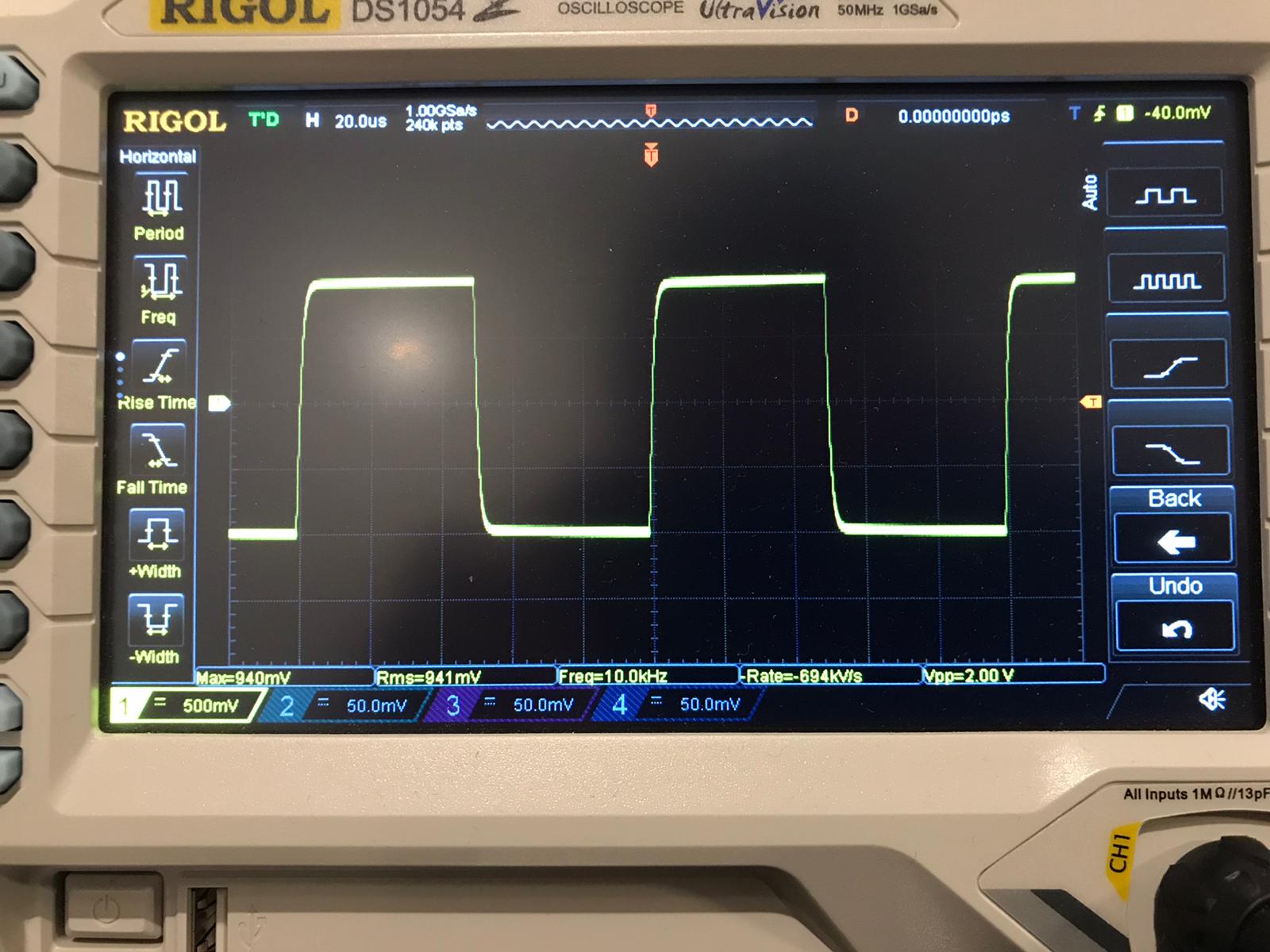

After lots of measuring and testing we could conclude the boards and parts are OK. The Ovation has an input filter with an Fc of ~723 kHz (1K ohm + 220pF cap). I was able to stop the oscillation by changing C13 from 220pF to 820 pF. This lowers the Fc to ~194 kHz (-3DB point). By doing that I could eliminate the oscillation. As far as I can judge the amp is now stable (see attachments, 1kHz square wave, 2v PkPk and 10kHz square wave, 2v PkPk). When I leave C13 out the amp is very unstable, with lower capacitance for C13 the oscillation frequency seems to increase.
I kept one channel original and putted in the other channel the new 820 pF capacitor so I could compare. You can see that the channel with the 820 pF capacitor rolls off a tiny bit earlier at higher frequencies (RF), but not very significantly (certainly not noticeable in the audioband and far beyond). You see that when I inject a square wave the higher frequencies roll a bit off (a tiny ramp up at the beginning of each square), but that is not different from the other channel with still the 220pF capacitor in place and to be expected as far as I can judge.

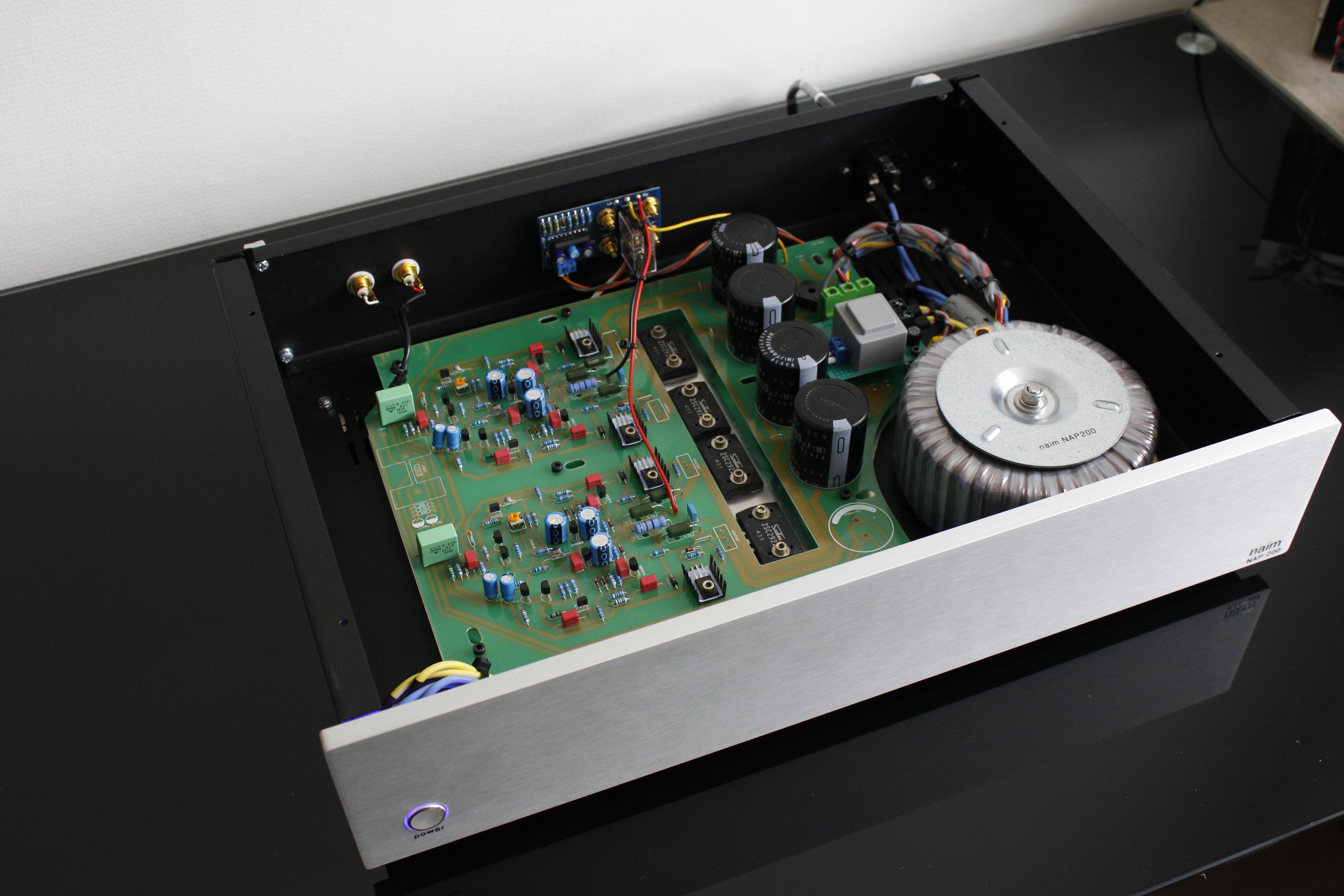

Unfortunately a party does not last forever. Although I mitigated the phenomenon a lot by exchanging C13 it is still not completely perfect. Somehow, do not as me why, I was able to induce oscillation at a lower frequency. And very specifically when I make connection with a CD-player. More specifically when the RCA is being plugged in, signal in makes contact, just before GND makes contact. When GND is connected everything is fine again. Grrr... oscillation again... but now at 120 kHz. And that is unfortunately way below the Fc. And this time without the lightbulb in series. But fortunately I could save the Zobel and thus the magic smoke. Now, I could increase C13 a bit to lets say 1.5 nF (Fc will then be 88 kHz). But I am afraid that in another, very specific situation we will get again and again oscillation below the Fc. Difficult... I do not really trust this amp as it is now. There must be a fix. What do you think Andrew, shall I leave the NX for a while alone and wait for your results, or shall I increase C13 again?
Ps. I finished a few months ago a Naim NAP200 amplifier. I was yesterday briefly able to listen some music. When the NX did work it was quite competitive to the Naim :king:!
