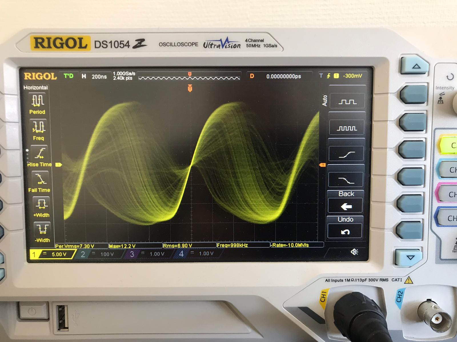

Too long no see! I have to confess that it has been a while since I made progress with the Ovation Amplifier. However, meanwhile I have acquired some parts, perfect heatsinks and finally putted everything in a cabinet. Far from finished yet, as I also want to put some nice VU-indicators and rearrange the wiring a bit better and more tidy, but the idea is more or less there.
In the end I decided to make a different configuration than I posted a while ago Today I decided to run some tests. Nice flat frequency response at a very broad spectrum, very low levels of noise, excellent square wave response with no ringing visible. It is a real power house and gives about 108W RMS @8ohms.
So I decided to put some music. There unfortunately things went less prosperous ;-). I use the computer as preamp. I mentioned that when connecting the RCA's to the amplifier, while being plugged into the computer soundcard, the amplifier started to draw quite some power (+1A @230V, long live the series lightbulb). Even worse the Zobel resistors became hot. Fortunately it is cold right now in NL, but our heating system is already sufficient. Now, I do remember SjoerdSmits experienced years ago more or less the same issue in a different context. Also his Zobel resistors got fried. So I guess it is definitely a Dutch thing 😀 This effect seemed to be a bit at random at first, but after fiddling around I saw a pattern; it happens only when having connected, or connecting the RCA to the amplifier. And only when the other side of the RCA was already plugged into the computer. I can induce this effect at both channels. I measured the outputs while an 8 ohm load was attached. Making a picture was quite tricky as continuing too long would fry the Zobel, but I managed. Now I compared the input and the output and to my surprise, it is actually the soundcard/computer that is injecting this signal of +/1 1MHz. Somehow it seems to be connected with the computer itself. I have two soundcards in this computer and both give the same effect. So fortunately, as it seems, it is not the amplifier itself that is oscillating. I can also not induce, or quit this effect when the outputs are shorted. The computer is not grounded, maybe that is already part of the problem. But this somehow worries me a bit as this can be quite tricky when you have an unstable pre. Bonsai and others, do you have suggestions how to tackle this? Is it maybe advisable to put a low pass filter as the amplifier amplifies a very broad spectrum (even at 1.8MHz there is still quite some gain)?
Further, I followed all rules with two exceptions; 1) rail voltages are a bit higher at 52VDC (old 35VAC transformer that is originally made for 220VAC), 2) I biased a bit less than advised and went for 200mA (the manual mentions 300mA if I recall correctly) to save some power consumption. Am I taking a gamble with the rail voltages being a bit too high?

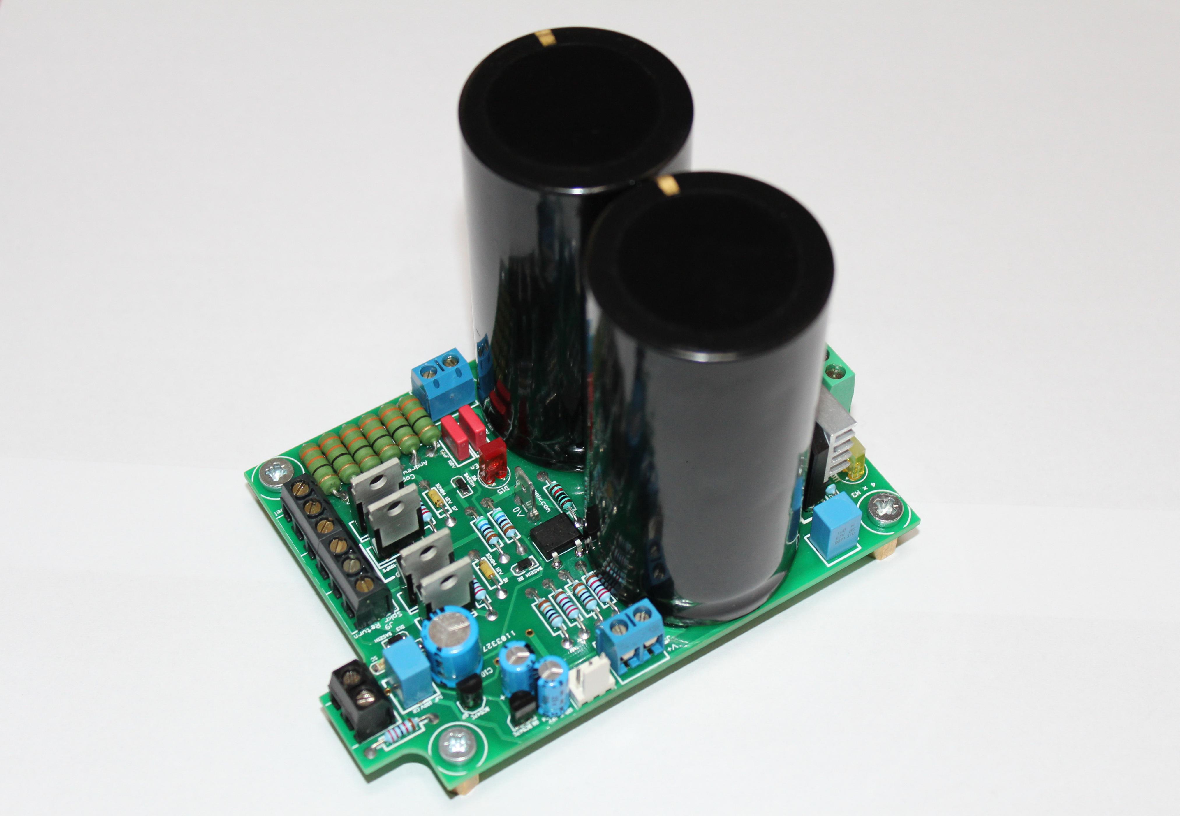

I will have to come back to you a bit later today on this. What PSU are you using with your nx-Amp? Do you have the Zobel connected?

1) The PSU I am using is Version 2.0, obtained from Jims Audio (attached a picture)

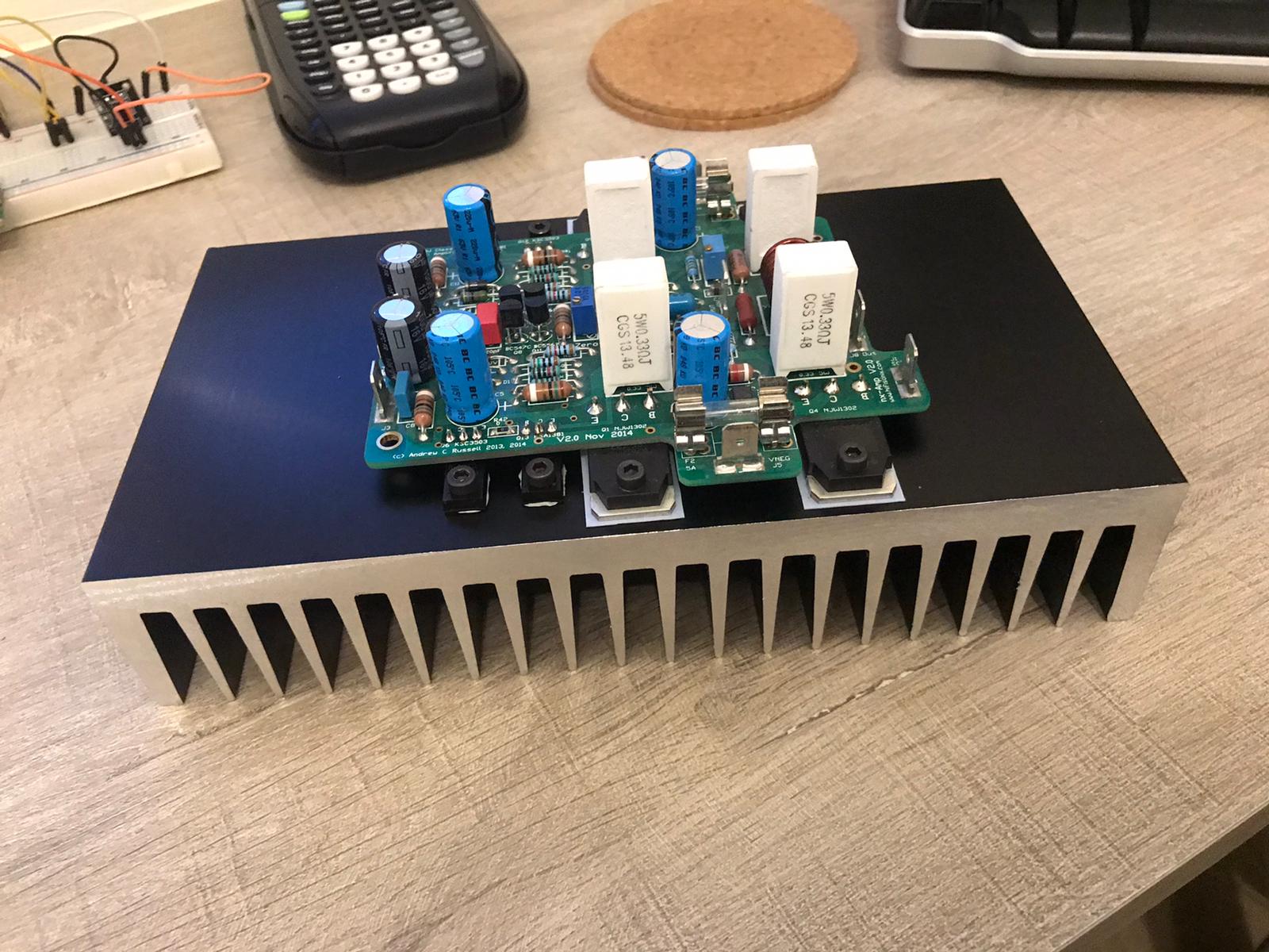

Can you send me a close up photo of one of the amp PCB’s please so I can see the components?

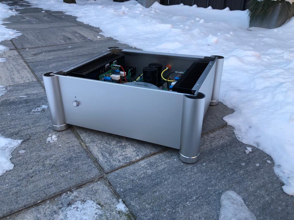

Nice chassis BTW - where did you get it?
The chassis look nice but not very practical with the screws from the inside.

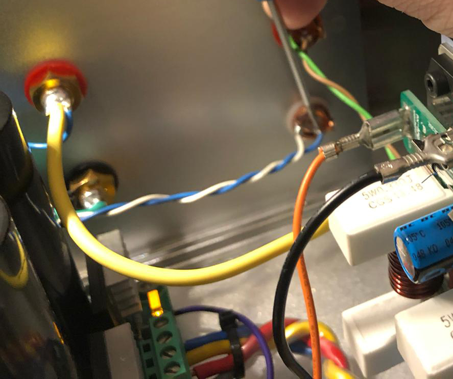

@Kaplaars
do I see it correctly, you tied input twisted wires to output wires of the second amplifiers, try to put away input wires from strong signal.

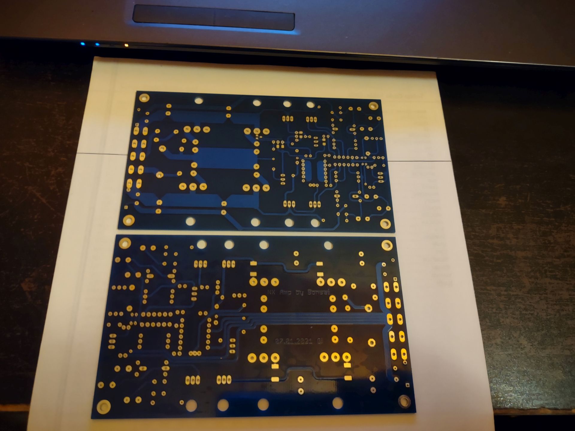

Today was arrived by my self designed PCB`s for NX amp...this weekend the assembling will coming up...any comments? suggestions?

@ Jaques: true, but I see that as an advantage. In general I like to cover screws as much as possible ;-) Although it is certainly true that it takes a certain way to get everything apart.
@ Bonsai:
1) I obtained the chassis from AE:
WA113 Aluminium behuizing Voorversterker chassis eindversterker case/doos maat 280*320*120mm|Versterker| - AliExpress

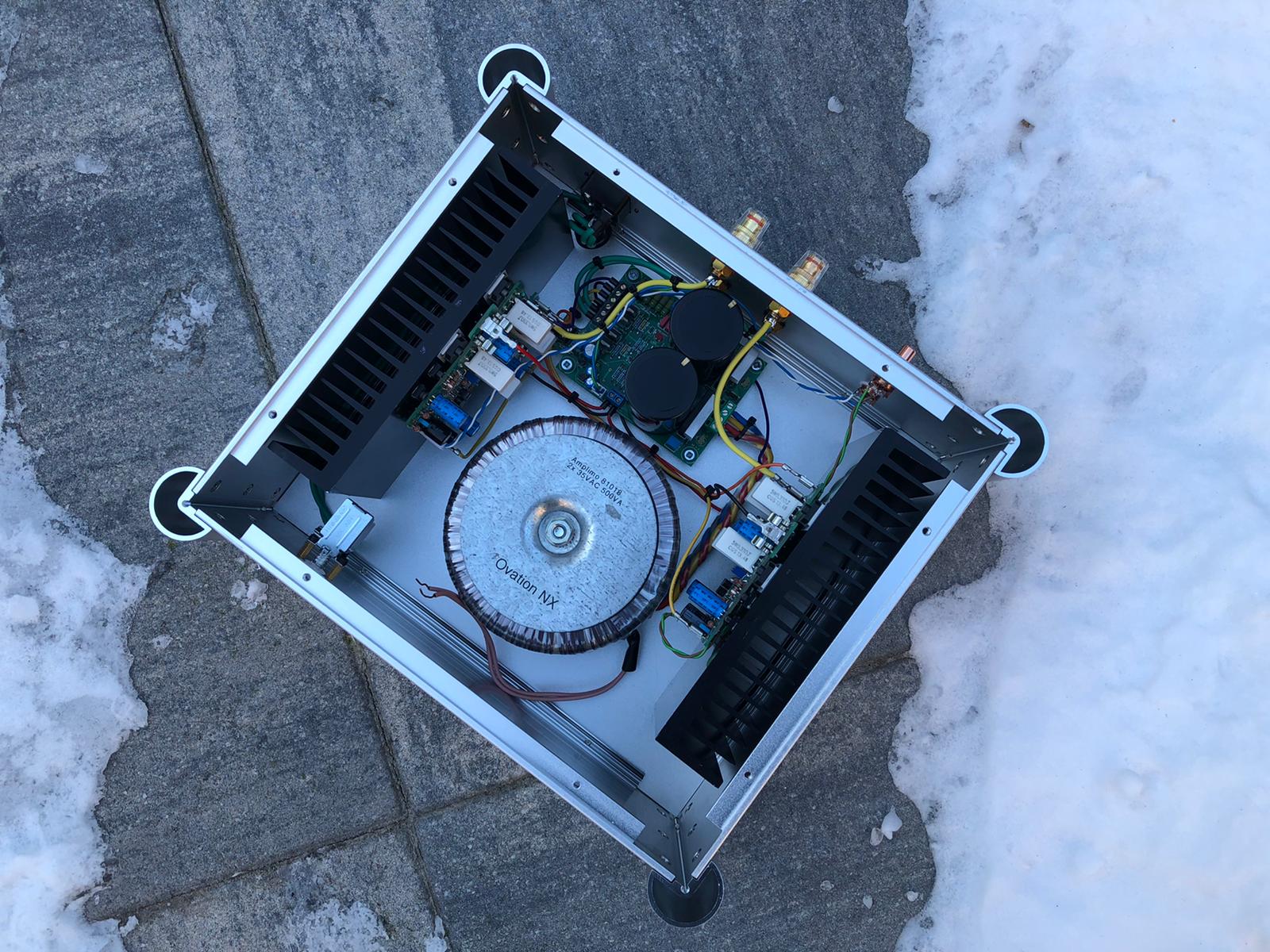

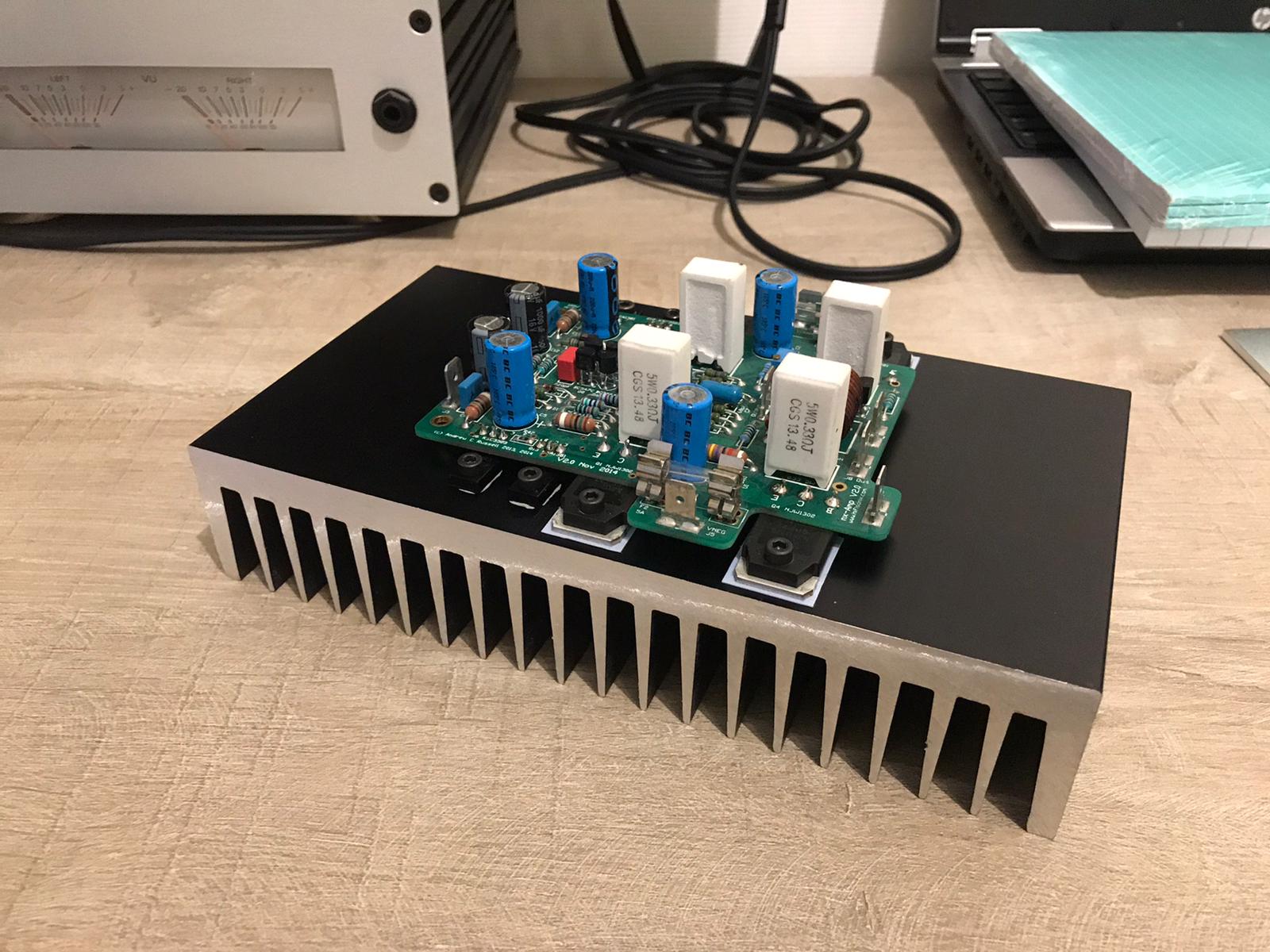

The heatsinks are from Fisher. I cutted them such that they fitted. Attached some extra pictures. Ps. in the pictures you can still see a green jumper. I removed that one later. I hope that was indeed correct.

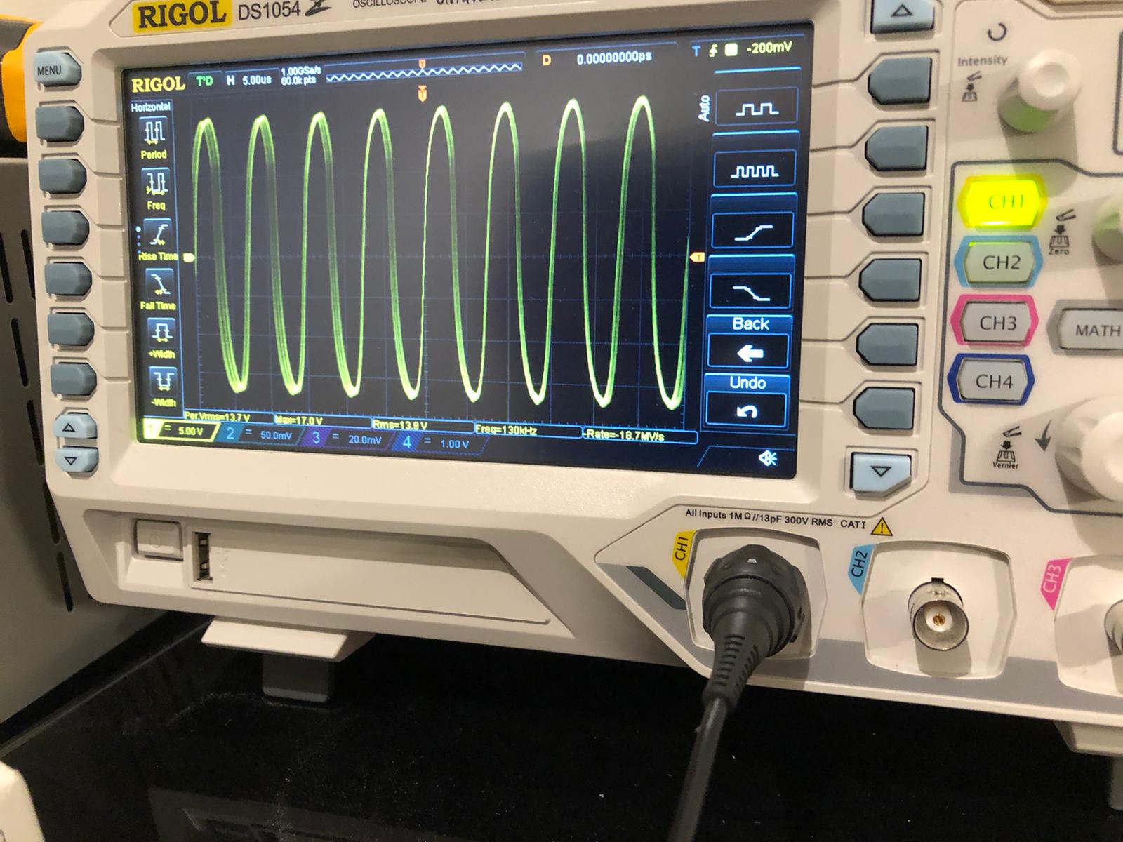

I can not edit the previous post, but I have a small update. As I did not have connected signal ground via an independent wire to the main ground I think I should have added a jumper at J2 (is that correct Bonsai?). That has been done (just like in the picture before). Unfortunately is has not solved the issue.
I found out how to reproduce the issue the easiest way. It only happens when I connect one RCA completely (so signal and GND), while I connect the other RCA only by signal (so not GND for one channel). And only when connected to the PC. What then happens is that I get a sine wave at about ~424 KHz at the input and at the output of the amplifier (of course not the same amplitude). This signal is induced from the PC. The strange thing however is that I can not induce this phenomenon when connecting another amplifier to the same PC and soundcard. Also I have no clue why it is now 424KHz and not 1MHz as shown earlier. Something is wrong, but what exactly is a mystery.

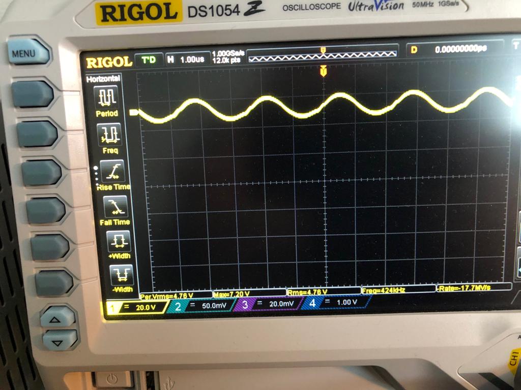

Me, I don't understand your architecture.Also I have no clue why it is now 424KHz and not 1MHz as shown earlier. Something is wrong, but what exactly is a mystery.

Kaplaars, can you unplug your computer from the amp, and then with your scope measure the noise between the computer earth and each output on the computer - both the signal ground and the signal return.

@thimios, good suggestion! I was thinking the same and I tried directly at the RCA inputs. Unfortunately it has not solved the issue. I was checking the schematic. There is a 220pF cap for more or less the same function on the boards themself. It has been fitted correctly.
@Bonsai: I isolated the problem to the amplifier itself. I can induce the same phenomenon by just gently touching the inputs while having a dummy load connected. Basically I inject 50Hz by acting as an antenna. However, at the output I see a sine wave, with no visible harmonics, of more than 200KHz (frequency varies depending on how hard you touch / changing resistance). It happens only when the dummy load is attached (so the amp can dump its energy). It happens with both channels independently. I removed the signal cables to make sure I was not picking up noise (the cables are twisted, but not shielded yet, I will replace that later). However, even with no signal cables attached, and just touching the input on the PCB itself / inducing hum, immediately causes the same effect. It would be logical if the amplified hum signal is 50Hz, but it is somehow transformed. That transformed hum signal causes the Zobel to heat up. The strange thing is, when I apply a sine wave with a signal generator, there is a perfect sinewave at the output of the right frequency. And that till +2MHz. My scope has a limited FFT function, but no harmonics can be detected. Also I do not see any ringing when applying a square wave of 1KHz.
Summary of what I know thus far:
The problem arises when hum is induced by; connecting an improper/not well shielded cable, or by touching the input. This results in more or less a (crippled) sine wave at the output ranging between 400KHz and 490KHz (I can chance this frequency a bit by fiddling with pressure) at almost full power. When the Zobel is connected it gets fried (so I now disconnected it) when changing inputs / inducing hum.
The amplifier runs on on a rail voltage of 52VDC | 0 | 52VCD (lowering the voltage via an variac does not have an effect onto the problem). Connecting, or disconnecting J2 does not make any difference. I am still not sure weater I should connect or disconnect it (manual says remove so the hum breaking resistors work, but in this topic I read to keep it).
Parts are all original, from reputable companies (Digikey, Mouser, Conrad).
Bias setting does not affect the issue, amplifier is biased at 200mA (100mA per output device), there are no problems with changing bias or nulling the output to zero. Heatsinks keep cool. Of course only heating up when delivering power, but acceptable (max 40 degrees).
When nothing is connected to the amplifier, there is no audible hum, oscillation etc. Of course, there is a tiny bit of noise at the output, but very small and not very different from other amplifiers.
I took care with routing (of course it can always be improved), earth is not connected (yet), connecting GND of the amplifier to the chassis or not does not affect the problem. Although connecting GND does lower noise a bit (to be expected).
The problem is independent from both channels, and occurs at both channels with more or less the same intensity.
A nice but difficult puzzle to solve ;-). I guess somehow I made a mistake with populating the boards. Could you see an error on the pictures I sended? Do you know of others that also experienced this problem Bonsai? I used the search function, the only member that seem to have experienced something similar is Sjoerd. And I think Andrew had some oscillation problems. I am not sure if and or they tackled their problems / found the cause. Do you have other suggestions?
