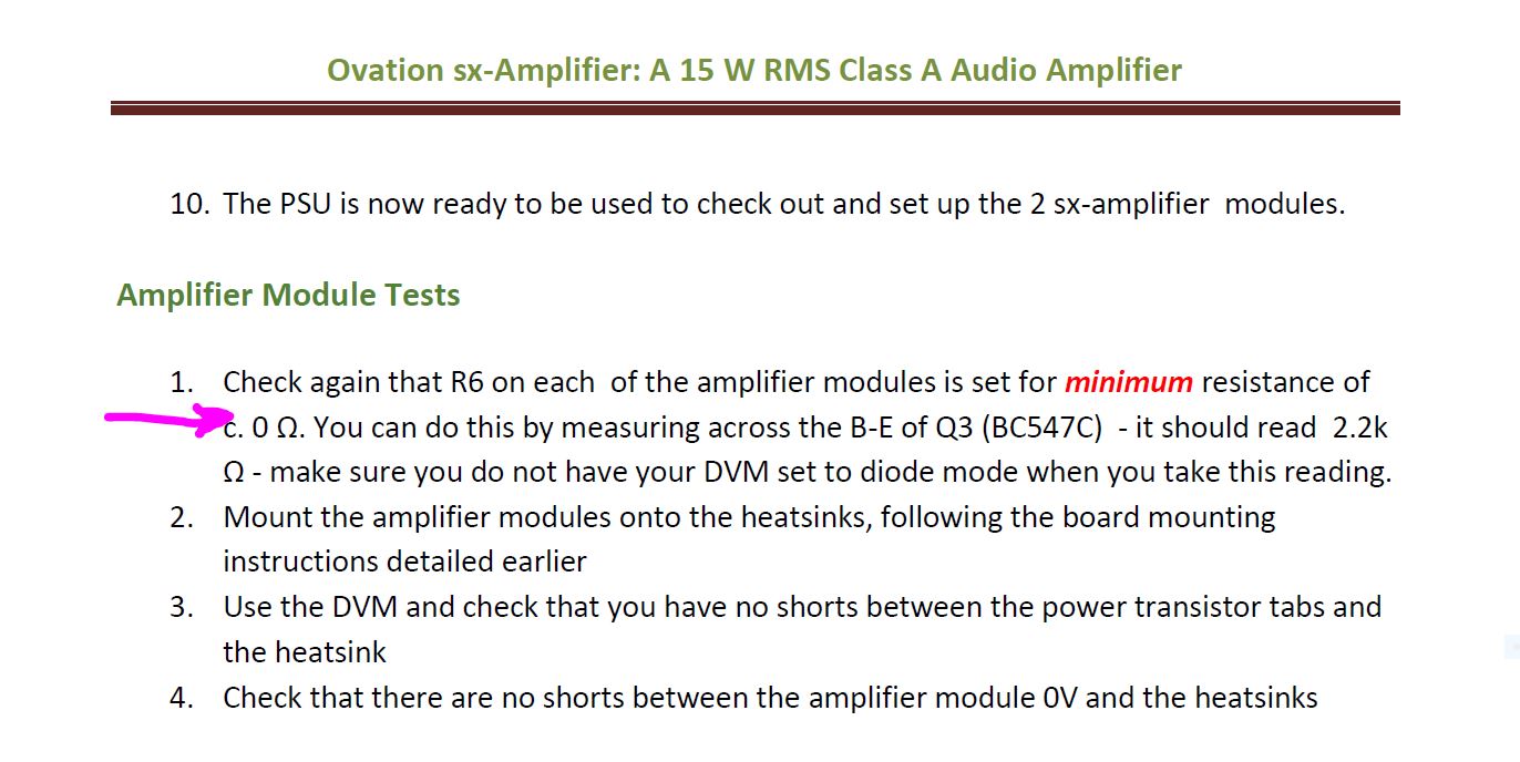

sorry Bonsai I have to clear something here, "I'm confused to be honest", okay so R6 need to be adjusted to 0Ω and from Q3 measure across B-E it should have 2.2KΩ if R6 is 0Ω but if that condition is like that then when turn on the first time is gonna be already on the 1.4A the setting that the circuit needs to be to operate in class A, is not better to have R6 on maximum resistance first before power up? or maybe set to 250Ω? I can be wrong
having R6 at maximum resistance @22 supply voltage I got from emitters R25 and R24 about 410mV that is a 1.2A to star
then R6 to slowly adjust till R24 and R25 have a reading of about 450mV giving the goal of 1.4A
but if R6 set to 0Ω does not cause any problems then put a 😀 and it will be answer and done deal and I will move on on the project 🙂

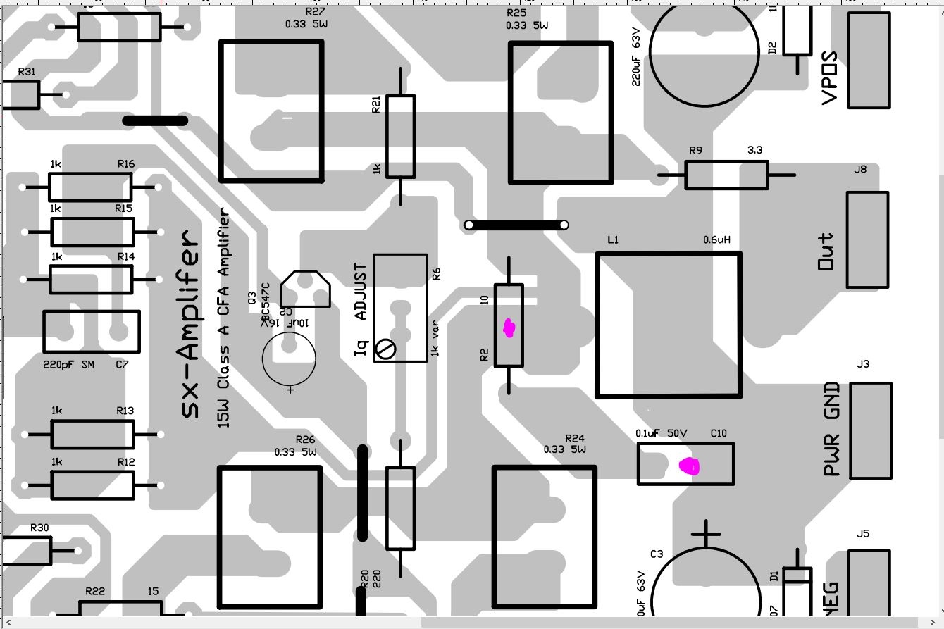

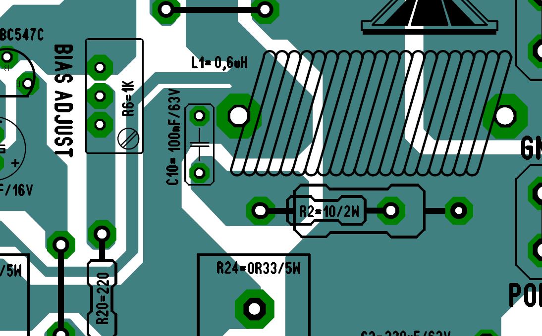

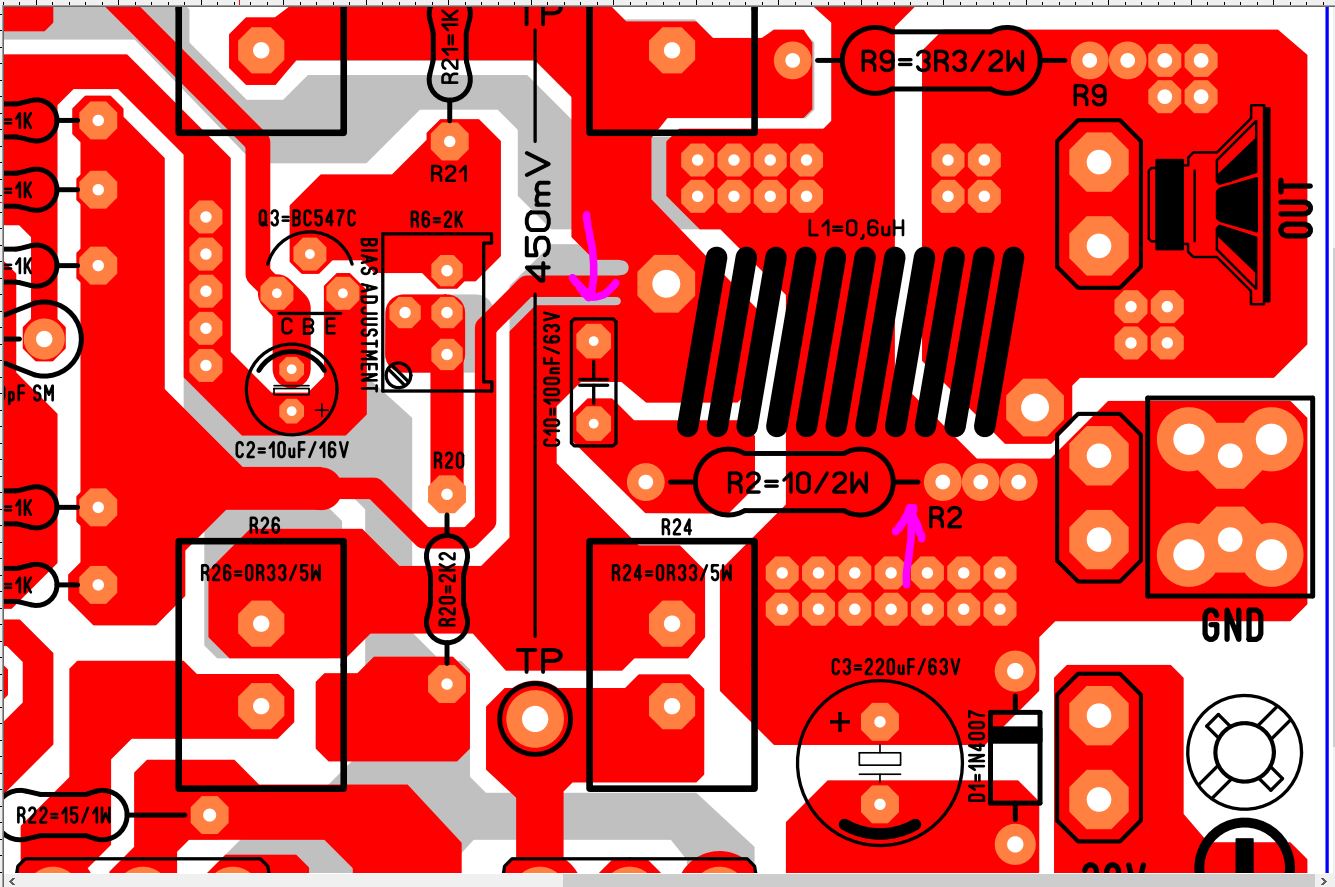

hi guys I have a question I was cloning the PCB and I know that Alex MM clone the one that Andrew made then me okay, the ZN I notice on Alex PDF that he place the C10 before the coil then resistor in series to GND but in the original layout by Andrew I think he did it differently resistor to coil then in series to C10 to GND is this really don't matter? the grey layout is the actual gerbers from the website the red one is the one I'm working now and the green one is from Alex's PDF I just want to be sure to get it right

The order is not important. What IS IMPORTANT is that you always fit a Zobel and the R and C are connected before the coil.
Alex MM's board is probably better than mine because he mounted the Zobel on the amplifier board and so kept the Zobel loop area much smaller around the OPS.
For those of you using my board (sold by Jim's Audio) make sure the connection to the Zobel which is on the PSU board is short and twisted tightly with the power supply cables.
These comments about the Zobel apply to all amplifiers BTW.
