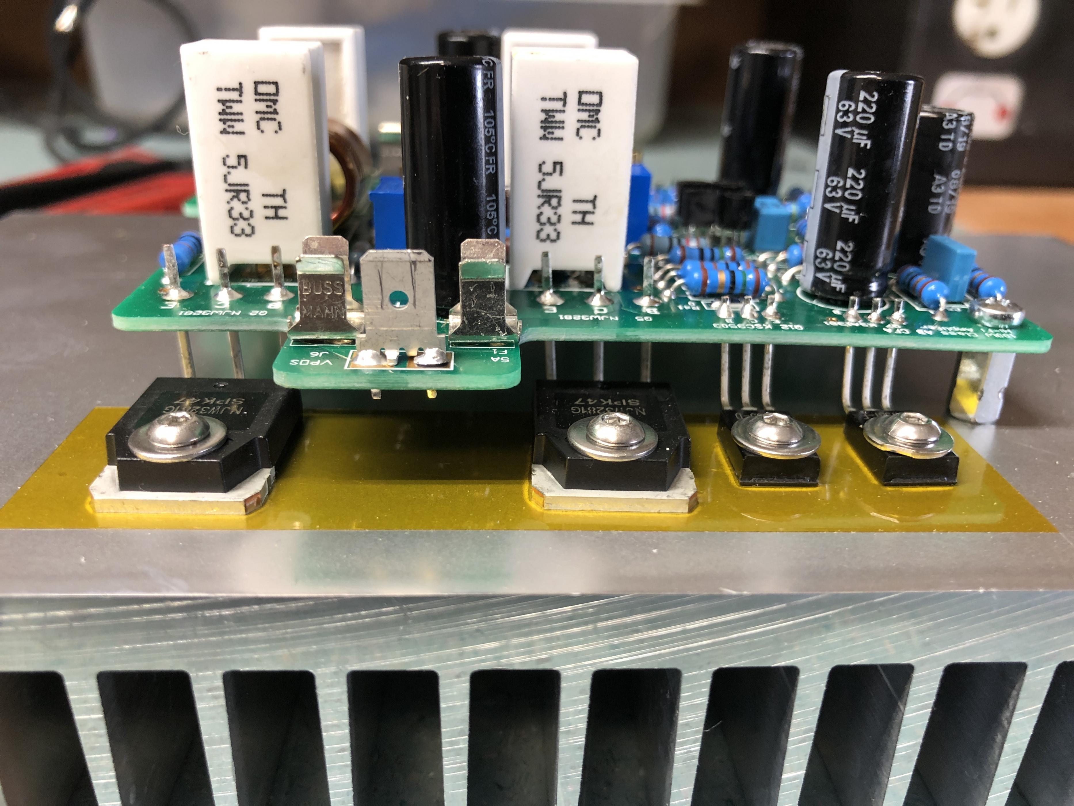

After the boards were completed I noticed that Andrew soldered his boards touching or sitting directly on top of the heatsink devices. I left room between the amp boards and the heatsink devices. Was there some thermal considers for Andrews approach?
Here is a picture of my board/heastsink. Am I OK here? Or should I move the board to sit on top of the heatsink devices?

Dennis,
Your attachment to the heat sink looks ok!
The drift you see is due to thermal gradients across the input devices. It may be a bit lower if you had just seated the PCB directly onto the output devices as I did, but it’s a non issue.
Once your amp is boxed up and loosed to settle thermally, the drift window will decrease.
Make sure your source output is AC coupled.
Your bias current is set correctly, you are good to go! Remember the output emitter degenerate resistors are 5% tolerance and you then also have the Vbe spread in the output devices so there will be some variation in the emitter resistor voltage drops.

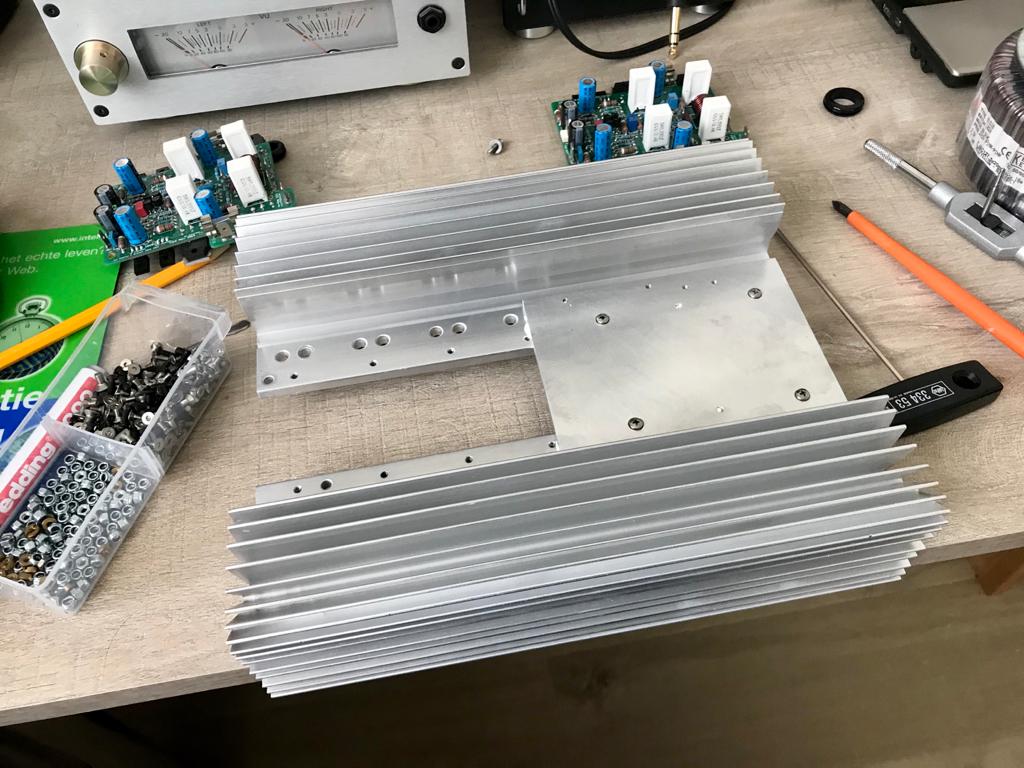

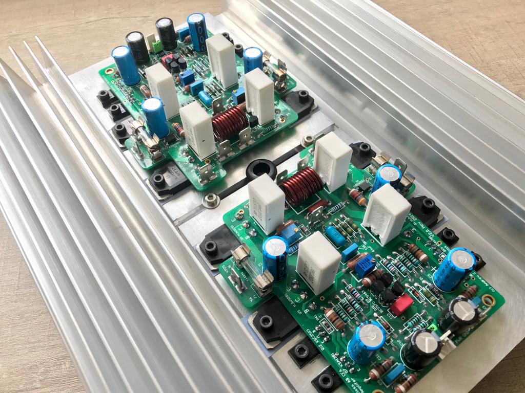

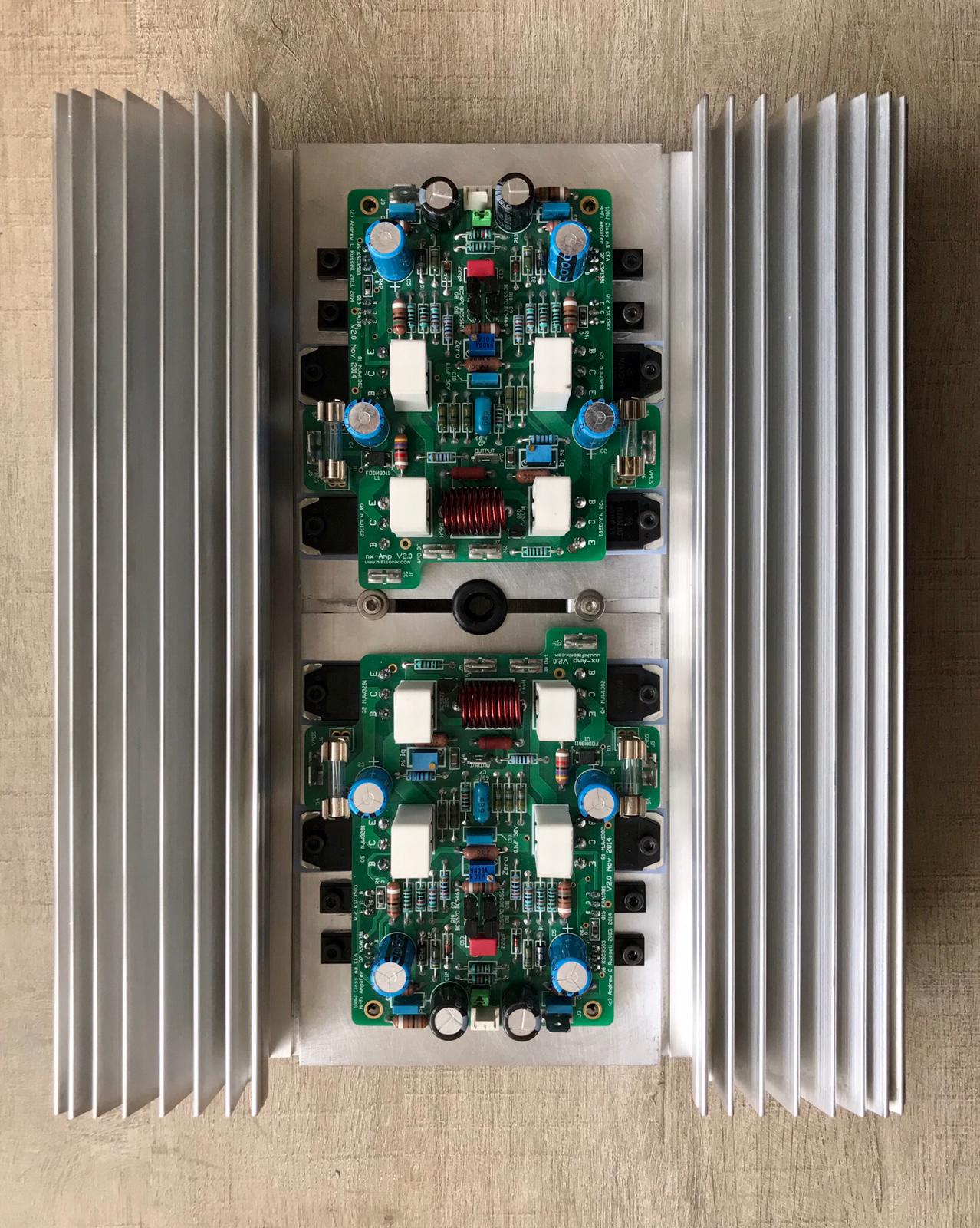

Great that you are still supporting builders Andrew / Bonsai! Quite a while ago that I have been here. Unfortunately I have not had much time to spare. A few weeks ago I came across the boards again. Some progress, pasito a pasito as our Latam friends say 😉.
The idea is to make a relatively compact build in terms of height. It was not easy to find a proper heatsink for that, so I fabricated something instead. Those radiators were actually spares for the KSA-100 clone 🙂 Normally air is forced through them for optimal convection, but I expect this will be sufficient. A bonus is that it provides a nice shield for the cables, as I could route them underneath. The whole unit weighs more or less 3.5 kg.

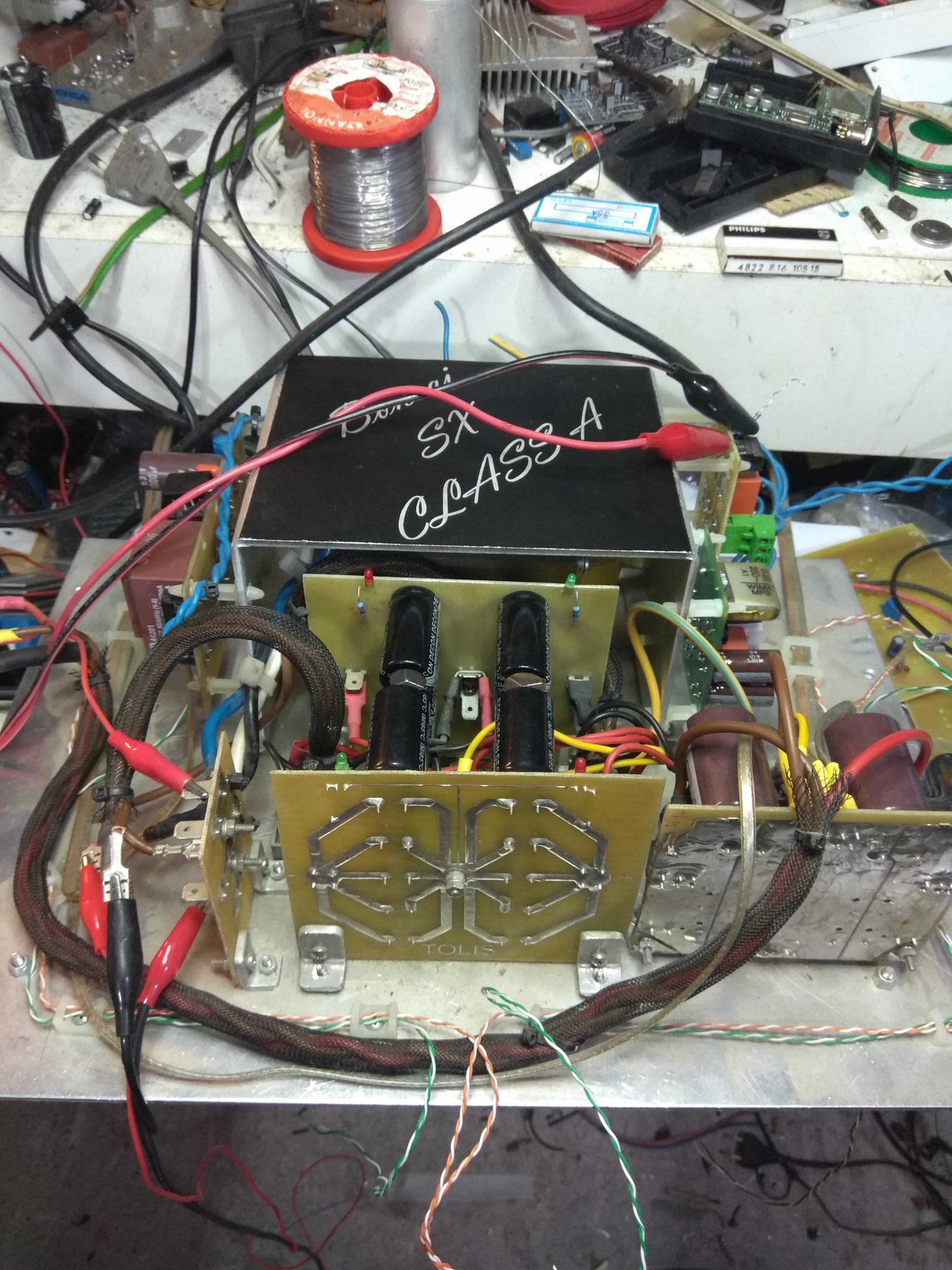

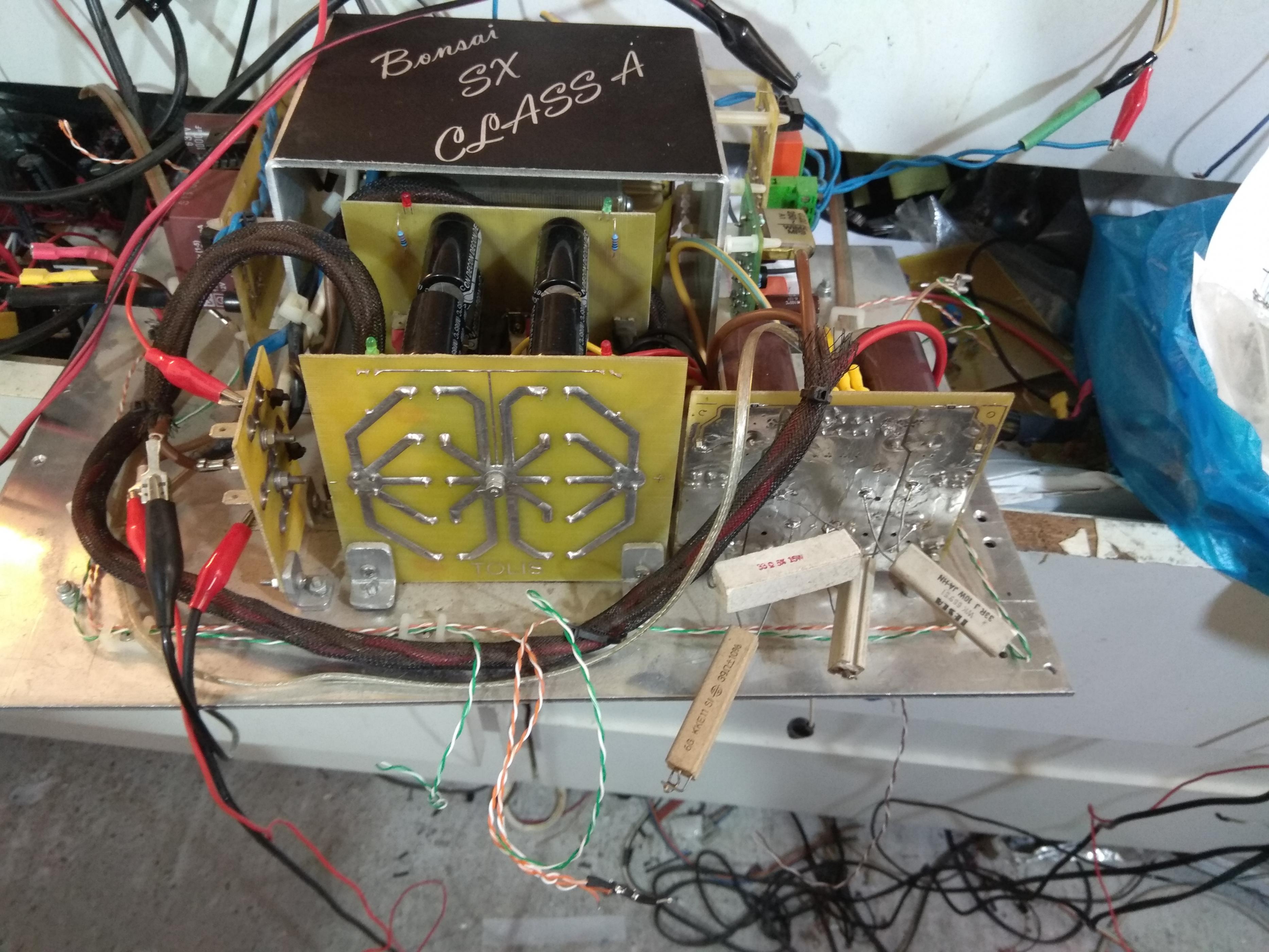

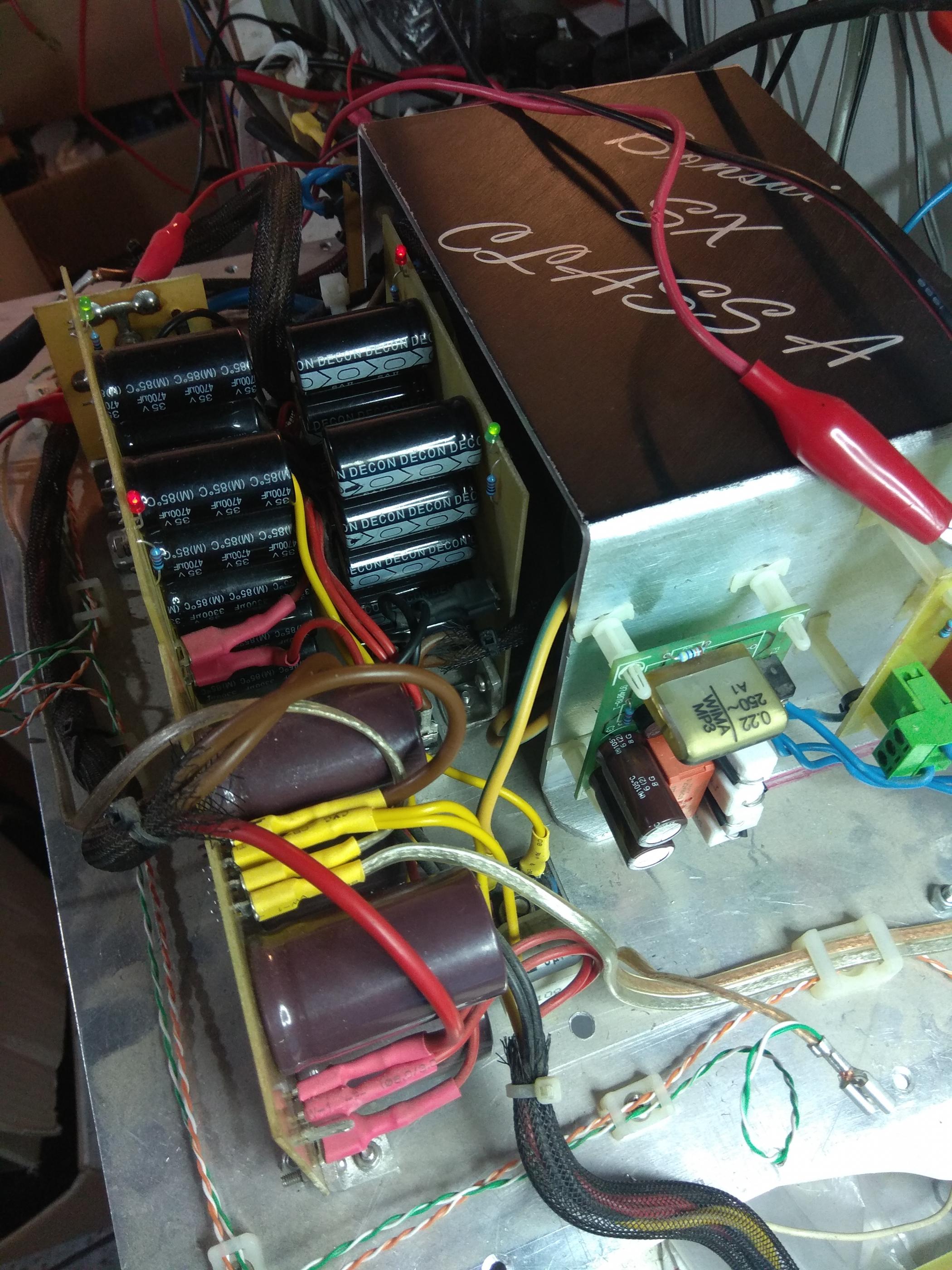

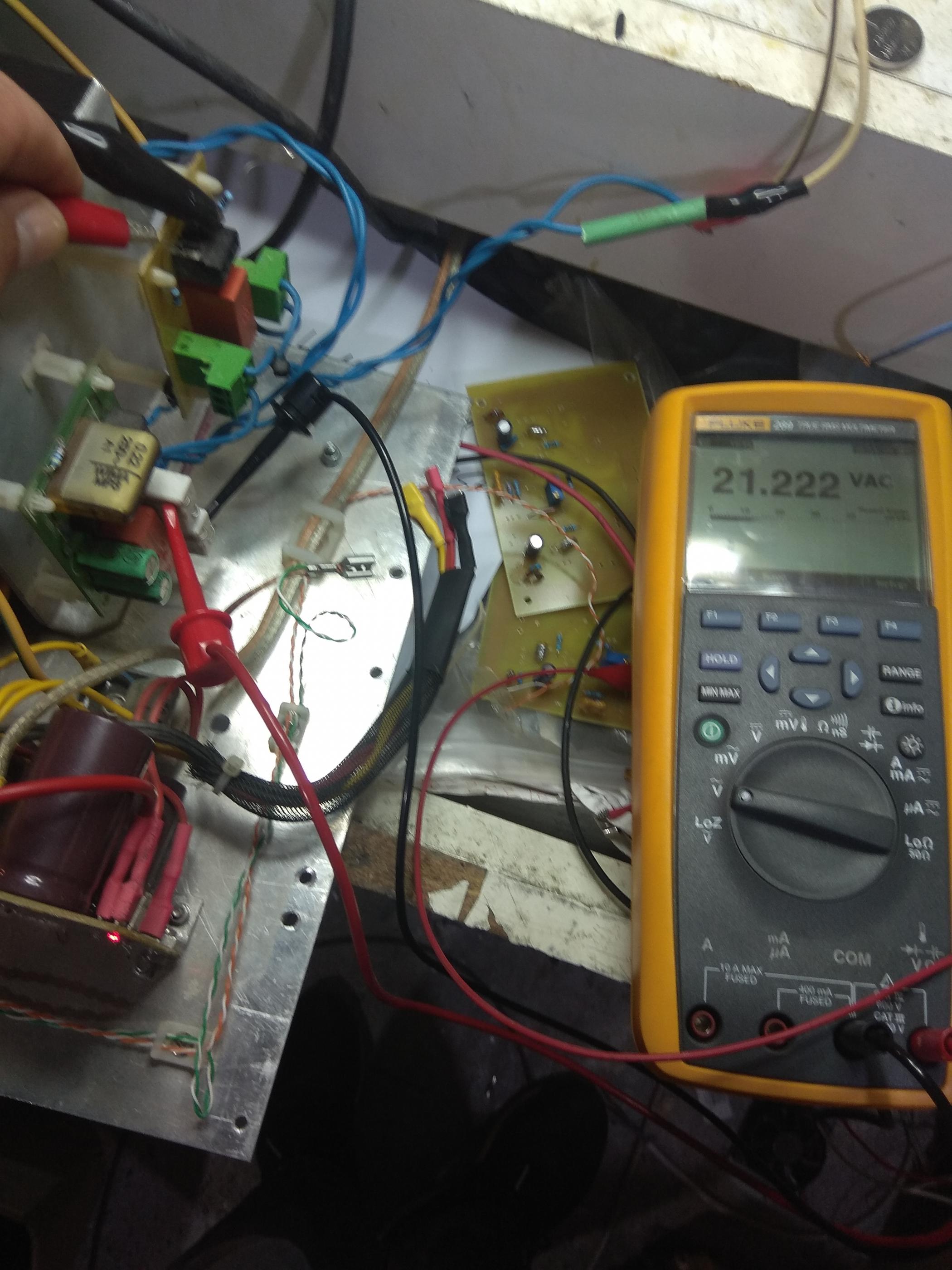

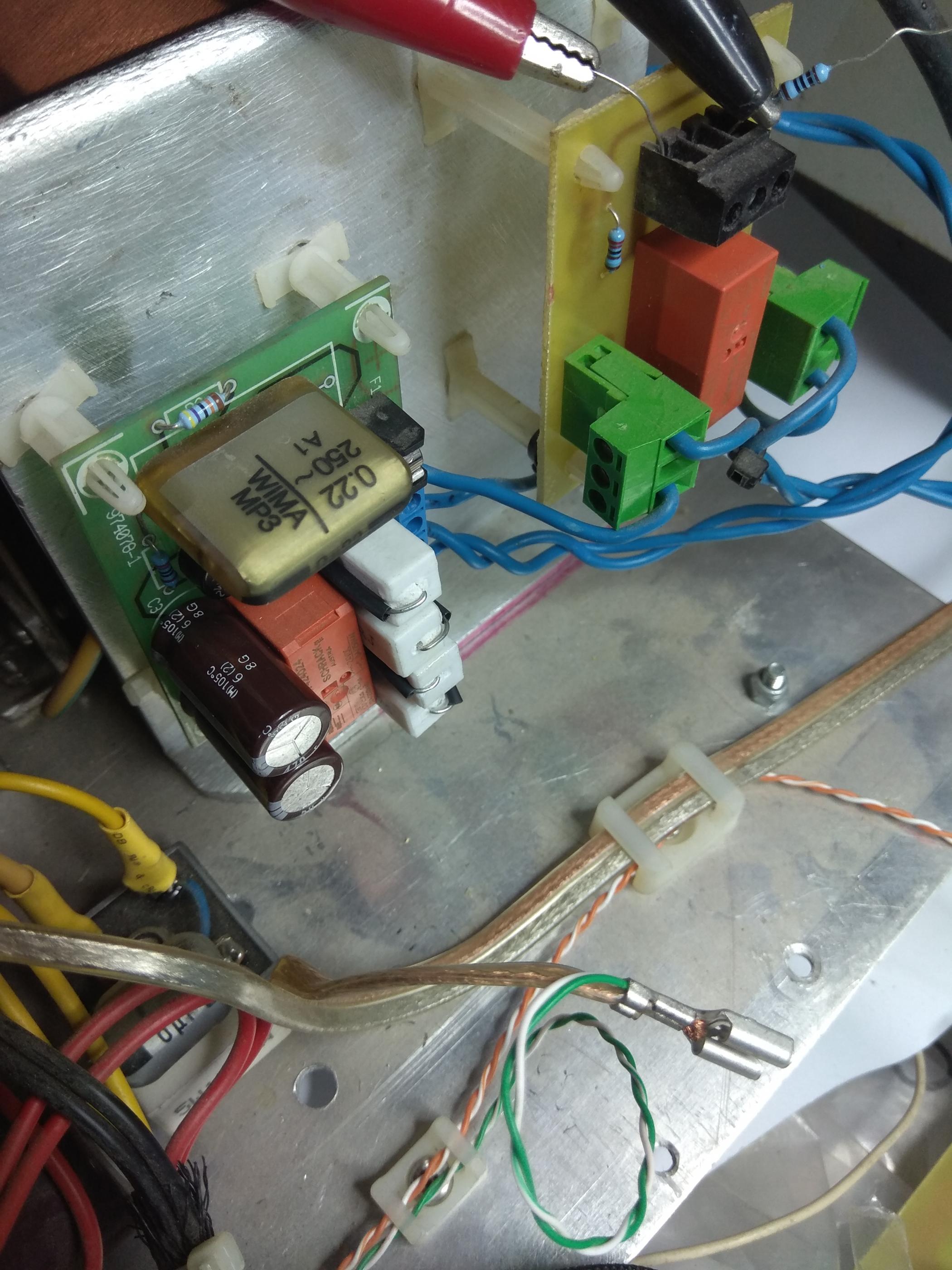

Service to SX amplifier
Last two days i have problem with periodically burning fuses in the primary side of transformer in my SX amplifier.
I have used 2A slow blow and a soft start with 5x10ohm/5w.
My caps bank is 67.000uf/ rail.
I haven't any problem up to now.
I'm sure that problem is at the power supply because keep blowing fuses periodically without any load.
Not sure what happen i manage to increase the soft start resistors to 5x 22ohm(88ohm).
Measured primary side current is 400mA at the moment of power on when no load in the secondary side,just caps bank.
A. C Voltage drop on soft start resistors is 20v RMS, time before full start is about 2 sec.
Fuses are new old stock Philips.
Your opinion please.
Is it necessary to increase the soft start resistors or time further?
Given the fact that transformer is about 800 VA and the caps bank is 67000uf /rail is the 2A Fuse suitable?

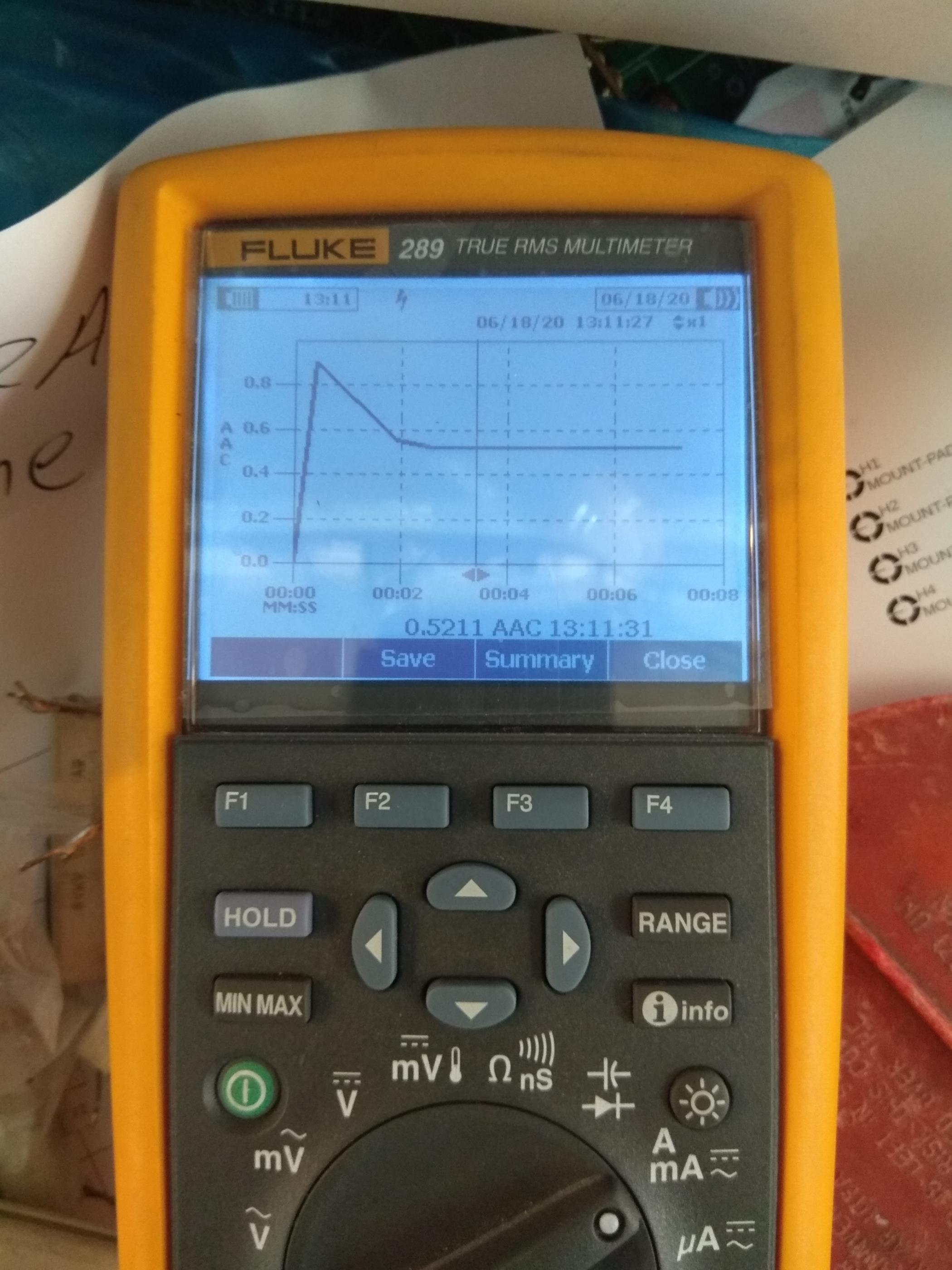

Hi Bonsai, thanks for answer!
Main voltage is about 225v.
Current at transformer primary side, when secondary is open circuit, is about 200mA.
Fuse body marked as T2A/250v.
Is from the same box that i used up to now in this position.
Another transformer measured for comparision, same things, current at the primary coil, when secondary is open circuit, is about 200mA.
Both transformer are salvaged from UPS.
Same dimensions, different manufacturers.

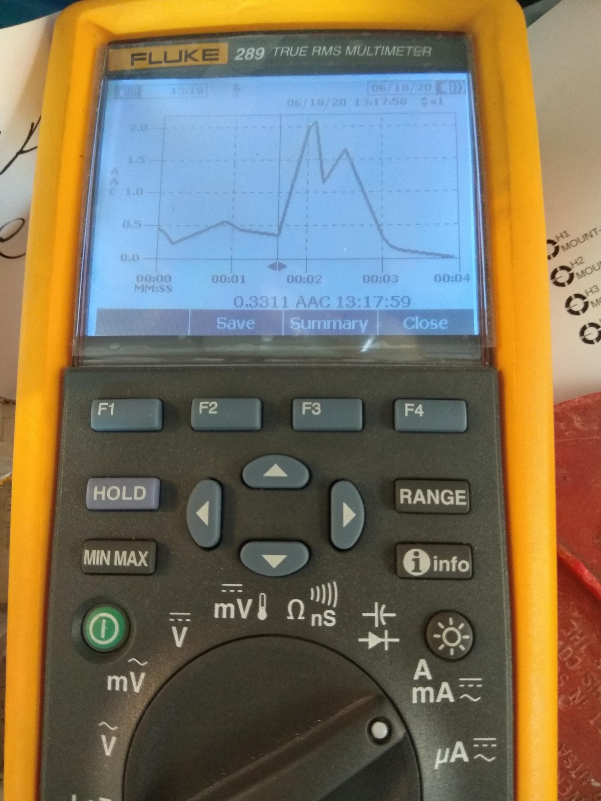

PS. Start current (caps bank+16R load) is most times 0,8-1A.See below.
Picture in post #2436, 2 A captured when playing with the power switch quickly. On-off-on-off, on.
That’s a very high primary current with the secondary’s open circuit Thimios.
Does the fuse only blow if you have the secondary’s connected to the power supply?
Note that the inrush current of the transformer itself (not related to cap charge) can be many tens of amps if you catch it at the wrong time on the mains cycle at switch on.
In an ideal transformer with open secondary’s after the switch on inrush current of the transformer, the current draw Should be 10-20 mA.
