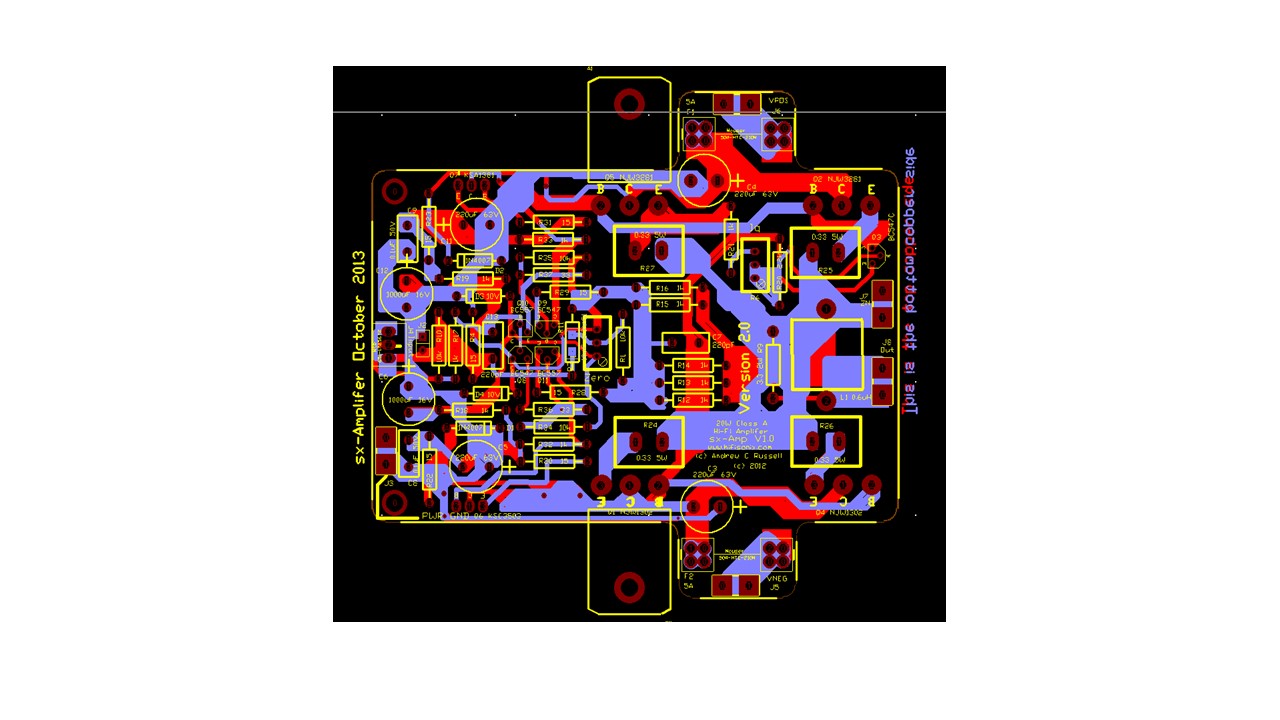

Does anyone know the exact dimensions of the double-sided pcb for the SX-amplifier ?
(I mean the PCBs sold by JIMS Audio)

the Jim's Audio sx-Amp PCB's measure 100 mm x 97 mm
Thanks !
I believe these are the maximum dimensions.
Is that correct ?
No. The dimensions above are for the PCB only.
If you include the distance that the power transistors stick out from under the PCB then the worst case dimensions are 100 x 110 (includes 'side wings')
I just added the power transistor outlines below to show what I mean.

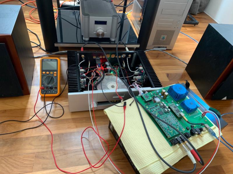

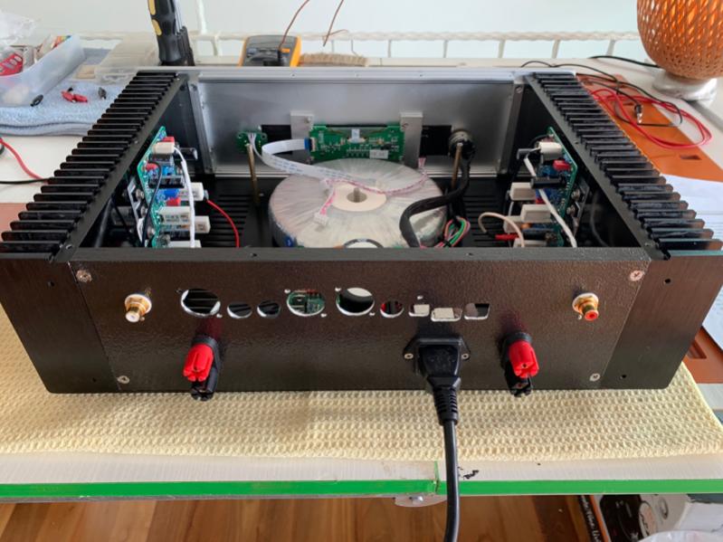

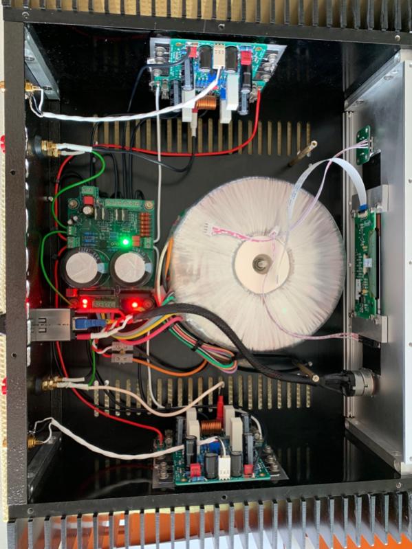

Dear all,
I was planning to start once again with finishing the SX Ovation amplifier in a chassis.
The soldering was finished a while ago but I had to take courage to start the set-up of the PSU and the tuning of the amplifier.
I had already started reading this section a few times but I couldn't figure it out and unfortunately I still don't do that, so I ask for advice again
So I started to check and test the PSU with a transformer. Everything seems to work and I have 21.3 V at the output. So far it seems good. But now I want to continue but I don't quite understand what to do with the fine-tuning for the amplifiers.
I now get no further than setting the R6 to +/- 0 ohm.
Amplifier Module tests: some questions
Point 4: Do I have to place a temporary 1A fuse(s) on the V-/V+ or will it be permanently in the circuit?
Number 7: Then set the Multimeter on 2A . I measure with the black / red pin to between the V + fuses from the UPS and the amplifier?
With 300-400mA as result and then set R6 on 1.4A.
Number 12: I don't understand anymore because again a 1A fuse is placed here.
(or is this part for tuning the second amplifier?)
Point 15: I have printed the circuit diagram and see the different values that are measured in red.
But how do I measure this with the Multimeter?
Simply left / right of the indicated resistor (s) with both pins of the Multimeter.
Or in another way?
For example, the + 150mV to be measured between Q9 and Q11, I certainly do not understand how to measure.
And what about the mentioned in Testing and set-up start text: 4x 5A 5x20 fuses?
These are already placed into the both amplifiers?
I have too little experience in this and I am afraid to make a short circuit with a measurement attempt with the Multimeter
Dear people, I hope you can help me through this last tricky part because the rest of the finishing is not so difficult and great fun to do.
With kind regards,
Frits
