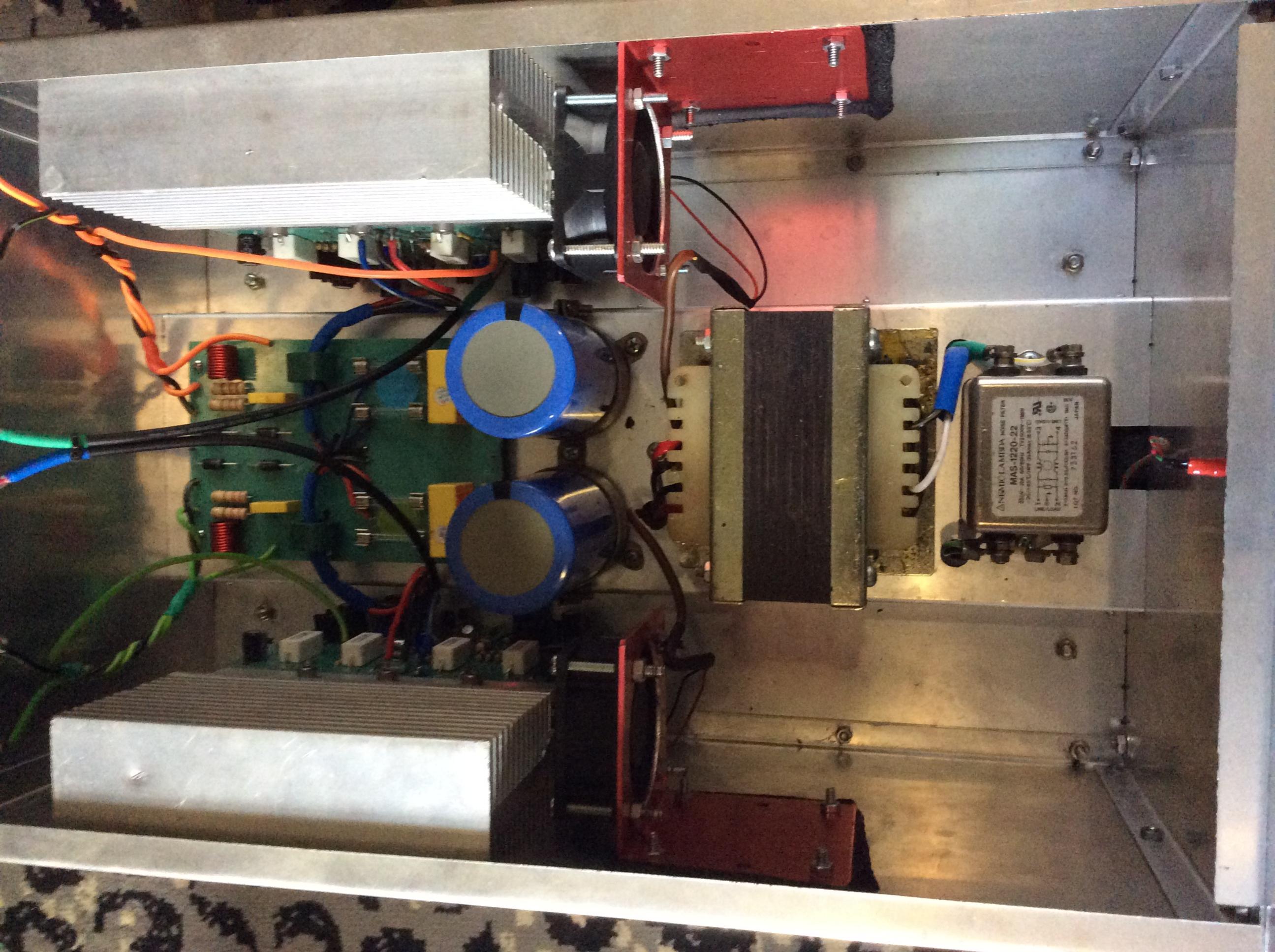

I got a technician build me an SX-Amp. Two things I thought he deviated from what I asked which is to stick faithfully to the specs as documented. First he skimp on the heatsink, substandard for what is “substantial” hence he installed fans which are noisy & annoying. Second, he did not use the specd power transistors and used instead 2SC5200/2SA1943, BD139/Bd140 in lieu of KSA1381/KSC3503.
While I can have him replace the current heatsink with beefy ones to get rid of the fans, I am however not sure if the substituted transistors had any effect with SQ. The sound I’m getting with the finished unit is, with lack of better words to use, mechanical and thin compared to a Hiraga 20W which I also have. The Hiraga have more body (voice & instruments) and more engaging. The SX-amp is biased at 1.1A at a rail voltage of 22Vdc.
So may I ask those who have experience comparing w/ different power trans specific to the SX if the transistors mentioned above have large impact on the SQ and replacing them with design specd would improve the SQ, or what I’m hearing from the SX now is how it really sounds. My first time hearing an SX.
Would appreciate any comment. Thanks.

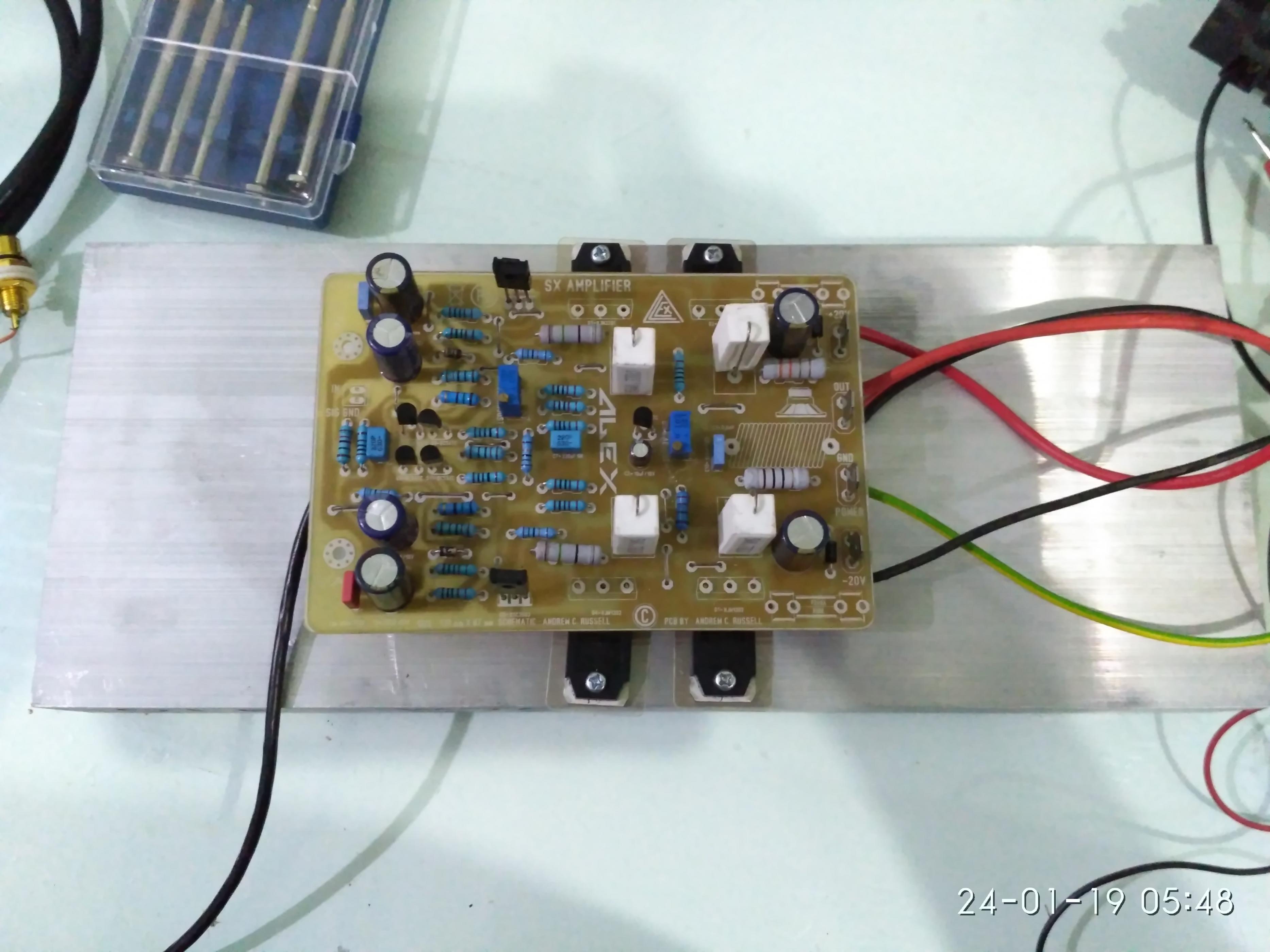

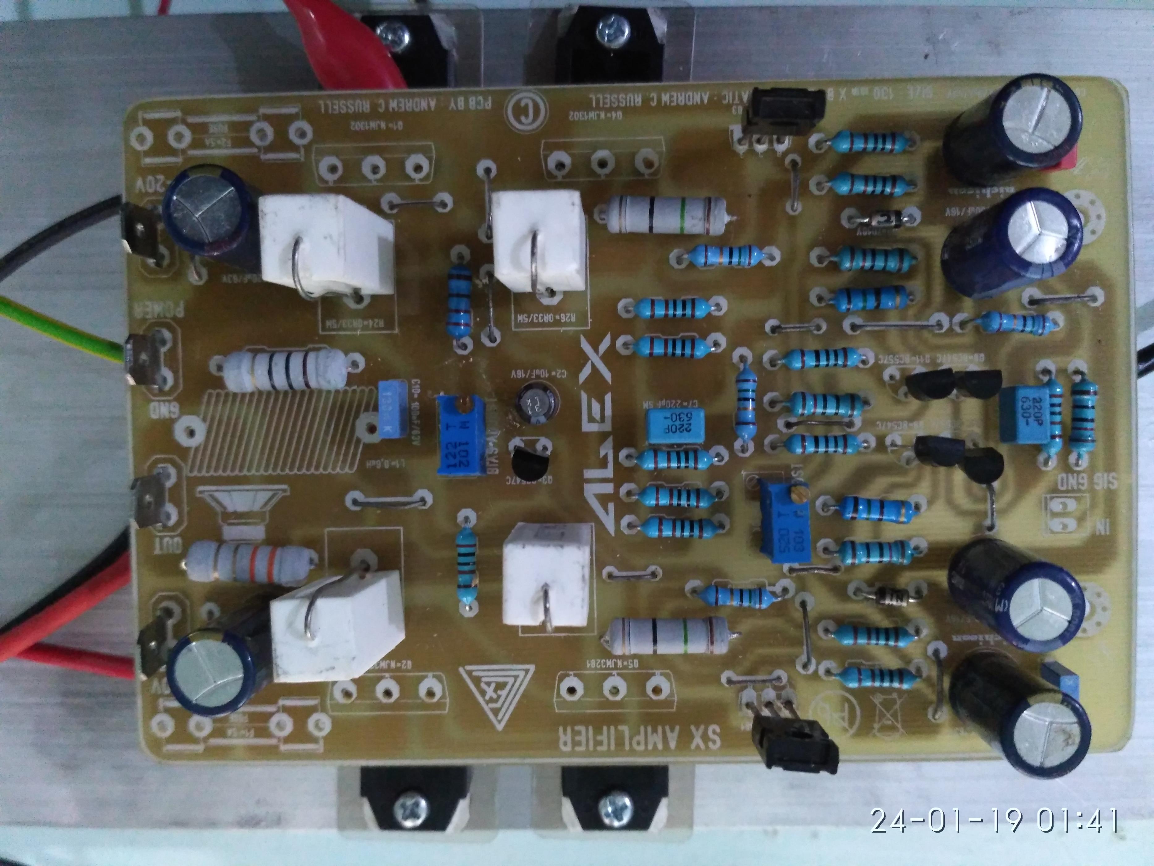

That is way, way too small I am afraid. You are using a sheet of aluminum which will have s very high K/Watt figure. The amp will get thermal runaway like that.
Your heat sink should weigh about 1.5 kgs minimum per channel.
Thank you so much for your advice and very quick response, i have some heatsinks.. that is for trial only, i Will try to get another ones...
I am sorry is it possible to set sx amplifier to be lower bias? What do you suggest voltage read on r 0.33 ohm 5 Watt..
Just my opinion that for trial couple days i am willing to run sx amplifier in lower bias.. then after all ok i Will rise the bias.
Thank you so much
