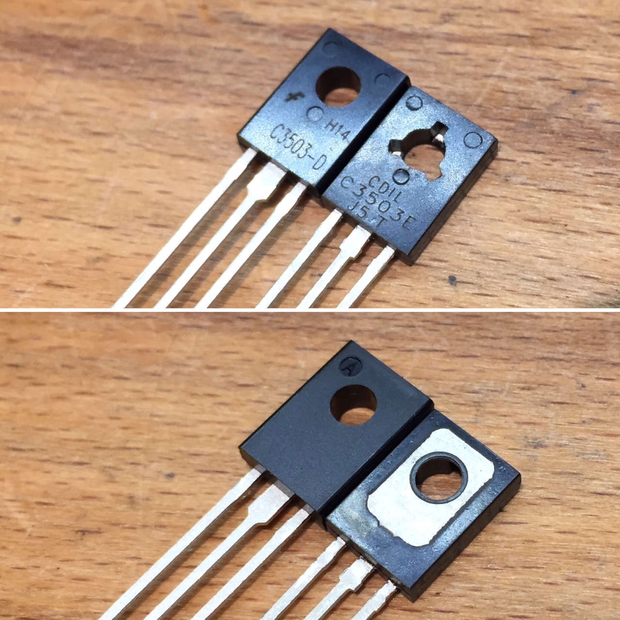

CDIL also makes the SC3503 and SA1381 now, and the ones I just got (from www.reichelt.de) are all "E" bins. So that is good news for amp builders 🙂
some UK based seller via ebay offers matched 3503/1381 pairs F suffix. But alas...no brand. I think these are fake . From Reichelt i got D and E the hfe difference at 30 mA 10 volts is quite high

Yes CDIL = Continental Device India Ltd, who makes a range of transistors (since 1964 they write!), no doubt about that.
But the question at hand here, is whether they in fact make these SA1381 and SC3503, that are now available from Reichelt.de, or if these "new" SA1381 and SC3503 are fake, perhaps re-marked inferior transistors of some other make.
hahfran believes them to be fake, and I am starting to think he might be right, as the "CDIL" TO-126 case is the thin version, as opposed to the Sanyo and Fairchild, that come in a "fatter" TO-126 package :/

P.S.: measurements far away from 2SC3503 and KSC3503. I throw mine into bin.

I believe that these 2SA1381-3503 from Reichelt are fake!

Reichelt says CDIL CSC3503 are genuine
Well the plot thickens, as they say 🙂
I have received a reply from Reichelt.de, and is a quote of the main point:
"We get the SC 3503 from our distributor and only authenticity goods."
They also included CDIL datasheets, which are now also available on the Reichelt product webpage. I have attached them here.
But still:
It does still seem a bit odd though, that the CDIL device is with the uninsulated TO126 package, while the Sanyo and the Fairchild KSC3503, are both in the thicker fully insulated TO126. See attached picture, where the CDIL from Reichelt.de is shown next to a KSC3503 I have from Mouser.
Also, a simple capacitance measurement at 1Khz from Collector to Base, gives very different results:
Fairchild: 135 pF.
CDIL: 1430 pF.
So I don't know, but would like to..
