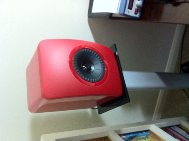

I've been using Q Acoustic 3020's (about £180/$220 a pair) with my sx-Amp for the last 18 months but heard these in a dealer about a year ago and thought Wow!
Anyway, just bought a pair of these little beauts - KEF LS50's.
I listened to Yo-yo Ma and now I'm listening to Bill Frisell - one of my favourite guitarists.
Wow - what a sound. Fantastic imaging and bass is incredible for such a small speaker.
:cool:
