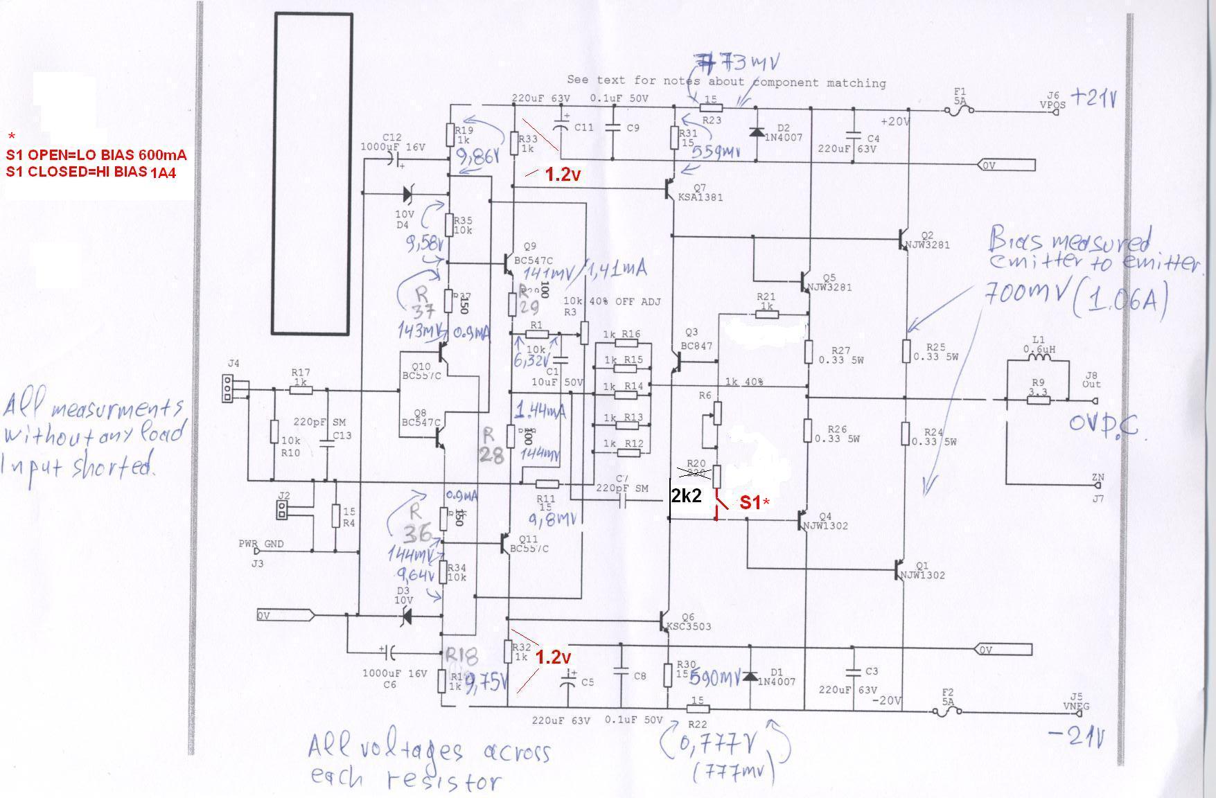

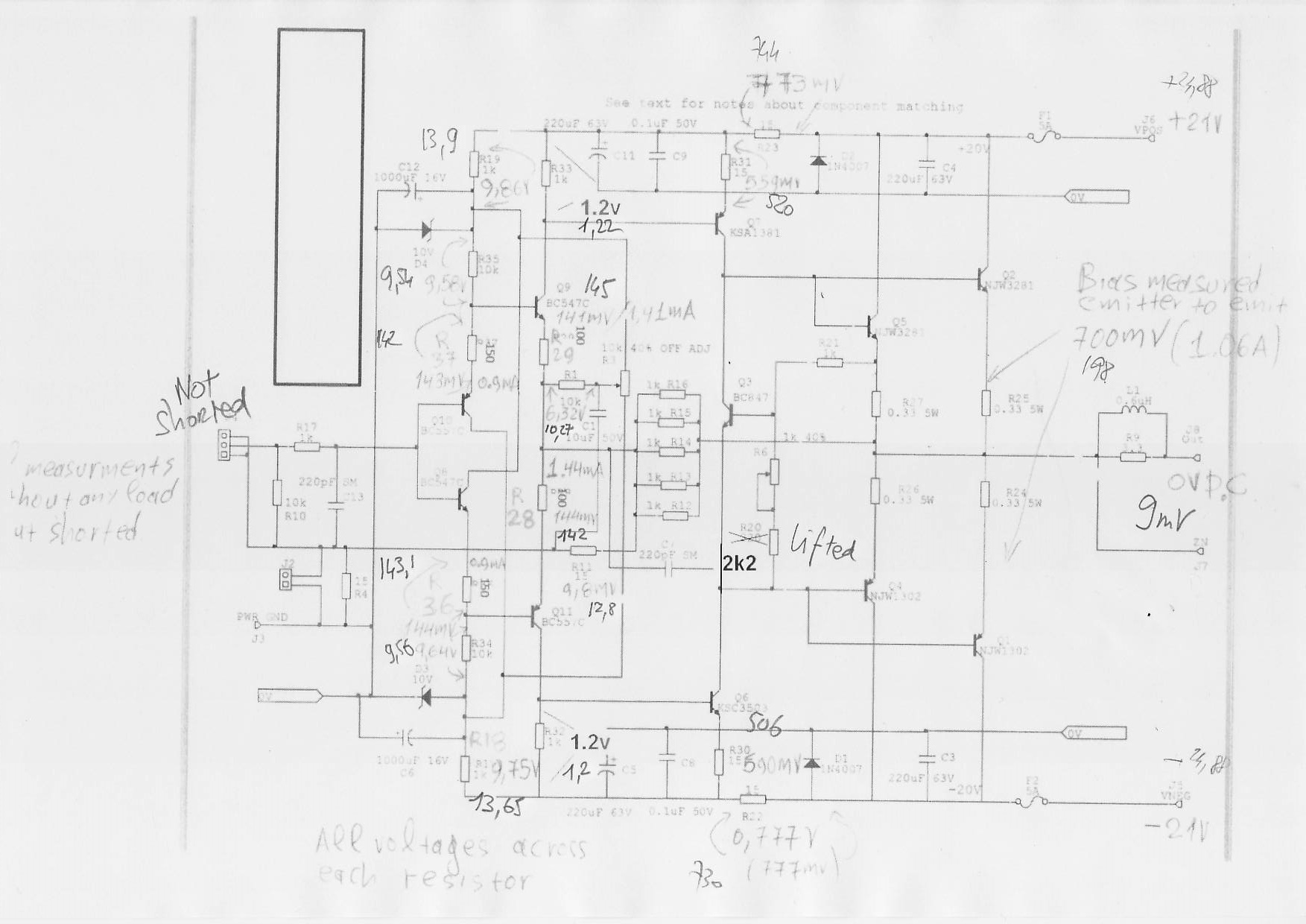

Here are my measurements, in bold on Thimios's ones, with R20 lifted.
Quite similar, except between Q1 and Q2 emitters (and across R18 and R19, which is not suprising owing to the supply voltage difference : 24.9 against 21V).
Despite this bias issue, music is coming through the amp, difficult to assess the quality as mono only and not on the final speakers. Doesn't look distorted. Quite some power available.
No component heating abnormally, even R9 0.5W.

Sadhill,
I looked at your measurements - they are all ok.
Can you con firm the transistors you used for Q8, Q9 Q10 and Q11.
Only thing I can think of is that there is a big difference in the Vbe on one or two of these devices and/or there is a big hfe difference.
In any case, if you do not want to match these, you can reduce R1 to 5.6k or 4.7k.
BTW, on my sx-Amp, I has put a switch in series with the 2.2k so I can switch between Lo class A (about 600mA total bias) to Hi class A (normal 1.4A total bias).

Bonsai,
Q8Q9 are BC550c, Q10Q11 are BC560c. They have all been paired for Hfe and Vbe within your tolerances... (I bought 200 of each !)
The same for the TIS
If I understand well, changing R1 will result in ability to achieve 0mV offset, but not to reconnect R20 ?
What about increasing slightly R20 ?

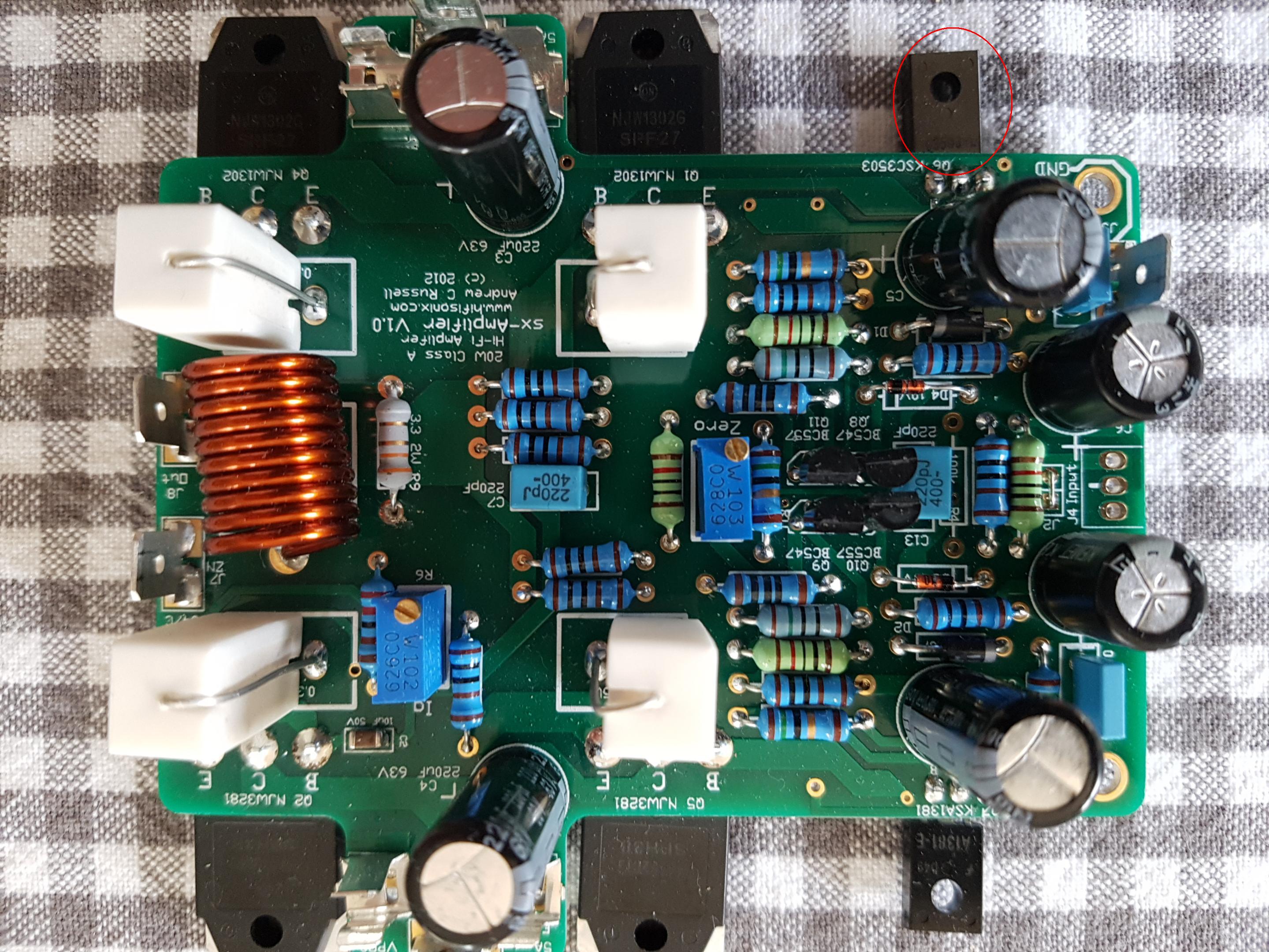

Hi Bonsai,is this what you speak about?
I have also A1381 and C3503 from Mouser, but they are not the same grade (E and D), that's why I did not use them. I could try to change for them, but only if there is a good reason to do so...
Could something have been damaged during the very first trial with R6 adjusted to minimum, when all the fuses have blown up (1A fuse in the negative, the DVM 10A fuse in the positive rail)?
I have used mixed E&D grade many times without problem.
After the accident you must check some parts like output trans.but if my mind serve well you speak about a working amplifier.
I have just made trials with various R20 values (with R6 maximum and 26V supply voltage) :
2.2k : blows fuses
3.2k : 1.8A
4.2k : 1.53A
5.2k : 1.3A
6.2k : 1.27A
So my problem might be considered solved with 5.2k or 6.2k (it looks as if there is not much point going higher with R20, as there is not much diffference with these 2 values)
Yes.
I am surprised at your very high readings Sadhill.
I am looking at the VAS transistor in the top left hand side of your picture - is it the right way up because I can see no logo on it - is it not upside down?
Please check and make sure R6 and R21 are also the correct values. Also, if the bias control transistor was faulty (e.g. fake) you would have issues. I am going to open my sx-amp now and check it.

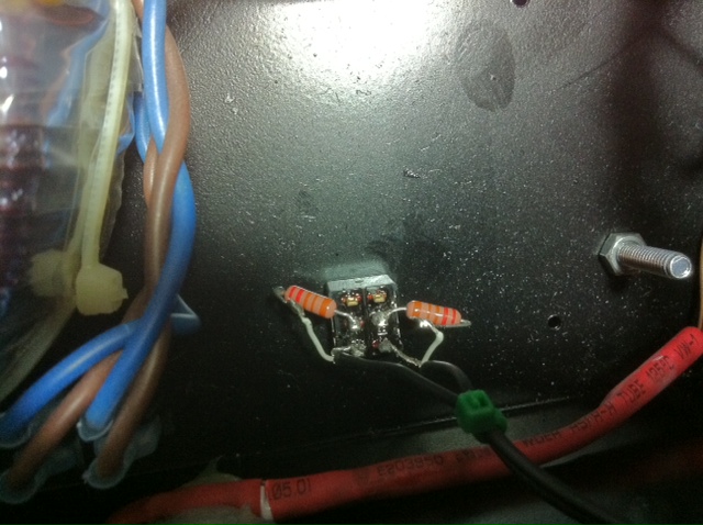

I am definitely using 2.2k for R20 - the resistors are on the 'Hi/Lo' bias setting switch which is mounted on the bottom plate of the amp.
On the PCB, I have 12k where the 2.2k used to be - so the total actual resistance for R20 when the switch is closed is a bit over 2k Ohms.
You definitely have a problem Sadhill - with 2.2k you should not blow any fuses
