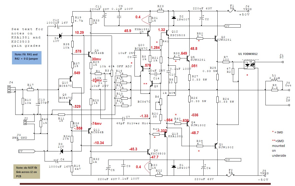

For D15 ( NX) is this Mouser 941-C566CRFNCTT0W0BB3 used special reason for that?
D15 is just an indicator LED. You can use any LED you want - I chose a green LED because to me a red LED indicates a fault.
schematic question
I have a small question. The attached schematics are a bit different at input. I mean around the input signal ground via 15 ohm resistor & J2. Which one is latest?
Farooq
Farooq
Farooq, the write up on the website is the latest version and matches the PCB. Just download that and use it.

Hello RC,
I use a FODM3053 random phase triac with the LED connected across a emitter sense resistor pair with a low resistor value divider. For an amp of c. 180-200 Watts the values are 100 Ohms in series with the coupler emitter LED and 47 Ohms across the emitter LED.
If the current exceeds the pre-set level, the triac tiggers (note: you must use only a random phase triac driver) and I use that to switch off a solid state relay via a Vishay VOM1271 photo-diode coupler. Do not use a standard relay because they generally cannot handle the kind of fault currents you will see if you short the speaker outputs on a big amp and they are also too slow for this technique.
I measured the response time from short circuit to solid state relay disabled (i.e OFF) of 100 uS on a 60A peak current on a new design amp. On the e-amp the figure is ~40 A peak before it trips.
I notice your amp does not have degeneration resistors (mosfet OPS). In that case you could sense the current in each rail and then drive some sort of latching circuit which in turn would drive the VOM1271.
Note that this type of protection latches the speaker relay OFF. You have to power down so that everything resets but I consider this a good thing in the case of an overcurrent condition.
I can drive my amps to full power, short the output and the solid state relay trips. I power down the amp and let it reset, power up and it works fine. The 10A slo-blo fuses in the rails are there purely for cases where there is a gross failure to prevent a fire hazard. They do not blow when I do the test I just described since the protection is much faster.
One final point, to test the current trip, load the amp OP with a 0.5 Ohm resistor in series with a 0.1 ohm current monitoring resistor. Feed the amp with a 1:10 pulse train with an ON time of 10ms. Monitor the OP current with a scope and adjust the lower divider resistor across the random phase triac until it trips at your desired peak output current

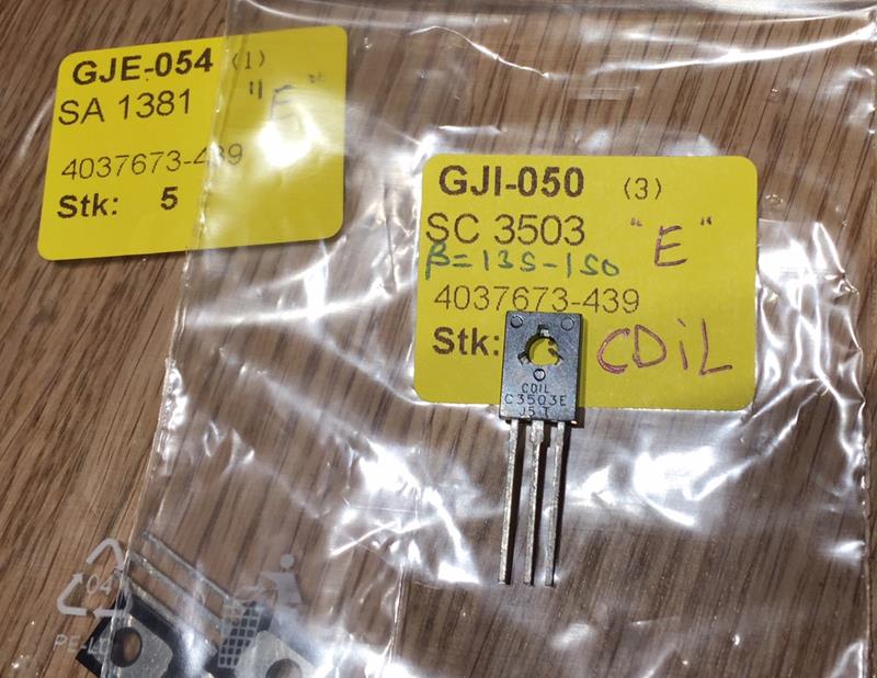

CDIL also makes the SC3503 and SA1381 now, and the ones I just got (from www.reichelt.de) are all "E" bins. So that is good news for amp builders 🙂
I only bought 5 pcs each, just to verify if they were D or E, so it is a very small sample, but it looks pretty good so far: hFE 135-150, with most of them very close to 150. The KSA1381E I have from Mouser are all 146.

Hi, can anyone tell me where I can obtain KSC3503 and KSA1381 with the same suffix for HFE in the UK.
I can get KSC3503D and KSA1381E easily but cannot find pairs with the same Hfe band. Bonsai has mentioned that they should be the same,
