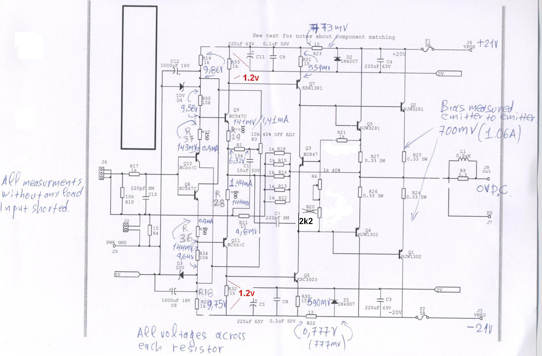

R6 is 1k (and this is the value I used when I got I=634mA)
R20 is 2.2k (actually 2.19k)
R21 is 1k (actually 0.997k)
I checked Q11, it seems to be ok (without desoldering). 0.33 resistors are ok too (I saw in earlier posts they had to be checked, but that concerned Nx version)

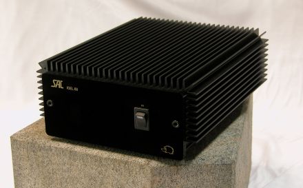

My job is to build an amp that fits into the case see pic... which is very small and serves as the heatsink. My wife loves the design and so...
but due to heatsink size the original amp which gains really moon prices at ebay is rated 40 watts and they used to die on excess temp.
So how to scale the nx down to say +- 28 to 33 Volts does it make sense?
Further there is space for one pair of power BJTs i would use Thermal track NJL4281 / NJL4302 which i think have the same chip as your NJW3281 ....types

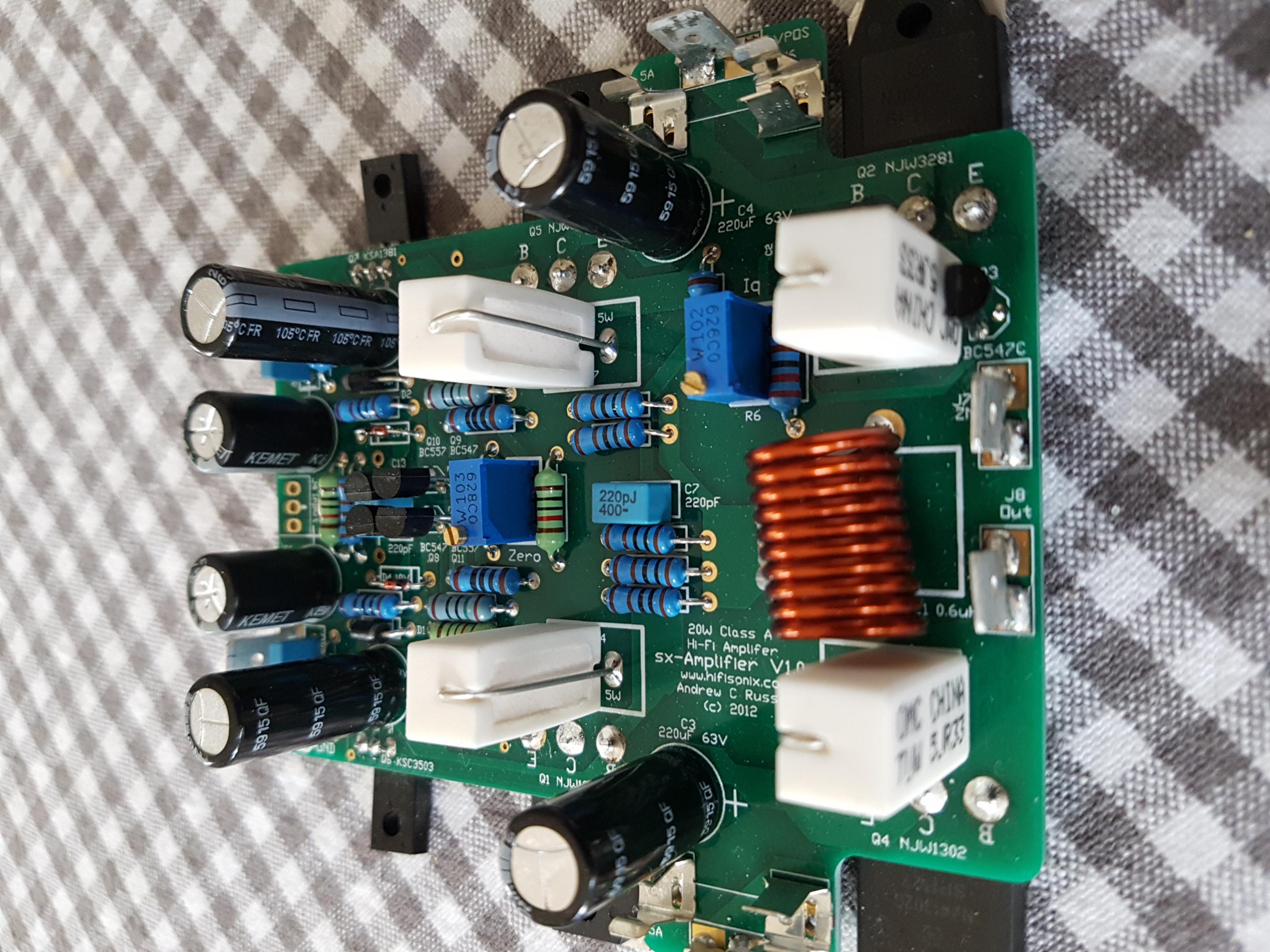

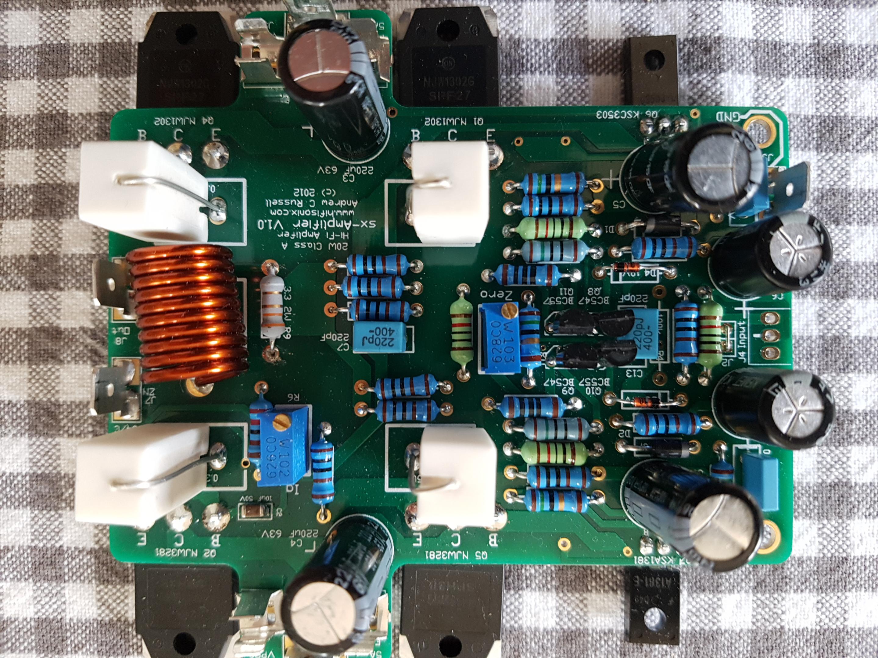

Here are my measurements (with R20 removed as advised), Vpos=Vneg=+/-25V,
I vpos=650mA :
Across R37 : 143mV
Across R36 : 143mV
Zeners 10.3 and -10.3V
Q9 emitter 129mV
Q11 emitter : -156mV
Across R33 : 1.22V
Across R32 : 1.2V
Across R25+R24 : 211mV
Between out and Gnd : 27mV (no way to go lower with R1 adjustment)
