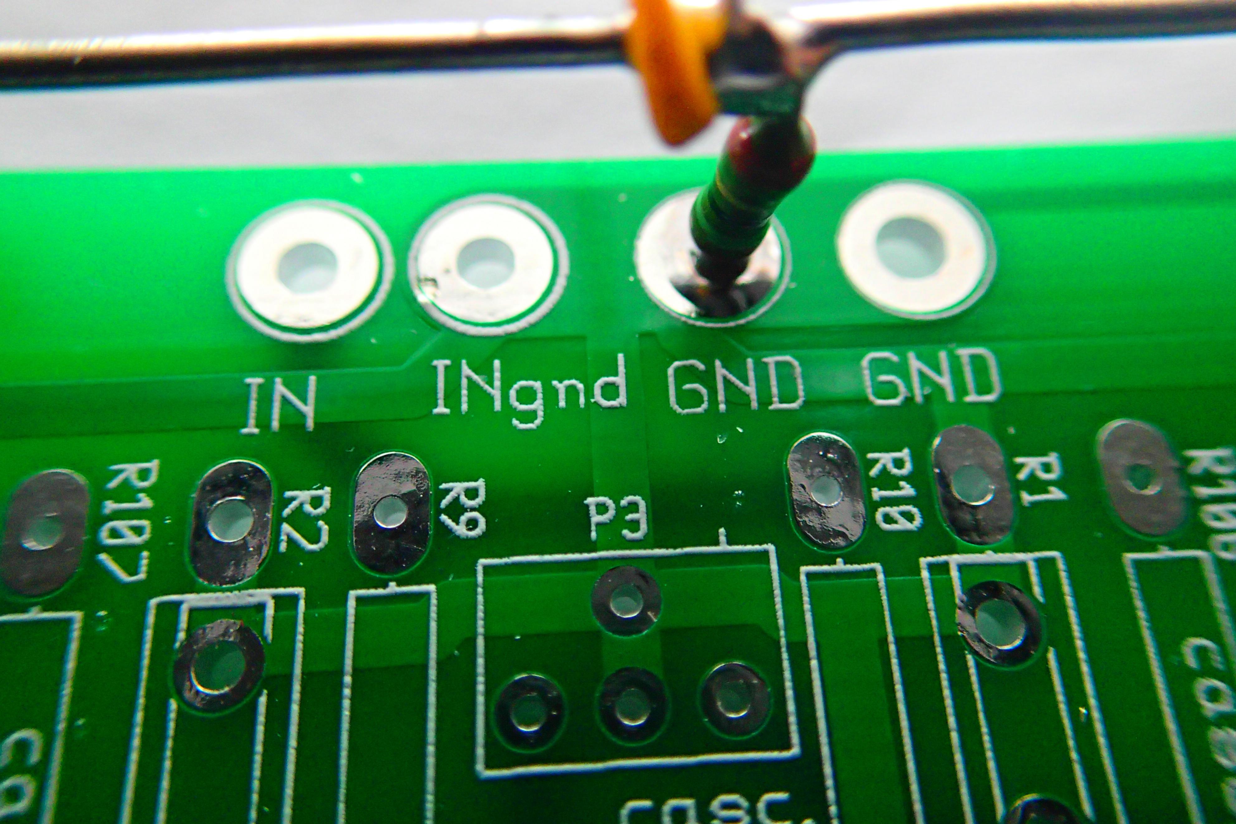

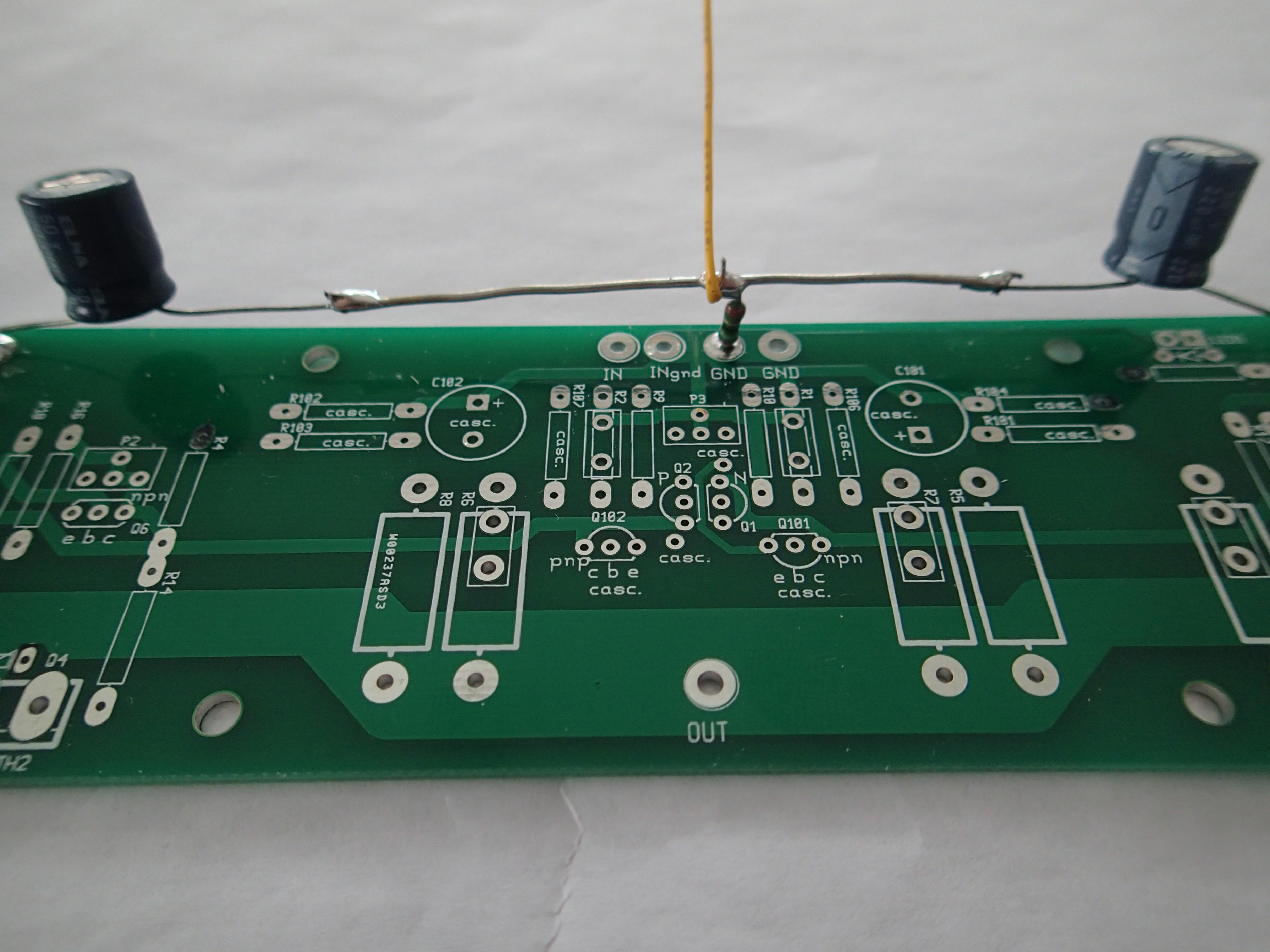

Eivind,
From what I can see, I don't think your proposal is going to work like that.
You need to lift the signal ground i.e. INgnd via a 15-22 ohm resistor in order to break any ground loops.
Its important also to know whether or not the INgnd has only signal return connections on the PCB. If not, you could have problems.
Can you post up the schematic for your amplifier?
Ingnd and out GND share the same pad and are directly connected. I was "afraid" that this is the reason why your very clear schema how to connect two amplifires pcb does not fit in with the way cvillers pcb is lay out.

The four capacitors C1, 2, 5 & 6 come together to form the decoupling ground. This then becomes the Power Ground. If you are building a monoblock, then this can also be the Main Audio Ground from which all other voltage references can be taken.
R2 and R3/4 are Signal Return. These need a voltage reference to the Main Audio Ground. This voltage reference passes nearly zero current and passes interference current. A bit of resistance in this near zero current link does no harm.
But it is worth checking that there is no DC current flowing along this link. A DC voltage error here will increase the output offset.
If you add some resistance between Signal Return and Main Audio Ground, then you must also add in a mains fault current route to bypass that added resistance. This bypass takes fault current appearing on the input sockets to chassis and thence to PE. It would be this route that would blow the fuse in a faulty source component that does not have a working PE.

Here is the link showing how to wire your amp boards up to the main power supply. Note carefully how the wires are twisted and also how to 'T' off the filter capacitor 0V connection to avoid hum. Note, you may not need the ground lifter (that is the bottom bridge rectifier shown on page 2). I would build your amp without it - only install the ground lifter if you really need it.
For the speaker return wiring, I have shown it on page 2 going directly back to the 'T'. You will get an improvement if you take this back to the amplifier 0V from the speaker return socket and you also twist it with the speaker + output wire. Keep the loop areas small where possible - twisting is a good way to do this.
The diagram on page 2 shows separate rectifiers for each secondary. The scheme still works if you use a single bridge rectifier to simulateously generate the + and - supply voltages
http://hifisonix.com/wordpress/wp-c.../How-to-wire-up-a-Power-Amplifier_Updated.pdf
Here is how you need to connect the input to your amp boards, and how to connect the additional decoupling capacitors:-
