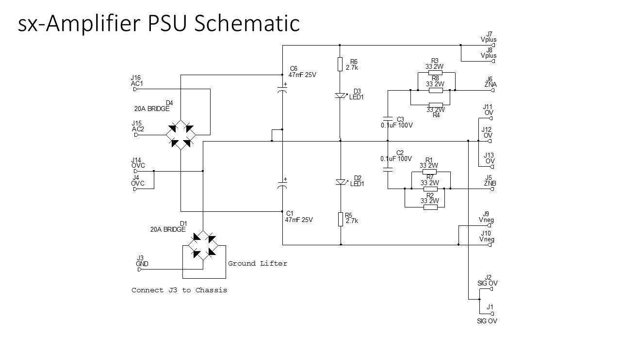

I can't find the power supply circuit diagram (well, I know, it's not very complicated to reconstruct...). "figure 15" on the PDF page 29 appears in black, nothing to read on it... either online or downloaded !
Does anyone have this diagram ?

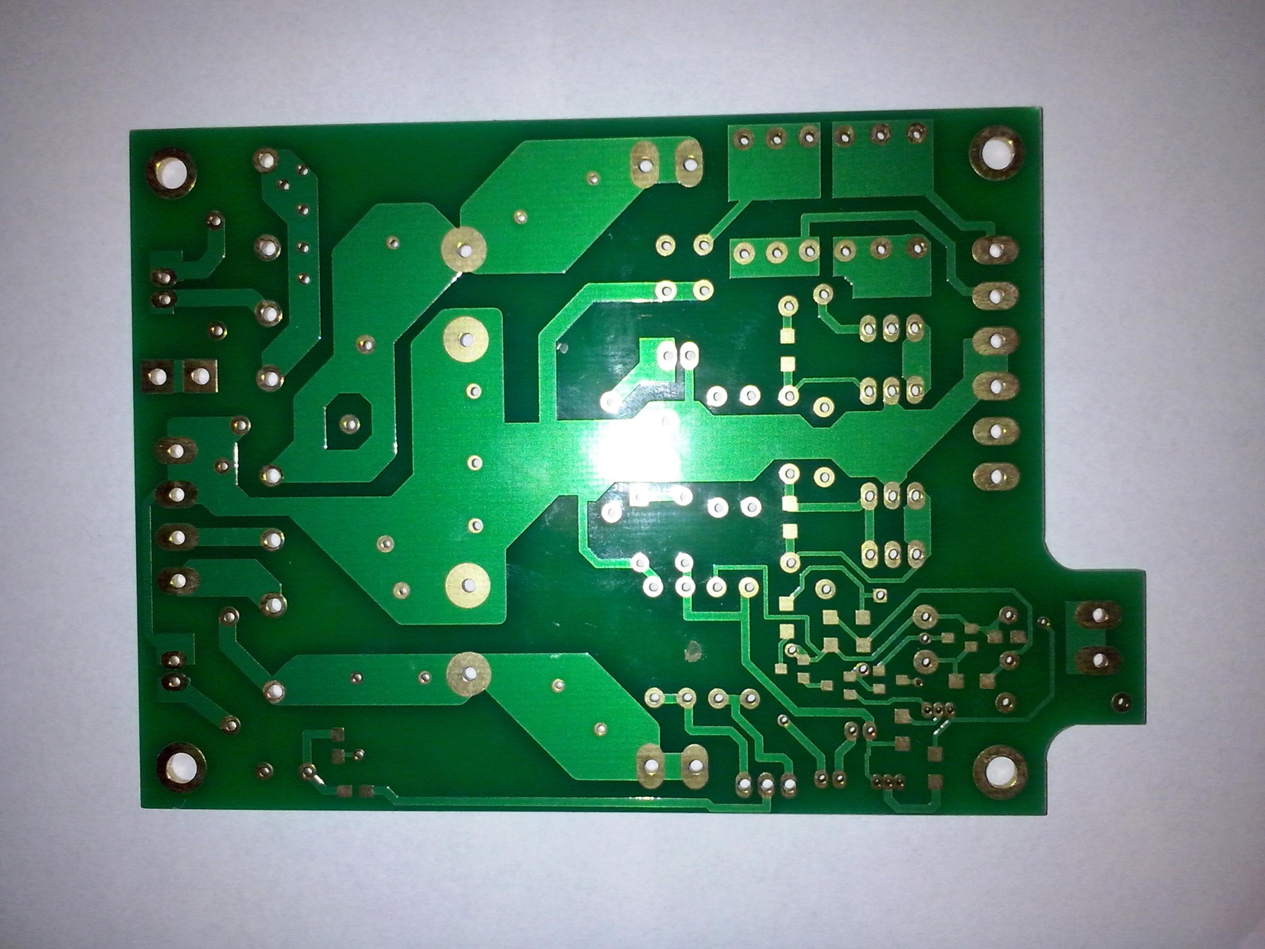

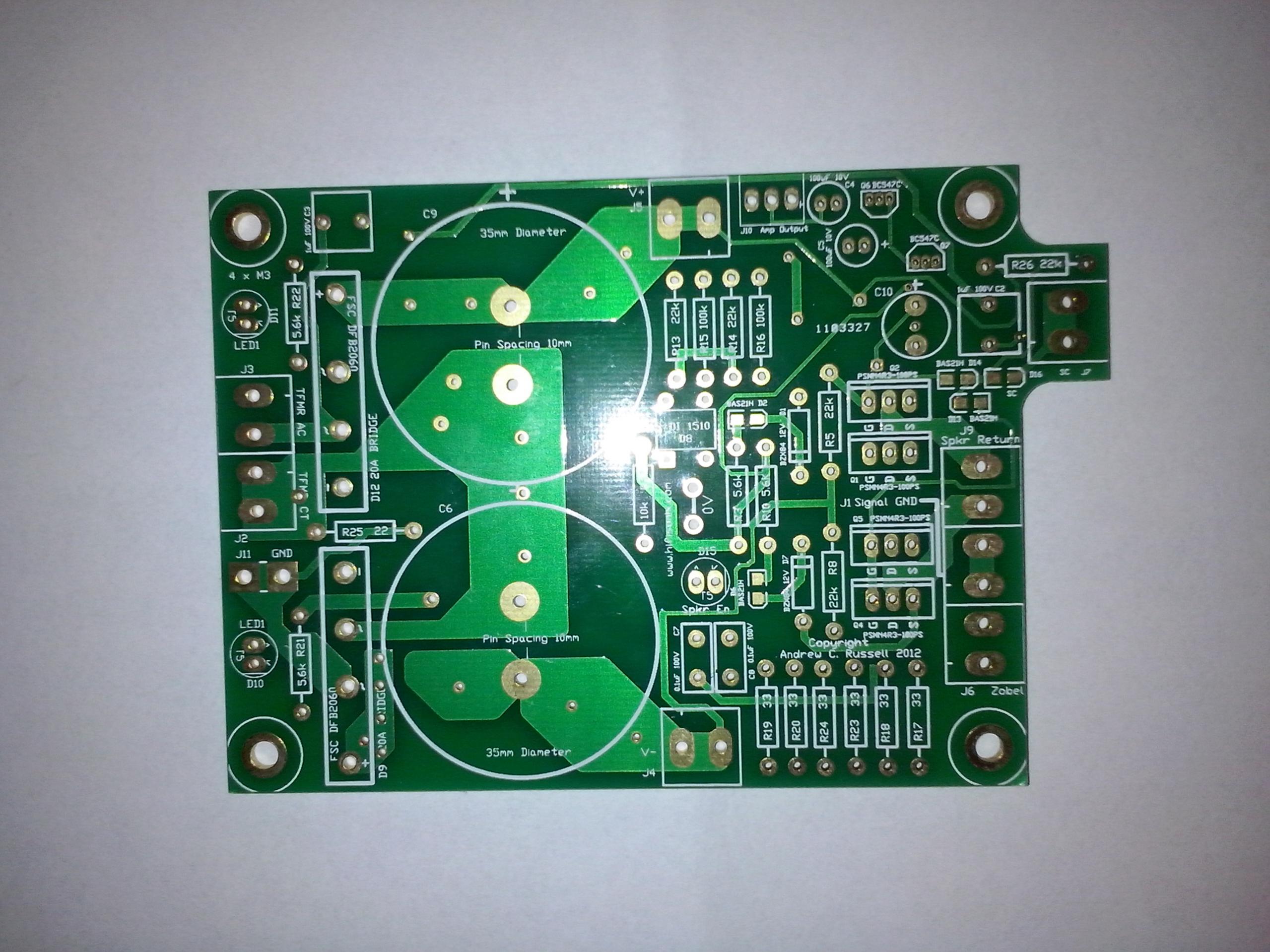

I have the PCB layout in front of me
C4-C5 and C7-C8 - do not fit. Therese were originally placed in parallel with the main filter caps. I decided they serve little purpose - so they were removed from the BOM. The sx-Amp circuit diagram I posted up is therefore correct. I will add a note when I fix the PSU diagram in the write-up.
R4 - this is a 33 Ohm wire wound resistor and is part of the Zobel network (there are 6 of these on the board). That should be fitted. Can you check that designation again, or post up a photograph of the board?
