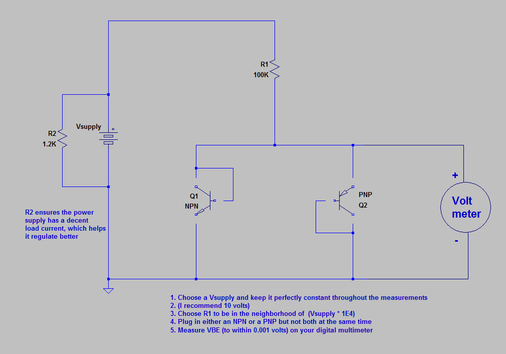

as I don't have experience with this - please could someone give me a steer as to how many BC547 (BC550C) & BC557 (BC560C) transistors to buy in order to 'match'...
I guess this may sound like a daft question - but - I think I understand the idea of what to do, I have never tried this in practice however and am looking for some 'well seasoned' advice if possible!
Again - I understand the idea, and, in the case of these transistors, they certainly are less expensive per unit to buy in order to test between a number of them. How do you achieve this testing in practice please?
Many thanks for any advice Forum 🙂

For Q7 and Q8, match hFE to within 15% and Vbe to within 10 mV - if you can, tighter of course is also always better.

For Q8 through Q11, match hFE to within 5% or better, and Vbe to within 5 mV – in both cases, tighter is better. This is easily done if you buy a bag of these devices and then sort first for hFE, and then after that group by Vbe.
I think we (me and my friend) bought 100 each of BC550C & BC560C and their HFE is all over but could find about 15-20 pairs closely (infact identical) and selected 4 pairs for our boards from the lot. 100 pieces cost ~$6 for each type/. Used DMM to measure HFE and attached circuit to measure bve.
We bought about 20 pairs of TIS transistors (2SA1360 and 2SC3423) from Joshvi (FM on diyaudio) and could match 2pairs to about ~10-11% in hfe. This part is a bit expensive as each of this cost a $ each.. so YMMV, just an indication.
We didnt matched output transistors. Happy with the outcome which is what matters 🙂 🙂

Thanks also for the circuit diagram Rbalu72 - it's really helpful in understanding how and what to do 🙂

Yes rbalu72, this is what I did as reported in post 2135;
http://www.diyaudio.com/forums/solid-state/236522-sx-amp-nx-amp-214.html#post4827348
Except I used the Duoyi tester as it is very quick and easy. The SX amp works perfectly using this procedure.
