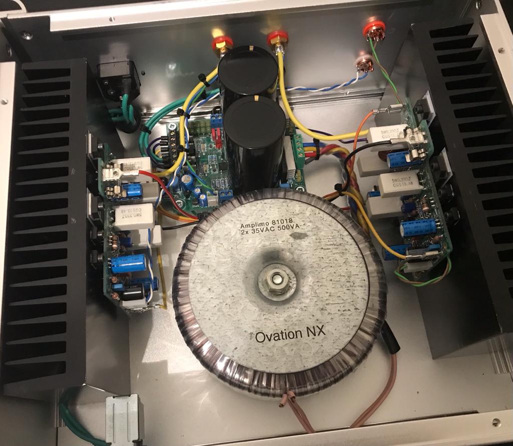

Another silly recommendation, if I was You, I will try to short input on both RCA socket (inside amp) and connect PC via cables you are using and see what happens. If amplifier will not have any oscillation, then you have correct working amplifier, but you have signal injector via your source (PC).
I also had similar problems with another amplifier with wide bandwith and for sure I have to connect both input grounds from input sockets to exclude oscillation.
On your picture where input signal wire passes near the output wires of the amp I can't see how far they are (another part of the path, beside the filter cap and the amp module, you showed on another picture part from socket to the filter cap). Consider that path and put away input wires from the output wires.
Check how long are your power supply GND wires for both channels, I suggest that they are of same thickness and same lenght.
Thanks for your input pibul. Not a silly recommendation/suggestion at all, I appreciate you thinking along a lot! However, I isolated the problem to the amplifier itself.
I can induce the phenomenon by just gently touching the inputs while having a dummy load connected. Basically I inject 50Hz by acting as an antenna. However, at the output I see a sine wave, with no visible harmonics, of more than 200KHz (frequency varies depending on how hard you touch / changing resistance). It happens only when the dummy load is attached (so the amp can dump its energy). It happens with both channels independently. I removed the signal cables to make sure I was not picking up noise (the cables are twisted, but not shielded yet, I will replace that later). However, even with no signal cables attached, and just touching the input on the PCB itself / inducing hum, immediately causes the same effect. It would be logical if the amplified hum signal is 50Hz, but it is somehow transformed. That transformed hum signal causes the Zobel to heat up. The strange thing is, when I apply a sine wave with a signal generator, there is a perfect sinewave at the output of the right frequency. And that till +2MHz. My scope has a limited FFT function, but no harmonics can be detected. Also I do not see any ringing when applying a square wave of 1KHz.
Shorting the input to GND immediately resolves the issue. It is in that sense not a spontaneous oscillation but occurs thus far only when I induce 50Hz hum by 1) connecting a cable that is not properly shielded (hence the issues I described earlier and for which I blamed the PC) 2) touching the input with my fingers. The harder I press the lower the frequency of the oscillation. Input and output wires are for the left channel indeed close. To check if this induced somehow a loop I disconnected all input wires and touched the PCB directly at the signal input. That results into the same effect. Also it is for both channels exactely the same. When it is wire induced I would think there should be at least some difference between both channels. Making me believe that it is mere in the PCBs than wiring itself. All wires are twisted and kept as short as possible (Bonsai made once a nice .pdf about ground loops, I tried to follow this the best I could and on basis of best practises). I attached a picture that shows the wiring a bit better. For example I am not really happy with the RCA's in this position; for the left channel the signal wire is much longer. But the cabinet came already with pre-drilled holwes. Based on what I have seen thusfar I think somehow it is related with RF decoupling. Apparently we have to find a way to reduce the Q-factor of this circuit a bit. But I am not sure where it is best to try (for me the first time I got an amp reacting this vigorous to hum 😀).

I see another possible inerference, your input on both channels are close to the toroidal transformer. Try to put some shield (same material as your mounting panel for transformer and PS boar, it should be ferromagnetic) between transformer and both channels. It will screen transformer magnetic emissions to the input wires of the amplifiers. Aluminium is not best material for doing so.
Also, if you are using anodised aluminium, scratch the pad to bare metal to get better contact. Anodised aluminium tend to raise some potential over time (due to static charge) and from time to time you will have charging of the some parts of chassis. That means you don't have correct bonding between parts of your chassis.

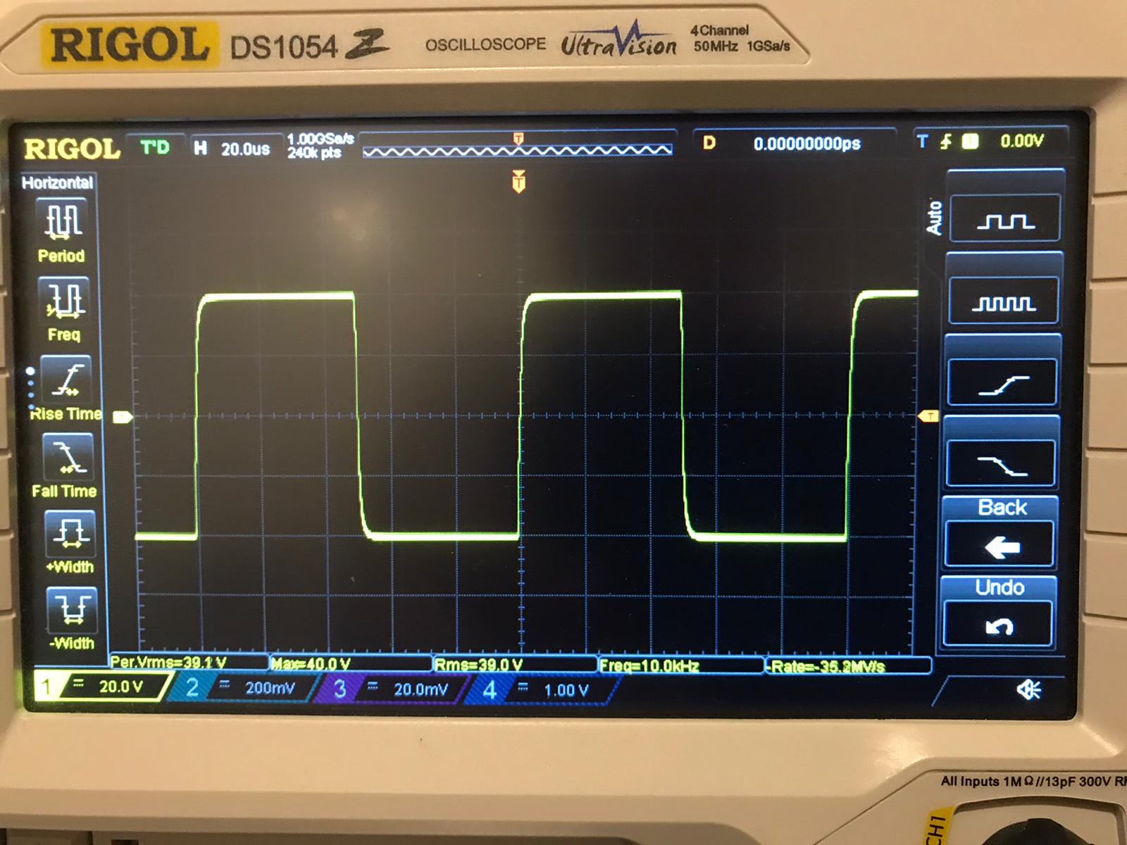

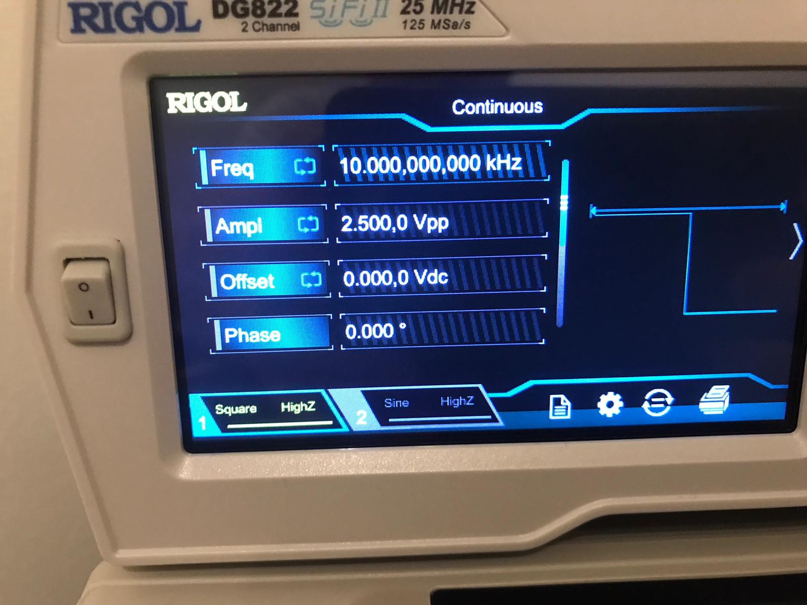

Sure! I've attached two pictures, one of the signal generator settings (2.5Vpp, 10KHz), one of the output measured across an 8 ohm dummy load. Fascinating eh? As fas as I can judge square wave response is excellent.

0.8mV on the input and 0.5V on the O/P - seems the gain is very high. Should a gain of 37x so for 2V pk~pk about 50mV
If you measure across the feedback resistors (R12-R16 in parallel) you should get 540 Ohms and R11 must measure 15 Ohms. Measure also from the junction of R29 and R28 to 0V - should also be 15 Ohms.
