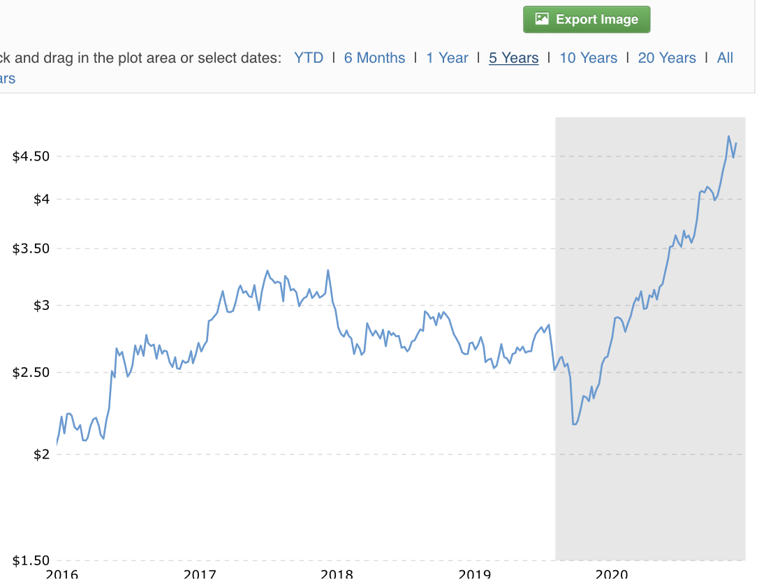

I haven't received a response from Tiger, but Toroidy did work out a quote for me. Just shy of 180 USD and an additional 72 USD for shipping. So inline with the previous quote. Amgis recommended that I contact Bridgeport Magnetics here in the States, so I will send a RFQ later today. Pricey stuff these days!
I will just tell myself that they are using purer copper these days, thus justifying the cost increase. Hehe
Copper prices have soared the last year or so, but I don’t know that this accounts for all of the cost increases folks are seeing on transformers. The prices below will be well below those paid by industrial users if I understand this stuff correctly.
As a comparison, he did quote their standard audio transformer and that was a more palatable 72 USD (excluding shipping). Metals have indeed shot up but that's a huge jump.
Is it the reason that other metal wire used in big transformers?Copper prices have soared the last year or so, but I don’t know that this accounts for all of the cost increases folks are seeing on transformers. The prices below will be well below those paid by industrial users if I understand this stuff correctly.
I see something like aluminium wire in transformers used in ups.
