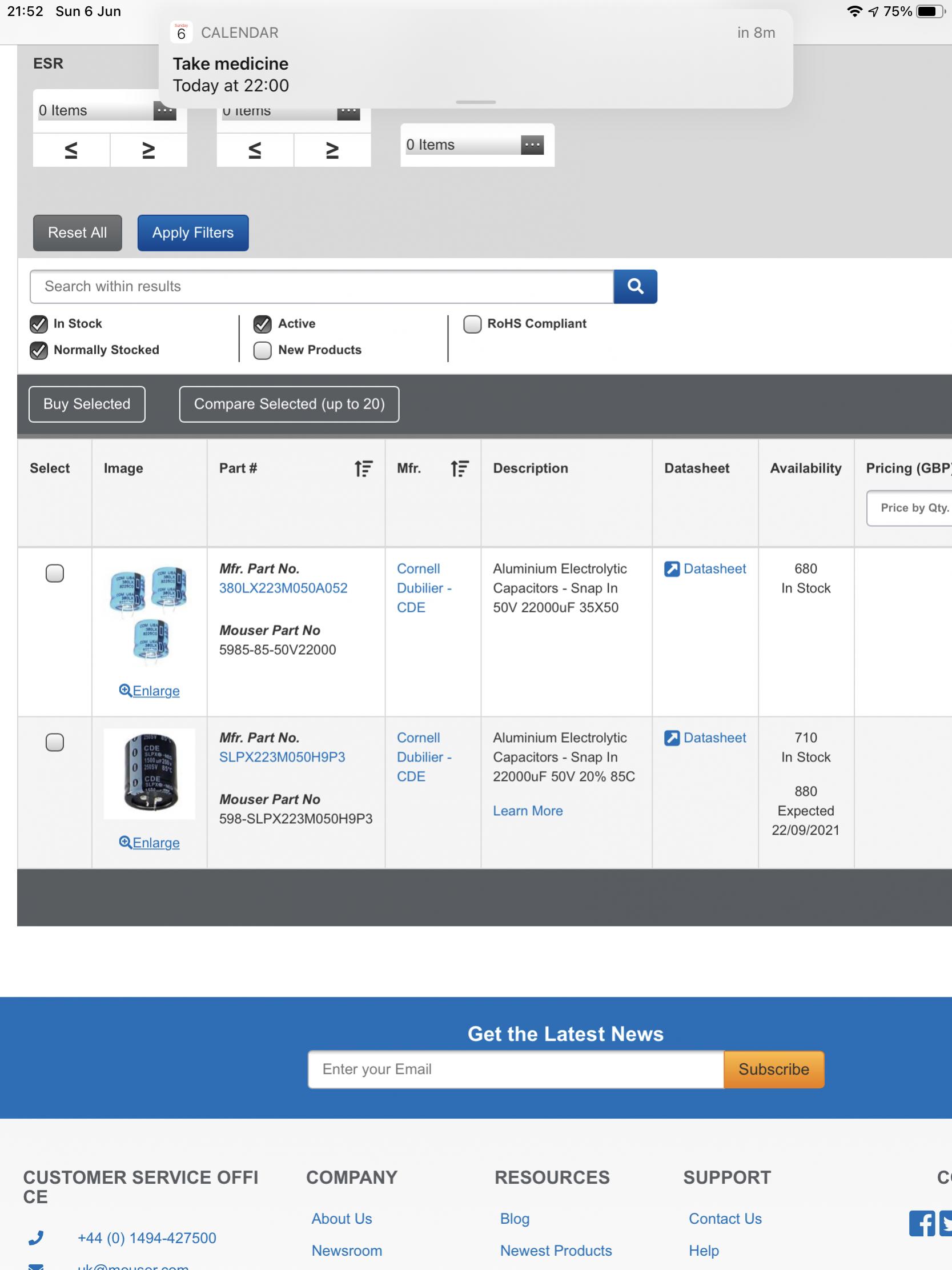

Javier, these two will fit (10 mm pin spacing and 35 mm diameter).
