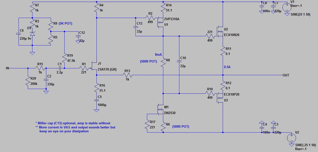

I believe we now have a schematic over on the SS forum, check it out..... this is very slightly different to my schematic, which I will post in a couple of days, but the topology is identical.

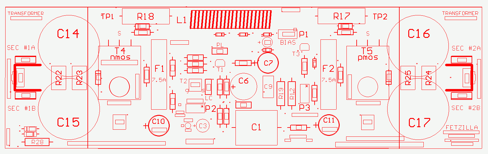

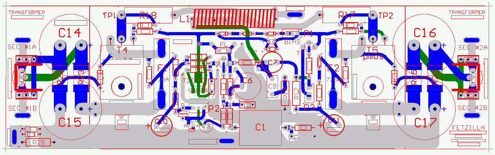

Folks,
Getting very close now, Greg has been sonic testing most of the day. Here is an amended pcb graphic complete with overlay, and a new parts list with correct designations for the pcb (but not yet for the schematic, this will arrive later this week).
Hugh
Hugh

Hi Hugh,
It seems that the part names and values are not corresponding to the schematic in post #163. My guess is that they are corresponding to the final schematic you're going to post.
My another question is the value of C2, is it 220nf silver mica? since it's very difficult to find such a value of silver mica
Thanks,
Thanks,
Hi NCC,
Yes, there is always some fine tuning of the final parts list because these things are not always coordinated. Greg is the schemat man, I am the layout and parts list man. The designations are not perfectly aligned at this stage.
You can use a ceramic 220pF, or a film cap of some sort, but it has to be a small device with 5mm pin spacing.
Thank you for your interest, you are on the list which I will publish again later today.
Hugh
Hugh
