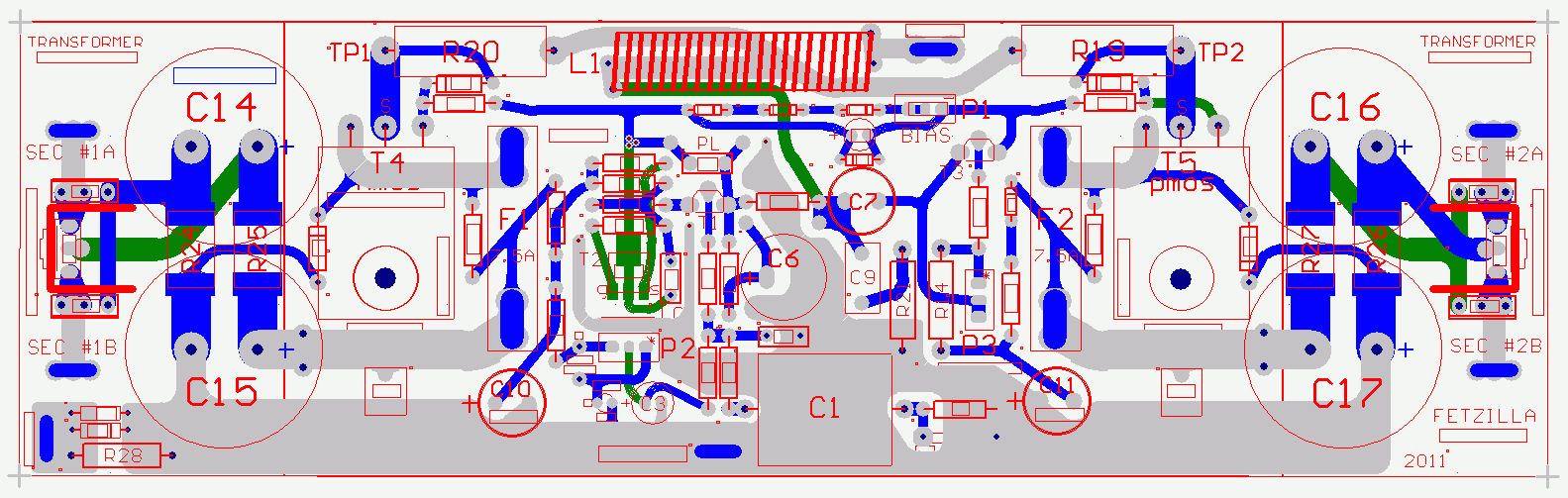

Why Sonnya? We don't want a 7W resistor here, a 5W would be more than sufficient.
Imagine 3.5A peak, that's 2.47A rms, and with 0R15 dissipation is one half of 2.47 squared x 0.15 which is 0.46W. This is continuous, 50W into 8R, absolutely flat strap. So 5W is more than enough as I usually simply triple the worst case!
It's 25mm, should be close enough for government work......

The bodylength of the Ohmite is 23.8/25.8mm and then you need a few mm in each en to bend the wires.
But again, this is if you would like to make space to the ohmite. There is plenty of room for the 3W 13FR150 in your layout at the present state.
Sorry for asking, it was not ment to question your layout. It surely looks good.
It is only to be sure, as i make the same mistake once in a while

Hi Hugh, latest layout looks good. Now where is L1 damping resistor hiding? Under the board?(I hope.) Absolutely agree about the position of the take off point for the feedback.
Steve.

I'm leery of using resistors that are unnecessarily big. In truth a 3W source resistor is quite adequate. There is space there for 5W sandcast as well.
You are right about mistakes; I made my last in 1967, quite a serious one.....

INSIDE the inductor, which accounts for the additional hole left and right at the centerline. It's a very compact way of doing it.
I think we have all bases covered now for the output stage fb take off point, thanks for bringing it up. I wasn't happy with the original either.

D.Self disagrees........ what is important is that the feedback is taken from the midpoint.
I disagree, many disagree.
The NFB tapping point must come off the output trace. It must not be taken off the Re connecting trace.
Midpoint has nothing to do with correct NFB tapping point.
Feeback should be taken after the summing point of both outputs. Whether or not the summing point is centered cannot matter any more then the Vbe diferences and emitter resistor variances, as long as the traces are large enough to carry their loads gracefully. Unless perhaps if EMI is a concern, but probably not?
If the both the output node and NFB are taken at the summing junction, small errors in the junction geometry will cause distortion. However much it matters is anyone's guess, but good practice is good practice. Especially when it holds back a frenzy of correction posts.
Well, it is taken from the centerpoint or should we say starpoint. And as long it is taken from the startpoint where the two resistors meets with the outputcoil it is perfectly ok. I do not expect any degration because of that.
Secondly Hugh has build many wellsounding amps according to the audience so he knows what he is doing.

Aksa has written "midpoint". That is completely irrelevant, no matter what his opinion/reputation/skill/talent/previous products.
read kean's comment.
I also have the textbook. We are talking 10mm offset, in dself book... That is right. then i agree but in the latest layout Hugh has made we are talking 1 - 2mm offset if not less. But you can try calculate the sq.area of both sides of the junction/ summingpoint
A much bigger issue where the ground potential is taken for the Feedback loop. You have much less signal/noise ratio here than at the output.

Guys, let me know what I should be doing, and I will make the changes.

Andrew, any further suggestions? Your earlier one was correct, and I have made the changes, I believe this hits the spot. How did your tests go with and without lag compensation?

It is self defeating to make this amp too small if you are dissipating quite high power from the output devices, which therefore should be reasonably far apart for best heat distribution.
Soft mute may be desirable, but it is not essential. In practice I'm sure the slight thump at turn-on is of little concern. DC sense could easily be accommodated on a separate board, with a suitable relay - go for it!
The idea is to keep it simple, and easy to build and get going.
