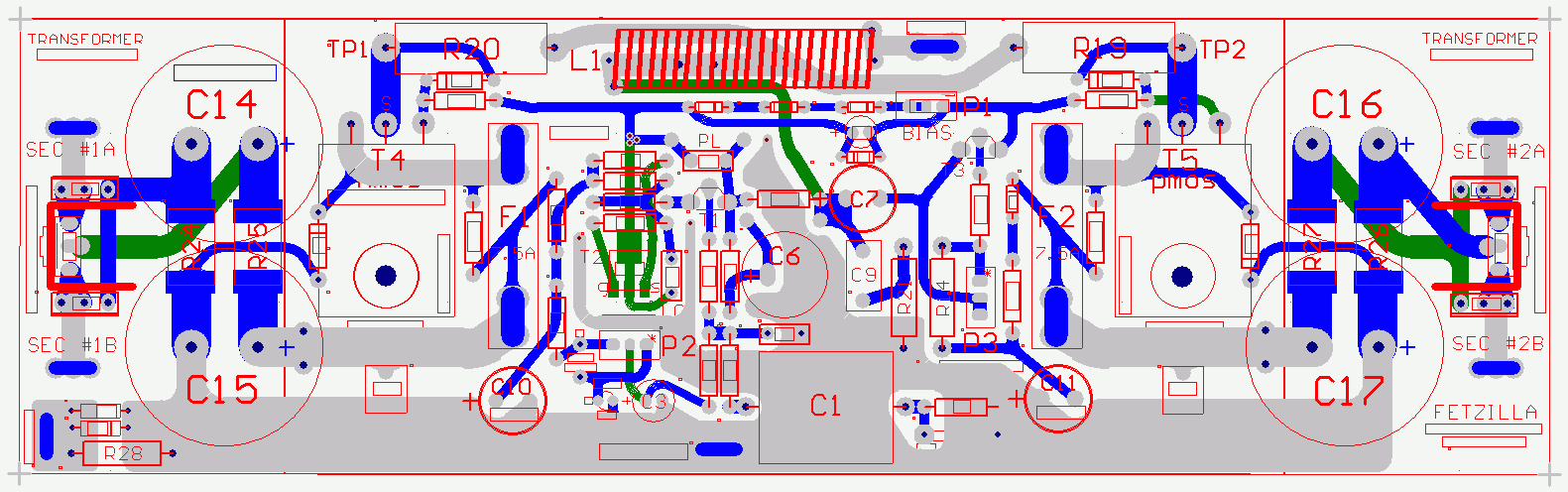

Now, where were we? Attached is the latest pcb.
Hugh

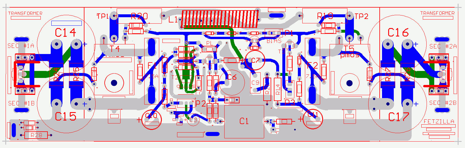

Hugh
Ian Finch has suggested that I take readers through the iterations leading to this latest pcb. Very good idea; the two threads are long, and exhausting.
Here are the design approaches of Greg Peters, Mikelm and myself so far. I would point out this has all been the original brainchild of Lineout, the redoutable northern Swede who while he lives in one of the coldest places on the planet has an almost feverish, active mind.
#1 1st stage: singleton input device. After much discussion and a few trials, Greg has opted for a jfet, as this gives very low transconductance, around 20mS, and this keeps loop gain low which seems important to the good sound of this amplifier despite higher THD figures.
#2 IIRC Lineout's original design called for a single ended input and VAS with complementary push pull output stage using DC coupling throughout. Essentially this meant eliminating the feedback shunt cap, a 1000uF beast that Mikelm in particular disliked. The problem is that offset control without a servo - which adds complexity and detracts from the circuit simplicity - is very poor with DC coupling as DC gain is no longer unity, but the reciprocal of the gain. In amp design the DC offset control is not a trivial design problem, as it has the potential (literally!) to destroy speakers if poor. Accordingly, Greg has chosen to continue with AC coupling, so back in goes the cap, and DC offset is now very good. I endorse this choice strongly.
#3 Lineout originally chose the IRFP9610 p mosfet as VAS. Briefly the advantages of a bipolar device such as the 2SA1360 were mooted, but Greg noticed, and Andrew confirmed, that a mosfet VAS required no Miller capacitance for rock solid stability. It also gave a more 'lively' sound with palpable vitality. I went looking for a better mosfet VAS, one with a lower current rating to improve its linearity at very low drain currents, typically around 12mA in this application. Greg had suggested the Zetex ZVP3110A, but it's only a TO92 and limited to 740mW. In this application, and with the original 20mA VAS current selected, this gave very high dissipation, too high, so I felt the 2W smd Zetex ZVP2110G would be superior as it was essentially the same chip in a SOT223 high power package. Eventually we decided that since the Ciss of each output device gate was bootstrapped, 20mA of VAS current was not needed, and ultimately we've settled on just less than 12mA, a good compromise.
#4 Originally Lineout had selected a bootstrap CCS for the VAS, but this seemed to detract from the bass response of the amp, though it does sound very good on vocals. Paul Bysouth, a clever Melbourne engineer and good friend, suggested using the Supertex DN2530 as a CCS/bootstrap hybrid in an attempt to get the best of both worlds - good bass, and engaging vocals. The jury is still out on this clever modification, but it's incorporated into the pcb as T3 and on Monday Greg will be able to tell us how it sounds.
#5 I decided to offer a pcb as a means of getting Aspen's name out there, and thought it might be convenient to put independent power supplies for each rail directly onto the amp pcb. These power supplies use ultra fast soft recovery diodes and RC decoupling between the two filter caps on each rail; this adds some refinement to the sound quality. Since Greg had also found that it sounded better at 300mA than 100mA quiescent, and better again at 1A, I felt that appreciable distance between the output devices was required so that we could install the board directly onto a longish 0.42C/W heatsink. The Fetzilla board is therefore 230mm long and only 69mm deep, with 120mm between the outputs, and this gives useful options to set quiescent current nominally at 500mA with 36V rails, or 1A with 24V rails in cooler climates than Oz, all with a simple convection heatsink and no fans.
#6 Every precaution is taken in the board layout to ensure unconditional stability. This includes loading the amplifier with electrostatic speakers, known to be very difficult loads. Phase margin is high, and unity gain loop frequency is just over 700KHz. There is considerable ground plane, and some separation of input/VAS stages and output. An output Zobel, inductor and parallel damping resistor is fitted to the pcb, and the bias generator is range limited by a 4.7V zener diode to prevent overcurrent blowups. There is also provision for experimentation with lag compensation (Miller cap) and phase lead (the JLH feature), making this design highly suited to a novice learning the ropes of audio amp design.
#7 I have suggested polarising both signal coupling caps, at the input and the fb shunt positions. This approach improves sound quality hugely, particularly if the polarising voltage is greater than the peak AC voltage passing through the cap. Accordingly, the input gate is set at around 2.5V positive to achieve the necessary zero output offset.
#8 This circuit is deliberately low loop gain (around 30dB), and very simple, using only one type of semiconductor, ALL of them FETS. This should draw considerable interest, as it appeals to many to own an amp which is designed for a different style of semiconductor. Most are bipolar.
The pcb is 70um copper, two sides, 2mm FR4, overlay both sides and soldermasked. I will attach the smd VAS prior to despatch.
I have attached the parts list for this amplifier as a Word file.
