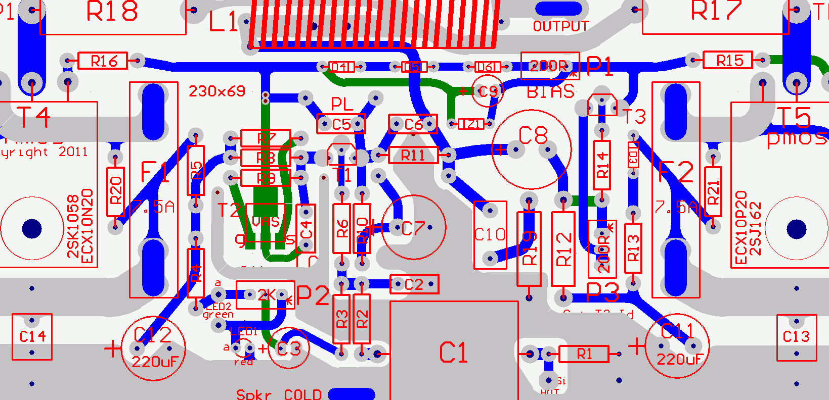

Hugh,
Caps C11 and C12 have different values on your silkscreen, 100uF vs 220uF on schematics.
George
George

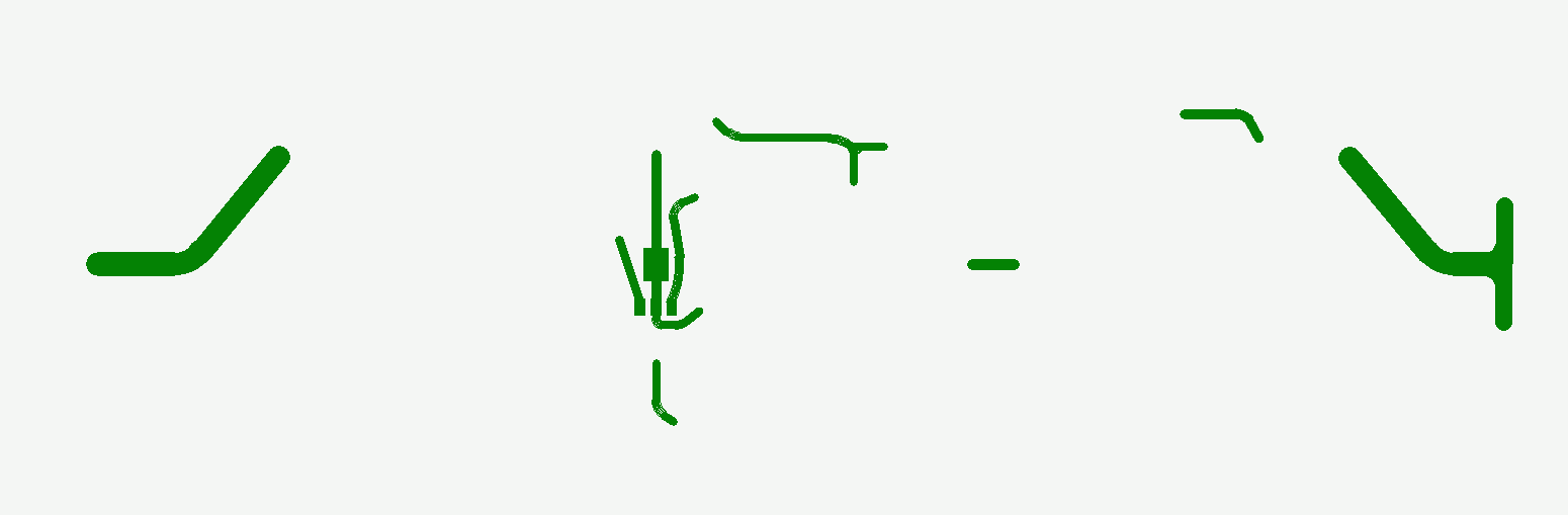

I have attached:
#1 Parts list for ONE module, double for both

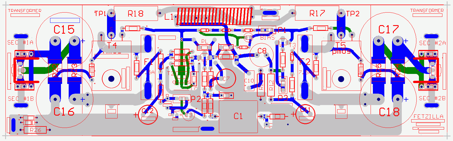

#2 Composite pcb layout gif showing latest changes.

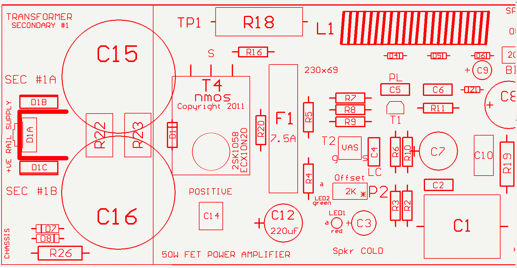

#3 Pcb overlay LEFT side

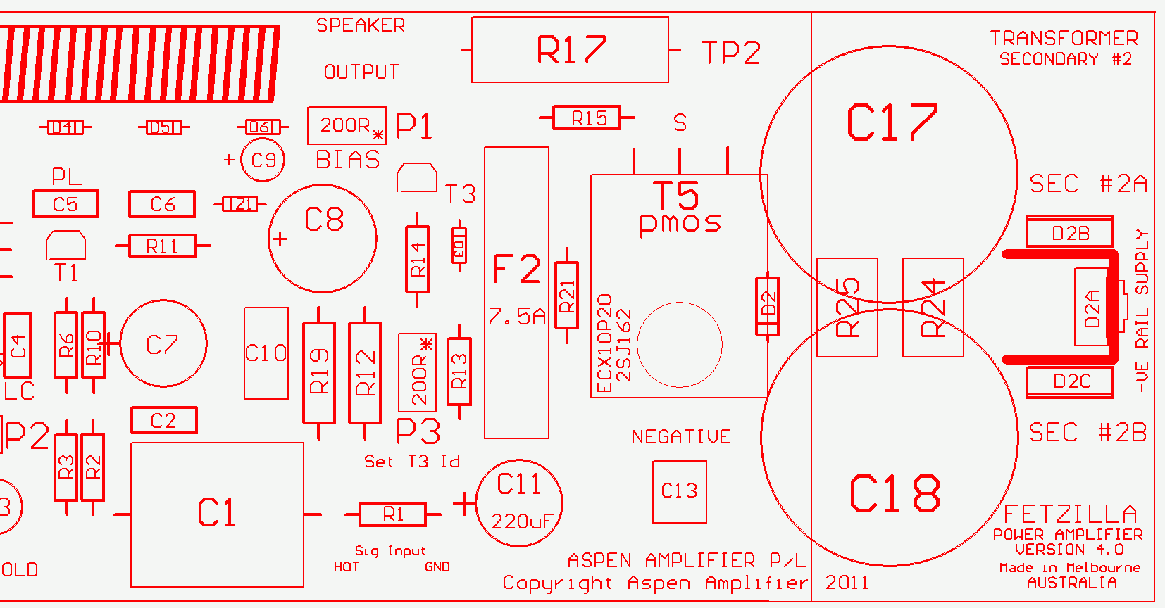

#4 Pcb overlay RIGHT side

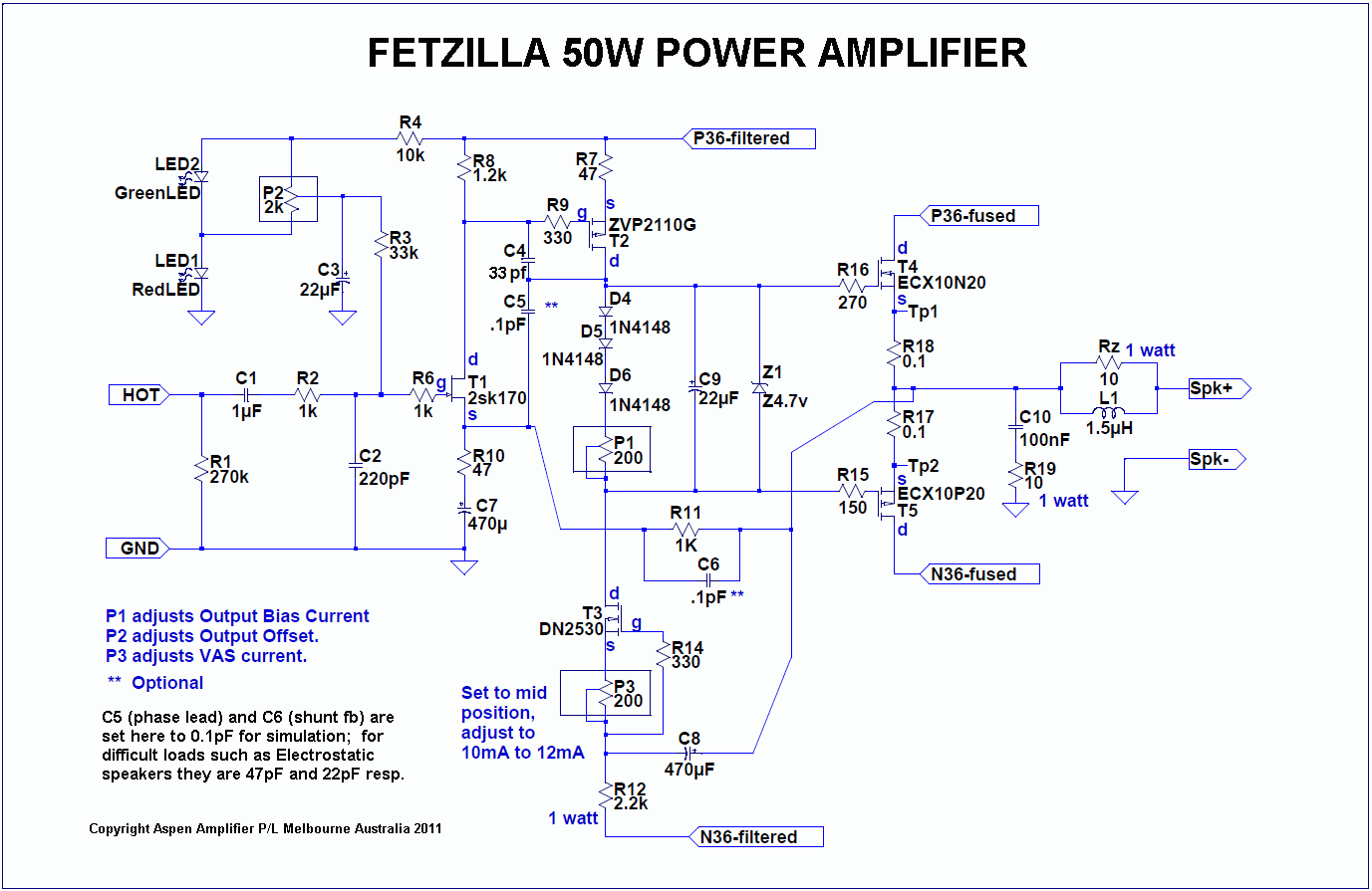

#5 Fetzilla circuit schematic

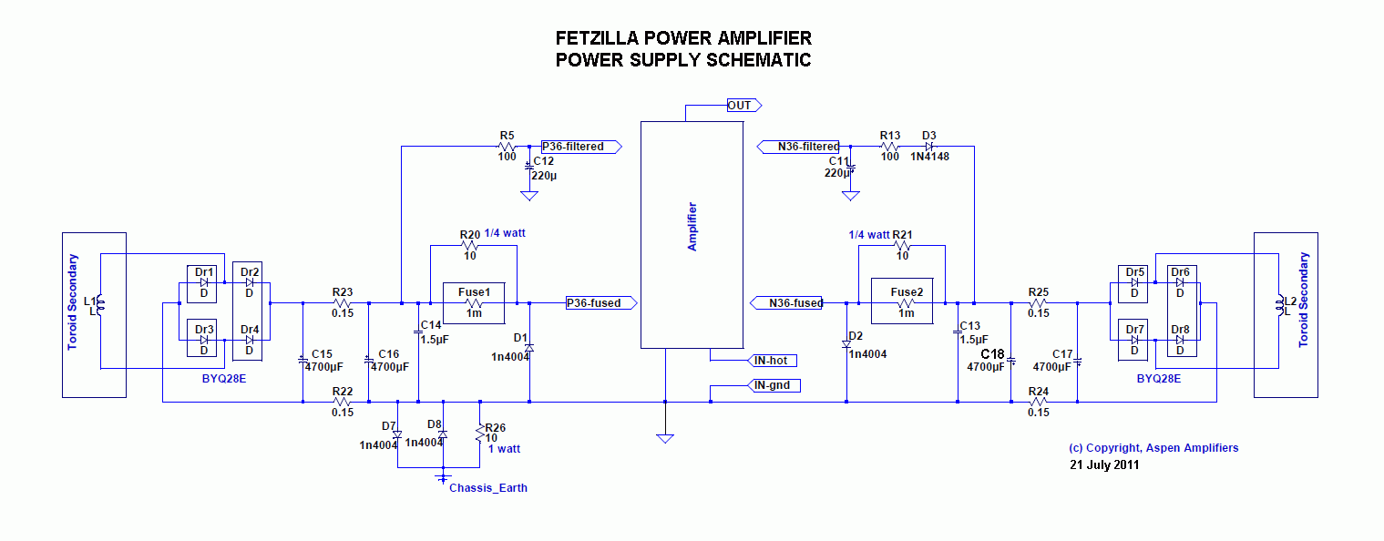

#6 Fetzilla power supply schematic

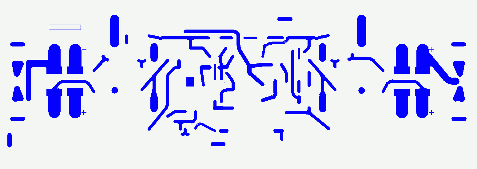

#7 Bottom foil layer of pcb
#8 Top foil layer of pcb
This is the latest edition, updated 22nd July 2011, and it incorporates all changes to this point.
Hugh,
Please correct polarity of C17 and C18 on schematics.
George
DONE HRD
George
DONE HRD

Hugh,
Did you change values of R17 and R18 from 0.1ohm to o.15ohm? If yes, then you should correct schematics.
George
George
Hugh,
Could you please make provision for bigger C13 and C14 caps on the PCB. There is only 5mm lead spacing on the board but most of the caps above 1uF have lead spacing between 15mm and 25mm. There is plenty of room on the board to accommodate bigger caps at this location. Thank you.
George
George
Hi Hugh,
Put me down for two boards please.
Are D1/T4, D2/T5 a little close to each other? Opposite sides of the board - but I can't see how generous your footprint for T4/T5 is in practice.
Jonathan.
Jonathan.
Hi Jonathan,
Thank you for you post - the components you mention are indeed on opposite sides, and the pcb has two 3/8" x 1/8" washers each of 0.8mm thickness raising it above the top of the output device. This places the solder joints under the pcb a good distance above the output devices. I have used this technique on commercial amps for some years and it NEVER causes difficulties.
You are on the list, along with Halcon83 and John Hambek!
George, corrections made.
Steve, the 2SK1058/2SJ162 can be used without any problem; just about any lateral fet with 8A, 160V and 100W will do the job fine. These devices are not particularly critical, the most critical are the smaller fets in the circuit.
I have attached all relevant files which match those presented on the other thread. They are dated 22nd July 2011.
Hugh
Hugh
Hugh,
Thanks for the changes. So far I didn't find any mistakes in your new documentation. It will be nice if you can mark components that you will be providing along with PCB orders on the part list. This way we can avoid double ordering.
George
George
Shucks, Jon, thank you!
George,
Can't tell you how relieved I am! Parts supplied now noted on the document.
Hugh
George,
Hugh
Hugh,
Looking at the earlier posts, the SOT223 package has been chosen to allow higher dissipation in the VAS. I have not done the sums on the dissipation but the current layout might not allow much leeway to utilise the dissipation allowed by the device.
Designs I have done using these types of SM packages have relied on significant copper lands being placed to achieve the degree of heatsinking required, the package alone is often insufficient. The ZVP2110 datasheet is not very helpful here.
See http://www.fairchildsemi.com/an/AN/AN-1028.pdf
For example, swapping T2 and R7,8,9 and filling a copper area towards R16/D4 would improve things. You may of course be fine as it is - best to check 🙂
Jonathan.
Jonathan.
Of course I have done the homework here, c'mon, have some faith!
The dissipation of the device is 430mW. Rating (max) of the device is 2W.
This is less than one fifth of the max. The lands specified are 20% oversize on the recommendations for the SOT223 package, and they are duplicated for the larger drain pad on the reverse side and connected thermally by two vias besides.
You will also notice hugely oversized pads for the TO92 devices as well. Again, overkill.
This thing will be better cooled than a nuclear reactor.....
Hugh
Hugh
