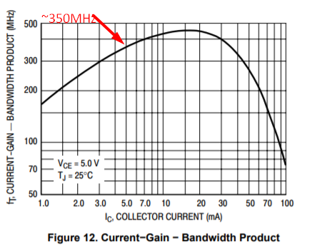

For the MPSA18, FT=350MHz, so in that case CPI= ~90pF and C_IN = CPI/2 = 45pF. (I screwed this up too since I said x2 and /2).

The MPSA18 doesn't have Ft specified at 5mA so I will stop using it as an example.
For the BC550C, Ft is 340MHz at 5mA. Cje=87pF. So 170R+820R and 87pF/2=43pF gives a pole frequency in the open loop response of 3.7MHz.
Yes it does. See attached screenshot.
