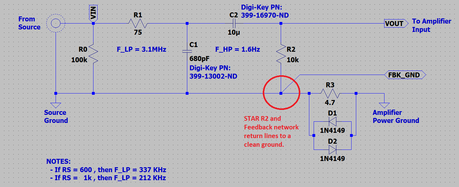

Hi Shaun, as you mention high speed and precision grounding demand totally approaches. For audio, the former is totally out of scope given the frequencies we are dealing with. Besides the basics, I am no expert on ultra high speed design. The highest speed design I did was ~1Ghz, a high speed ADC driver. But yes, ground planes are common practice in high speed design.
Surprisingly (or maybe not) audio and precision applications share a lot in common. Mostly because distortion is nothing more than non-linear, signal dependent off-sets, and noise is a random time-varying offset. Grounding is no exception.
For audio amplifiers, the things I think about are as follows:
1. What are signals referred to
You always want signals that related to be referenced to the same ground. For example, in my previous post I mentioned that you want the DC defining resistor at the non-inverting input of the amplifier and the feedback network to be referenced to same ground, and their connections to be starred to it. This way ground noise becomes common mode and rejected by the amplifier's CMRR.
2. Which grounds are clean (namely the signal grounds) and which ones will exhibit ground bounces (power grounds).
In audio power amplifiers, the power supply and the speaker return line will inject large currents to the ground, hence that ground will exhibit substantial ground bounce. As you mention, this is our power ground. The ground coming from the source in the connector should be a clean signal ground. If ground bounce gets into the signal circuit, it will show at the output as either distortion, pops, hum, etc.
If we follow the suggestion from 1, technically ground bounce should not be an issue, but as Federico pointed out, it is a good idea to connect your inputs to the clean ground to give you a further safety net (maybe we have an amp with bad CMRR).
3. Where are currents being returned
The ones to watch out are large power currents from the supply and the speaker return line which have substantial noise. You really don't want these to return to the source via the input jack since you will forming a ground loop. This is bad because for one you are creating a loop antenna which will induce pickup, and for two, through mutual inductance you are coupling the noisy current into your input line. To fix this, we add the 4.7 ohm decoupling resistor between the source (signal) and the power ground.
Finally, since we are dealing with a single ended system, all lines to the power ground should be starred (including the signal ground through the 4.7 ohm resistor) to provide a common reference point. This is because the amplifier output is actually also referred to the signal ground since we have a single ended output, but because of 3, we cannot connect the speaker return line to the signal ground. So starring is the next best thing to keep all the references common.
Anyway, this post ended up being longer than I thought, but I hope it puts out some key ideas regarding grounding. Regarding the circuit, I am going to keep it as in v2, with a reminder that the feedback network needs to star to resistor R2 ground connection.
Best, Sandro
Quick update: V2 is of the schematic is the way to go.
Quick update:
I just realized I made a terrible mistake in one of my comments above :guilty:.
Tying the input resistor R2 and the feedback network to the same reference WILL NOT reject the ground noise, it will only reduce its gain to 1 (rather than get amplified by the closed loop gain). I am really sorry for stating non-sense. My mind was on 4 resistor subtractors where this is the case.
In any case, we do want want to do the following:
- Tie resistor R2 and feedback network return points together to a clean ground to minimize ground noise gain (reduce it to unity).
- Separate amplifier power ground from signal ground with a decoupling resistor.
- Star power ground as much as possible.
Sorry again for the misinformation.
Best, Sandro

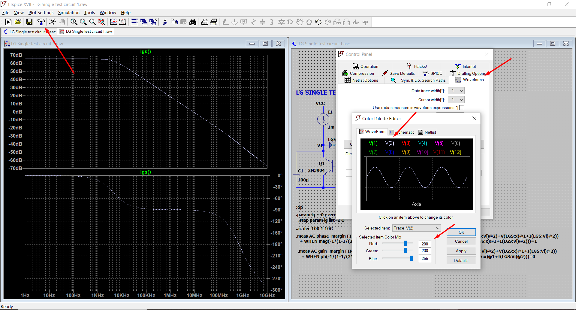

Hi Gannaji, you are right, that blue color is difficult to work with.
Here is a solution (see the attached image):
+ Click the hammer button on the toolbar and select the 'Waveforms' tab
+ Click on color scheme
+ Change the color scheme of V(2) by either:
- Swapping the blue of V(2) with the Greenish/Yellowish of V(12) by dialing the RED, GREEN, BLUE numbers. I.e. Change V(2) to R:175, G:175, B:0 and V(12) to R:0, G:0, B:255).
- OR -
- Changing V(2) to a new color. I am going with this route for now and setting V(2) to R:200, G:200, B:255. Its a purplish white which is more visible. [See image]
+Click OK.
That should do it.
Let me know if you have other questions.
Best, Sandro

Just change background color to white.
BR Damir

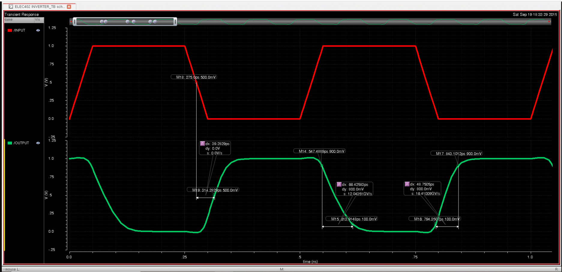

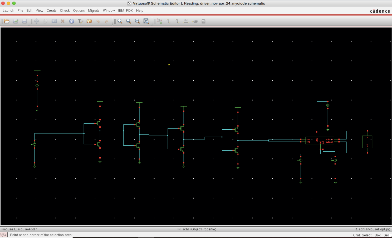

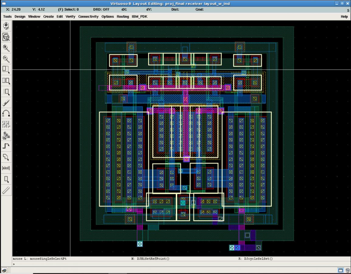

Hi Damir, when you are looking at schematics and plots all day day on a screen, looking at a white background will tire your eyes. White paper is fine because unlike a screen, paper does not produce light, it simply reflects it and is less tiring on your eyes.
Also, I think the black background, given the elevated contrast, allows you to pick small details better. For example, if you miss-wired something, you can see it faster on a black background, or if you see a blip in a plot (blip being whatever you want).
The attached screenshot is of the Cadence design suite which is pretty much used by everyone is industry. Note the black backgrounds on schematics, plots and layouts.
Interestingly, even though the schematics, plots and layouts are on a black screen, everything was printed with white backgrounds (save toner).
PS. The schematic and plot are Cadence 6, the layout is Cadence 5.

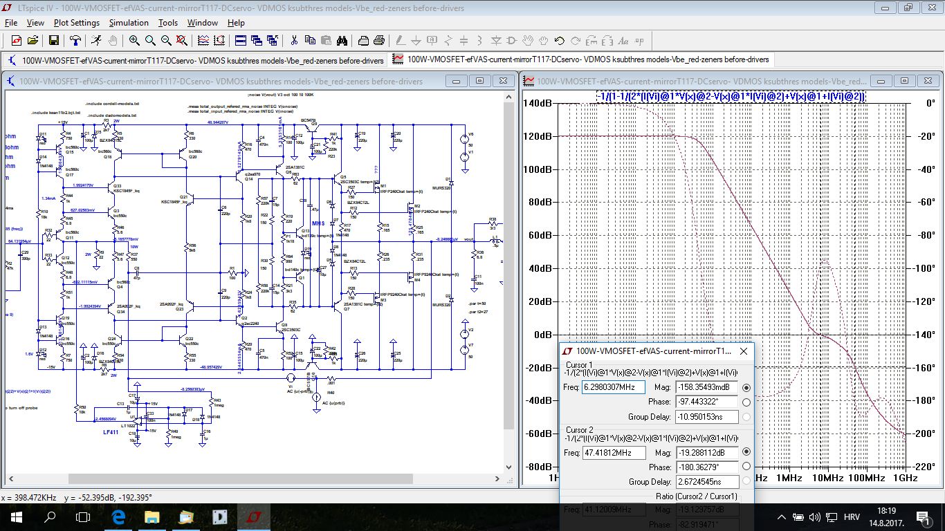

I just looked you video 3.2 and I liked it very much, but still blue LG plot on black background is almost invisible, I prefer like this.
Damir
:up: you are right. I think I am going to try to change the background of plots to something like the background color of schematics. That tombstone grey.

Oh well. I have used the grey background now for a couple days, I like it enough to keep it. Thanks for the pointer.
