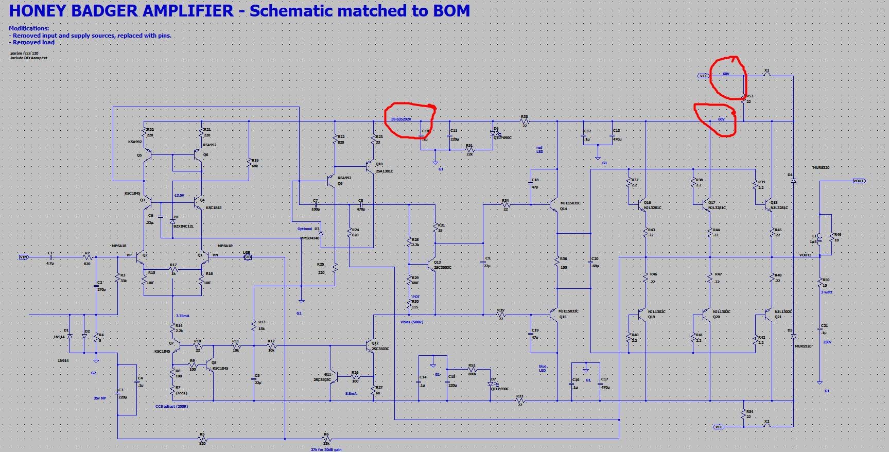

Hi Sandro,
I have your sim environment running. Couple of observations, it might because of my lack of ltspice knowledge, so will ask for clarification.
1) I see you have ".include DIYAamp.txt" but you did not provide this file. I made a dummy file using that name to get the sim to run. But wonder what is in the file, what it is used for?
2) When I run the ".op" sim, I went to the amp schematic, I usually place the cursor over a net and LMB click on the net to display the important voltages for display that I want to observe. When I select on the right side of R22, I get the supply V displayed properly, but when I try to display the V for the left side of R22 I get "???". So it seems it will only display nets connected directly to the symbol in the hierarchy. I am wondering if you know why that is and if there is a means to correct this behavior?

1) Sorry for not including the file, my mistake. This is Oz's models file for the Honeybadger amplifier. I am attaching now. I grabbed it from the HoneyBadger thread as well as the schematic... so it is original 🙂.
2) I just tried it and I did not get that behavior. See the attached image. I can click any node on the the HB amp and get the voltages. These are the steps I did:
- Run simulation from HoneyBadgerTestBench.asc
- After the simulation was done, double clicked on the amp symbol to open the HB schematic
- Poked voltages in the HB schematic
See if that works.

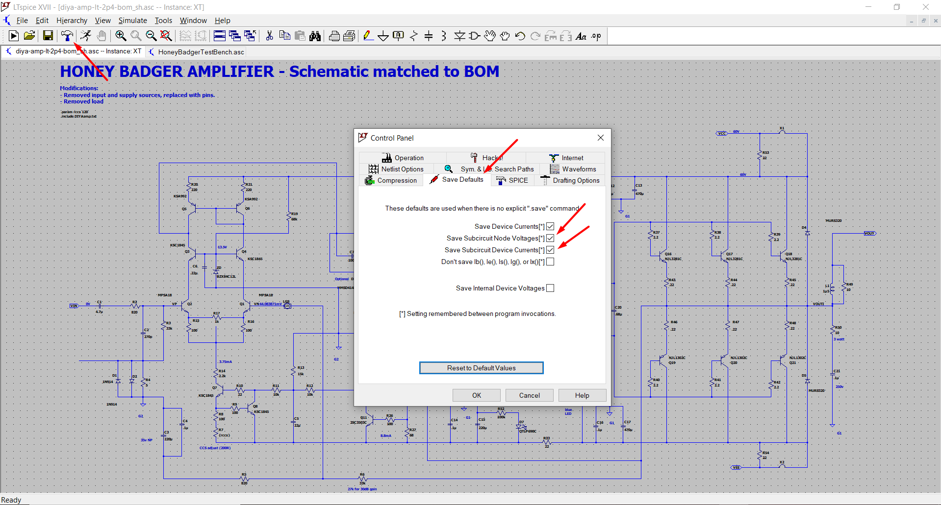

Hi all, I got a great PM from Rick Savas, and I wanted to share it with everyone:
Hi Sandro,

Hi Rick, I think I know what is going on. You need to tell LTSpice to store the voltages and currents in the sub-circuits. It is in the "Save Defaults" on the LTSpice control panel. See attached Screen shot.
I am not sure what the default is, but this should fix the problem.
Best, Sandro
You got it Sandro,
I am an ltspice amateur, it shows 🙂 I was wonder why the log was so short of the usual long list of data 🙂
Funny how the two versions behave differently, adds to the confusion 🙂
I am going to have to beat your fantastically free ltspice lessons (eLearning) into my old brain 🙂 practice makes perfect ...

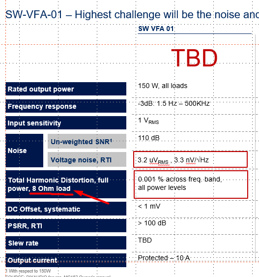

Hello Sandrohv.
>>THD: 0.001% worst case, 20KHz, max output power
A question you included a spec on THD shown above what is the ohm load, may I propose 2 ohm as good goal if thats possible.

I believe I said 8 ohms. See picture.
I will try with 2 ohms too, but remember that for 2 ohms output swing will go down if we want to keep output power constant. 150W into 8 ohms is 34.6VRMS and 150W into 2 ohms is 17.3VRMS.
Now if you are asking for full swing at 2 ohms, that would be 34.6V^2/2ohms = 600W. My amp won't be able to withstand that without blowing up the output devices. So not in scope 🙂.
EDIT: I just saw where you got it from, post #1. Fixed it just now to say 8ohms. Thanks!

My mistake I did not read the spec completely. I think 17.3VRMS into 2 ohms would be a good test to achieve 0.001% THD 20Khz also.

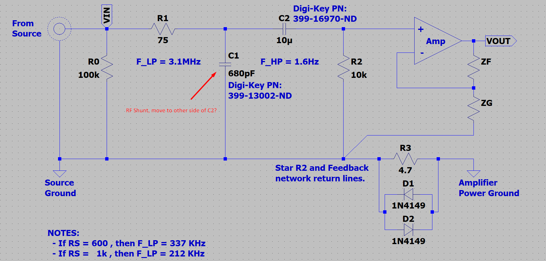

Keantoken commented the following for video 2.2 - Designing the input network, so wanted to share and continue the conversation here:
"Another thing is that the LTP input needs a RF shunt as high source impedances directly alter the LTP Gm and make stability interact with the source impedance. Since this is also a large part of the reason for the phase lead cap, it makes sense to make the input shunt cap >CLG*phaselead. So if your phase lead is 10pF and your amp has a gain of 30, then you want >300pF input shunt capacitance. I like finding little gems of reasoning like this."
@Keantoken:
Isn't the 680pF providing the RF shunt? At High Freq, the 10u is a short so the 680pF will be shunting the input of the amp to ground (i.e. shunting R2). What I could do is move the 680pF to the other side of the 10u cap if you are worried that the ESR/ESL of the 10u will be decoupling the 680pF and amp's input at HF.
Also, can you please explain the logic for the shunt cap being > CLG * phase lead cap value?
I understand the phase lead cap is to shunt the RF resistor to get a zero at High Freq for stability. What I don't follow is how it relates to the RF shunt and the relationship C RF shunt > CLG * phase lead cap came about. (CLG = closed loop gain for those who don't know the acronym)
Attached is the latest schematic of the amp.
Thanks for the input Keantoken,
- Sandro
@Keantoken:
- Sandro
I was meaning more generally in terms of how to think about the value you want for that cap. What if you don't want a LP filter? Well you still need a shunt cap for stability so this gives you an idea what value you might want to pick. The 680p does the job fine.
Most people seem to assume that phase lead is the phase lead cap's only function but it is good to check whether something is doing what you think it is doing. If you do that, especially with slow input transistors you may find the feedback network is not having the expected frequency response. This is because the phase lead cap is not just supplying current for the feedback shunt resistor but also supplying the transistor input capacitance. And the larger input capacitance is the differential capacitance between LTP inputs. Thus since this capacitance and the phase lead cap share current, voltage drop across the diff capacitance will be reflected in the voltage across the phase lead capacitance (or worse, the lack thereof), which manifests as an effective pole or shelf response in the LTP Gm. Thus you often end up needing a phase lead cap NOT because you need extra phase for the VAS or output, but because nothing is charging the LTP diff capacitance and that is causing a pole and associated mayhem.
The same applies to source impedance at the input side. But the phase lead cap is magnified by Miller effect, so to have the equivalent effect on the input side your source capacitance (provided by the input shunt cap) needs to match the effective miller capacitance. Thus multiply the phase lead cap by the closed loop gain and take that as the ballpark value for the input shunt cap.
Note that opamps can use custom input transistors or Darlingtons whereas most amp designs just have a simple LTP with general purpose transistors which will have much much lower input impedance than an opamp input. This is a major factor that leads to many of the differences between discrete amps, power amps, and opamp designs.
